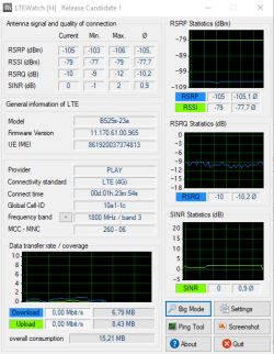

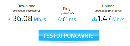

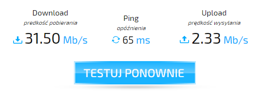

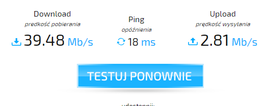

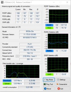

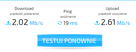

    Check the LTe2600, LTE2100, LTE1800 bands one by one by forcing the HManager or LTEwatchH on the B525, of course the antenna is set to the BTS. You show screenshots from HManagera / LTEWatchH and DL / UK speed tests on each. on B525 you will only use LTE2600 + 1800 aggregation (we do not take LTE800 into account), after band tests, at the end you force two bands simultaneously, i.e. LTE2600 and LTE1800, aggregation shows as LTE + and works during active data transmission, e.g. speed test.

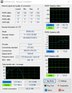

  • #8 17797752

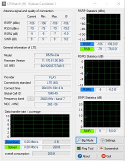

    dzik211
    Posts: 18
    lte 2600
    Enabling 2 Band Aggregation on B525: Step-by-Step Guide & Troubleshooting Tips
    lte 2100
    lte 1800
    I don't know why lte 1800 and 2100 combine with bad bts. lte 2600 is combined with good.
    Added after 15 [minutes]:
    lte 2600 +1 800

    And which BTS is the antenna set to, on Warszawska 1 or Zakolejowa 23? These are BTSs from across town, what's your location? signal parameters very poor on all bands. The railroad overloaded on these two bands, LTE2600 from Warszawska works fine despite the weak signal

    On LTEwatchH you will not force a specific aggregation, you will not check whether LTE2600 + 1800 is on, LTE + is displayed in Hmanager if it works .. Set the antenna more to the right so that it does not catch the signal from Zakolejowa.
