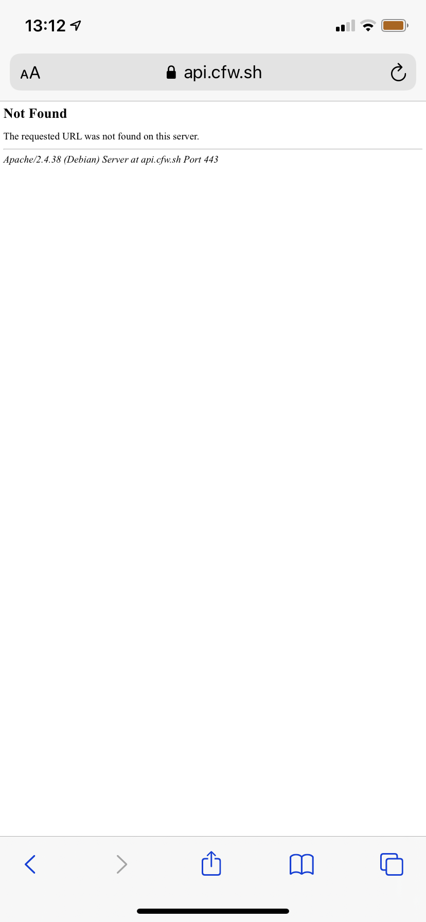

    The problem is that it would probably be possible to upload soft to DownG (this modding application) but unfortunately whenever we download soft from e.g. emkowo.pl an error pops up ... confused. However, there is an option (probably) that if someone still has this file downloaded and would like to separate it, I would be very thankful .... I hope it works like this, if not correct me. I count on the opinions of people who know something about it, so that I do not get involved in something that may turn out to be withdrawn, for example a year ago, but I did not know about it

    You have a lot of firmware generators on the internet. Look for and choose. Just be careful - these xiaomek were probably 5 and their firmware is incompatible. Equipment can be easily released.
  • #3 19445235
    Adamoo7777777
    These generators ALL crash an error after clicking the generate button, so there are a lot of them, nothing gives as each crashes the error NOT found 404
    Also, a counter that someone who reads it will share a file that once, for example, in 2019 used for his scooter

    As far as I know, at some point Xiaomi blocked the possibility of picking in the FW.

    Yes, but you can downgrade it with an external programmer.

    #7 20053972
    Pontikos
    Posts: 4554
    Help: 321
    Rate: 1007
    Why do you need "screenshots", a comic you will do? Xd Just write three numbers.
    In the BLE version from 158 upwards, only the factory software can be uploaded.
    You can downgrade BLE, but only with the hardware method, ST-LINK.
    There are actually a lot of generators, still working, there is even one paid one, which generates a soft "proprietary" one for BLE above 158.
    I do not provide links on purpose
    a) not to distribute commercial content
    b) I do not know if such "enabling" is currently legal
