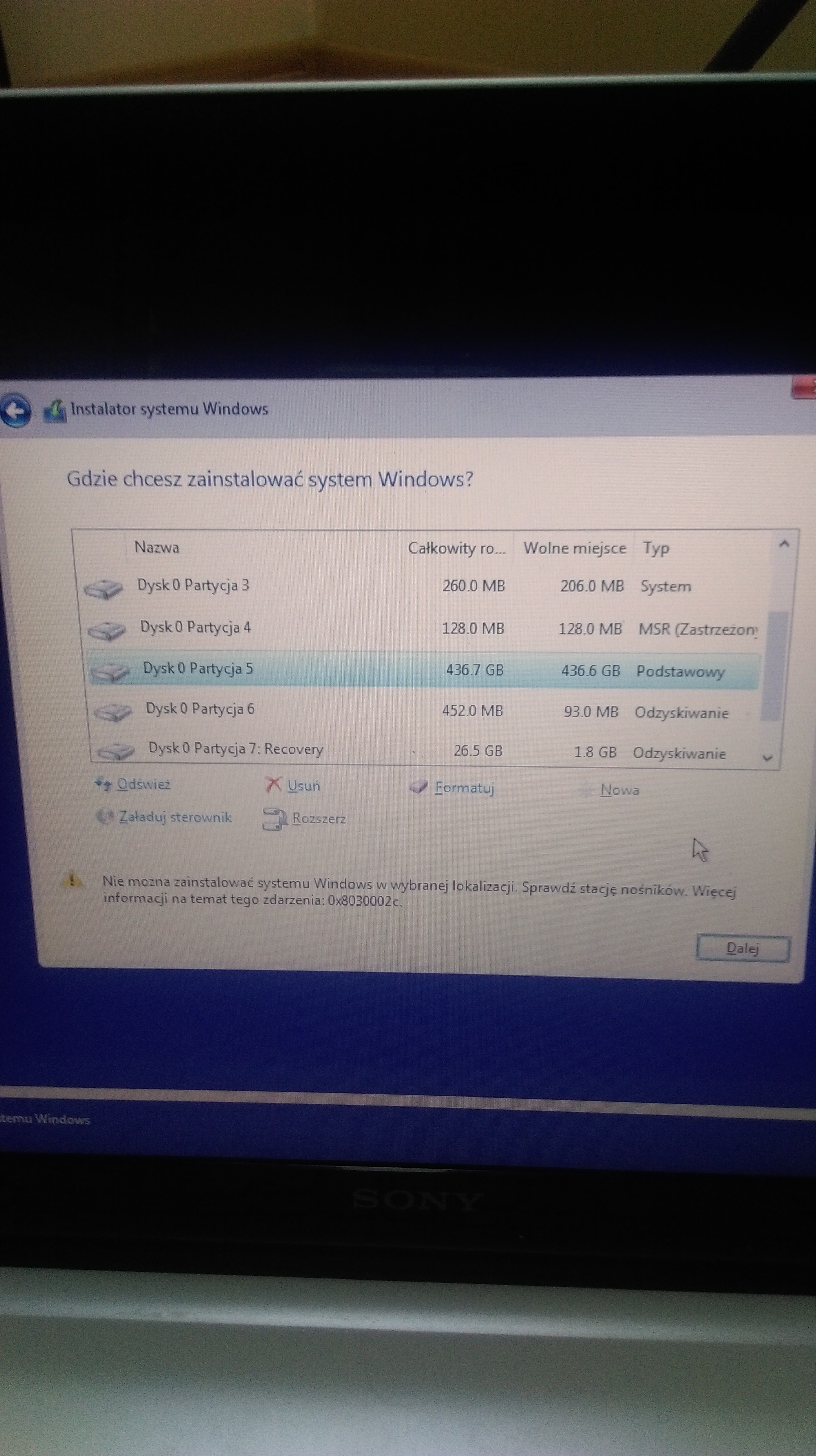

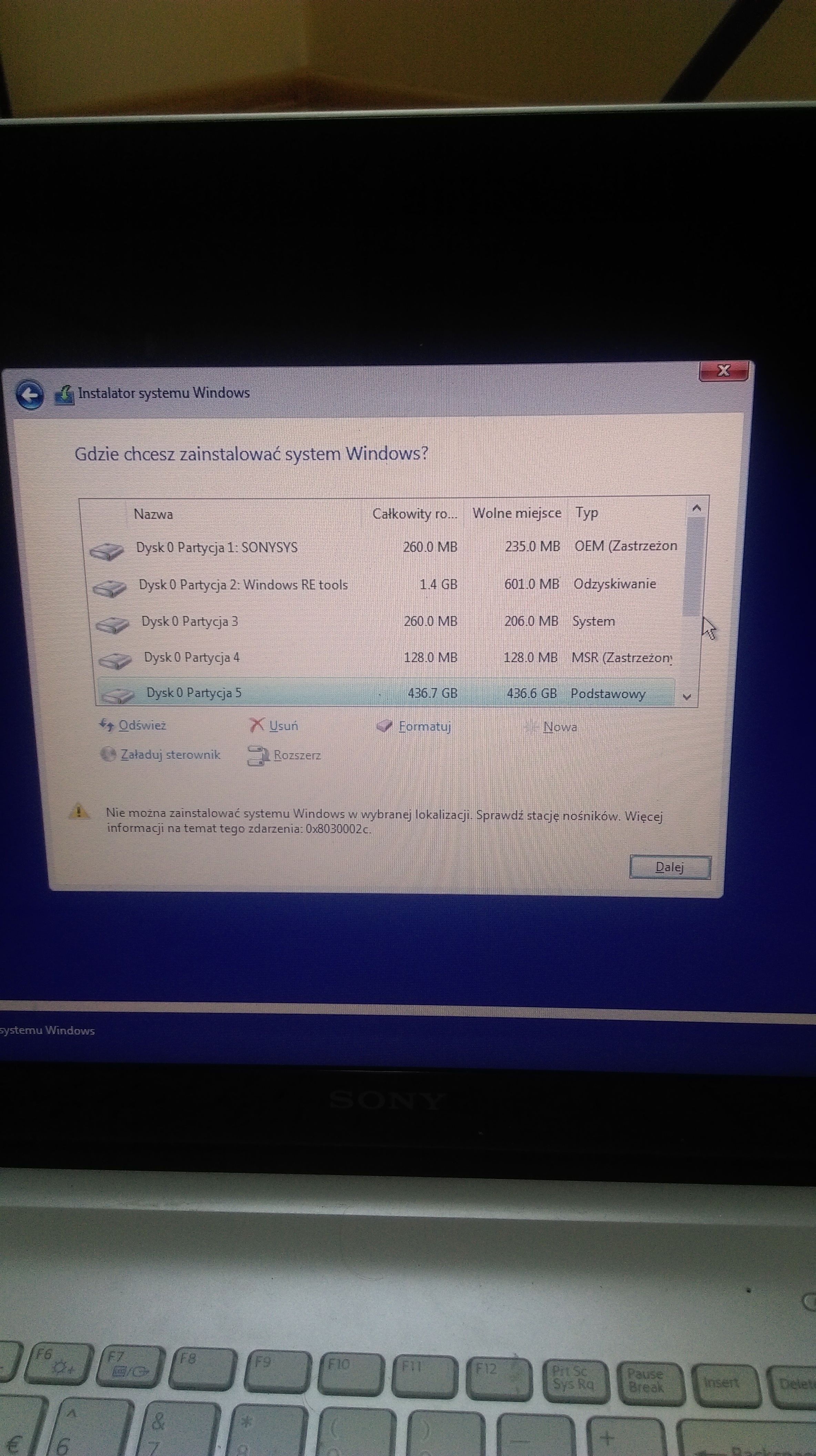

    When you try to install the system, the message appears "The partitions on the disk selected for installation are not ordered in a proper way. GPT.
    Partitions with the system have already been formatted, so it is not possible to enter the system ...
    • Unable to Install Windows 10 Due to Misordered Partitions on GPT Formatted Disk 1502900822022-1966123684.jpg (3.01 MB) You must be logged in to download this attachment.
    • Unable to Install Windows 10 Due to Misordered Partitions on GPT Formatted Disk 15029008114581158308992.jpg (2.41 MB) You must be logged in to download this attachment.
    advice: it is best to reinstall Windows, starting from XP, leaving only one HHD connected to the computer / laptop - the one on which the System is to be installed - and "bare", that is, unformatted. The System Installation will handle this.
    Of course, plus a CD / DVD or flash drive, etc. on which the System installation source is deposited.
    However, a brand new HDD, and a particular SSD, should be activated initially, i.e. connect it as a second to the System and in the tab -> Disk Management set a partition on it (quick format), and then delete this partition using the same Tool.
    There is no need to worry about the fact that the new "system" will take up the whole HDD, because immediately after installing the System you can reuse the above mentioned Tools -> Disk Management and reduce the size (it works from Windows VISTA and with any subsequent System) - the only - partition with the System, and from what is left, after reducing, create another partition.
    The assignment of a partition letter can also be easily changed - apart from the system one - with the same Tools mentioned above.
    best regards

    It was enough to ignore the error ...
