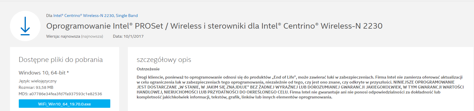

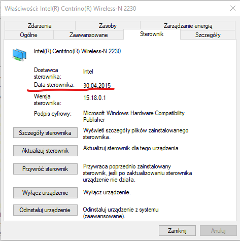

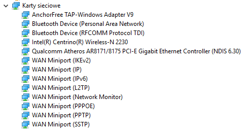

    I did everything in the Youtube tutorial.
    As for the card drivers, I clicked on it and updated. Some drivers downloaded and updated, but (screen) nothing changed.
    Lenovo Y510P WiFi Speed Drops Below 1 Mb/s, Other Devices Fine .
    Since nothing changed I installed the drivers from the manufacturer's website
    However, the network card settings still show 30.04.2015 although the drivers were from 2017.
