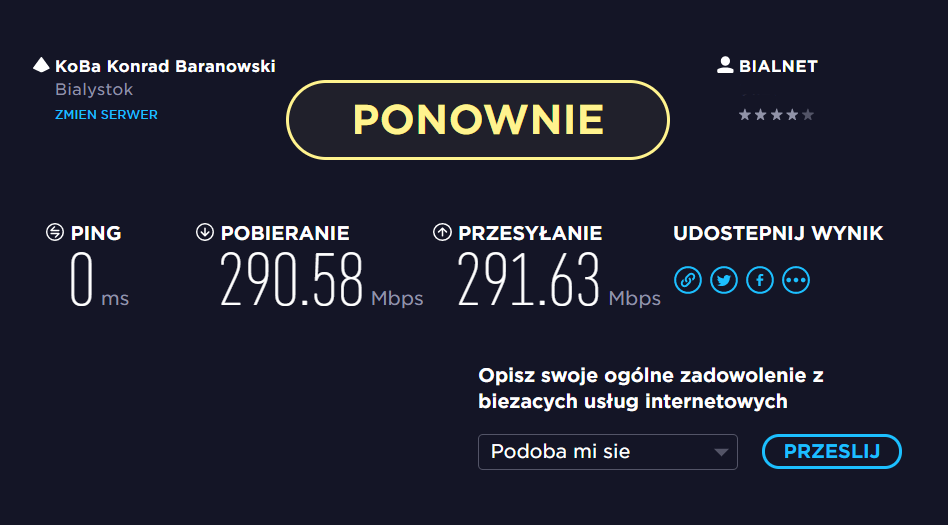

    I have a problem with my router, probably or I can't configure it.
    I have 300Mb / s internet at 300Mb / s at home - when I connect the internet via cable, the speed is as it should be:
    Poor WI-FI Speed on Laptop: Netis WF2780 Router and Acer Aspire VX15, 300Mb/s Internet
    However, when I connect to the Internet via WI-FI (5G network) I do not have such speed, I have two times lower .... :-(
    Why is this happening? My router is netis wf2780, the router stands in the next room that separates me with a wall and a door - in my opinion it shouldn't lose speed through 1 wall and door (distance is 3m from the router).

    I checked, homie, it's 250 by 250 when I'm sitting at the router.
    After all, no walls divide me from the corridor to the modem and such a great fall? about 200 Mega? Something I don't believe. Maybe something wrong with the configuration?

    Dude, especially for you I sat down completely next to the router and see what speed:

    I have fixed the internet speed in a funny way! :-) That's him:
    I have been invariably using IObit software, and more specifically the Advanced System Care program. 2 days ago a new version of ASC came out, still in beta v11. And what happened? In the older version of ASC v10 - there is no support for the AC band in Wi-Fi support! However, version 11 is already! Below the confirmation on the screenshots:
    Poor WI-FI Speed on Laptop: Netis WF2780 Router and Acer Aspire VX15, 300Mb/s Internet Poor WI-FI Speed on Laptop: Netis WF2780 Router and Acer Aspire VX15, 300Mb/s Internet
    After uninstalling version 10 and deleting the internet settings from the ASC 10 program from the registry, and then after entering the settings from the ASC version 11 regarding the WiFi-AC band, my Wi-Fi speed increased significantly without having to move my laptop or router!
    Look at my all-the-time speed now! At the same distance! (DOWNLOAD speed fluctuates because sometimes the STEAM updates in the background)
