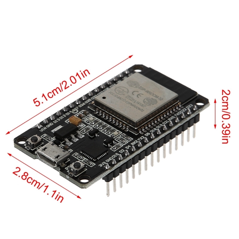

    Hi.
    I have started exploring ESP-WROOM-32 using the original IDF version of Stable: https://docs.espressif.com/projects/esp-idf/en/stable/index.html
    The version I have:
    ESP32+IDF: Unstable operation (resetting,hanging,hacking attack,backdoor) .
    Based on the original esp_http_client examples: https://docs.espressif.com/projects/esp-idf/e.../api-reference/protocols/esp_http_client.html.
    I have prepared two modules.
    Both modules make an http request to the server at cba.pl sending data received by the PHP script and loaded into the database:
    - module A - every 10 seconds
    - module B - every 15 minutes
    Module A works very unstably by resetting itself several times a day (sometimes every 2 minutes, and sometimes it works for many hours without resetting). Sometimes it can also hang up completely - the reset button helps. I suspect that it may not be able to keep up with requests in particular when the cba.pl server is holding it down.
    Module B is working much more stably, but it has also reset a few times over a few days.
    Both modules in the same version - new.
    Both modules have a good power supply, plus module A has a 220uF LOW ESR capacitor soldered in.
    I'll paste the program code tomorrow, as I don't have access to the computer I wrote it on. It is possible that I have written something incorrectly.
    I have not specifically implemented the Watchdog yet.
    My question is about your experiences with the stability of ESP32 operation under the original IDF? Do you have any problems?

    In general, changing the IDF to Stable 3.2. has ensured stable operation of the modules, but ...
    .... it depends on the module version: .
    So far I've used ESP32 modules in the version with the white board on the underside :
    On Saturday I tried others, which are black on the underside . When I uploaded the BLINK example, there was no problem, but when I started using WiFi transmission e.g. in station mode (increased current demand), the modules reported a brownout reset. I checked the supply voltage directly on the VCC pin of the Esp32 with an oscilloscope and this is indeed the problem.
    Probably the tantalum capacitor on the board is too small or of poor quality. So I added a 220uF low ESR electrolytic capacitor (220mΩ) directly on the ESP32 pins and now it is ok. I checked two such modules - both had the same problem.
    The white module has been running for 5 days and has already added (every 10 seconds) over 43200 records to the database on my server and still works fine - this is the version with the white board underneath without the extra capacitor.

  • Direct 3.3 V supply and EN reset RC fix ESP32 hangs
    #27 20976179
    Wodz23
    Posts: 15
    Rate: 10
    In order for the ESP32 not to hang up, all you need to do is skip the UART circuit. Feed 3.3v directly to the 3.3v pin from another good power supply....
    Use the usb connector only for programming and do not power the chip with it.
    Pinning the capacitors doesn't do much, but good as they are. You can add a 10K resistor between the plus 3.3v and EN (RESET)
    and an electrolytic capacitor from EN 1uF (I gave 22uF) to GND. After this procedure, the ESP32 starts immediately when power is applied.
    It works without hang-ups connects to the network momentarily and not as before a minimum of 30 seconds and works stably.
    Regards.
