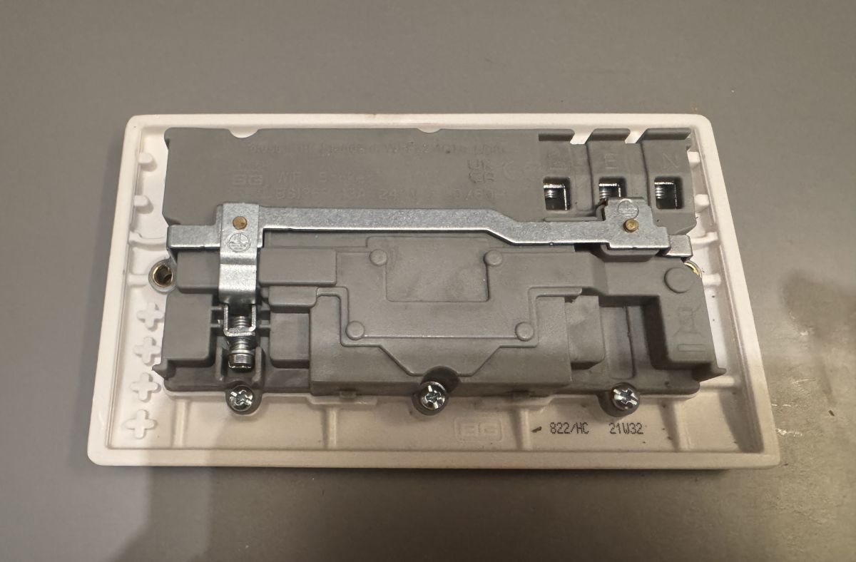

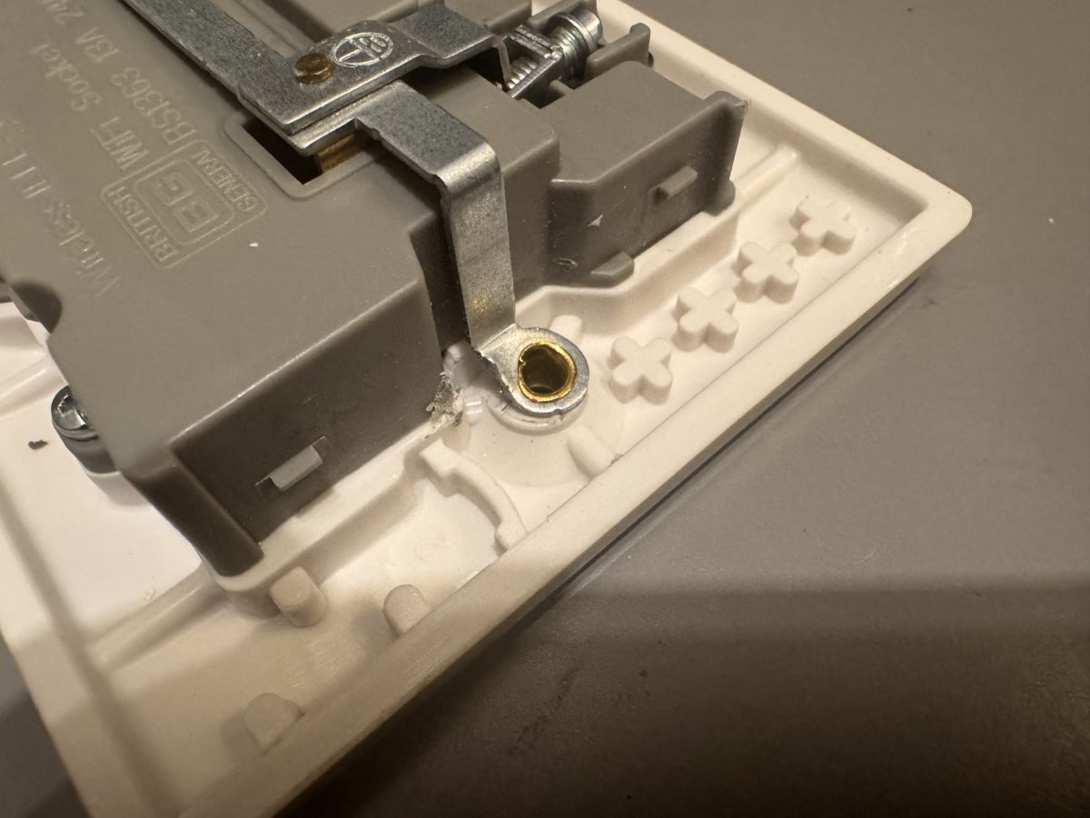

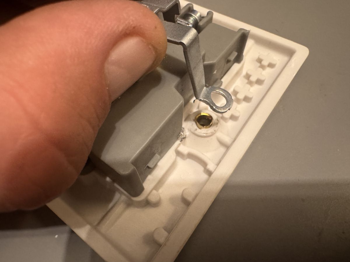

  • Earth strap must be cut to access internals
    #8 21716534
    gandi69
    Posts: 99
    Yes that is the device I have these are very common and cheap here in the UK. LED configs are a problem for me though as I cannot work out how to fire the blue LED ring per switch as this unit requires the relay to be on so it can fire the GPIO pin for the corresponding ring to light. Currently I have one ring firing blue for relay 2 and one firing both in red for relay. If I try to mimic the config of relay 2 on relay 1 it doesn’t light. Not a huge problem but could be an issue if someone uses the switch manually which is unlikely for my use case
    Relay 2 on
    BG Electrical 822/HC-01 RDA5981A BL3335-P Module Double UK Smart Socket
    Relay 1 on
    Another note you have to kind of butcher the earth strap across the back of the unit to get to the innards of this device as it uses a brass rivet arrangement for earths, I will attempt to fix this later so it is safe and tidy

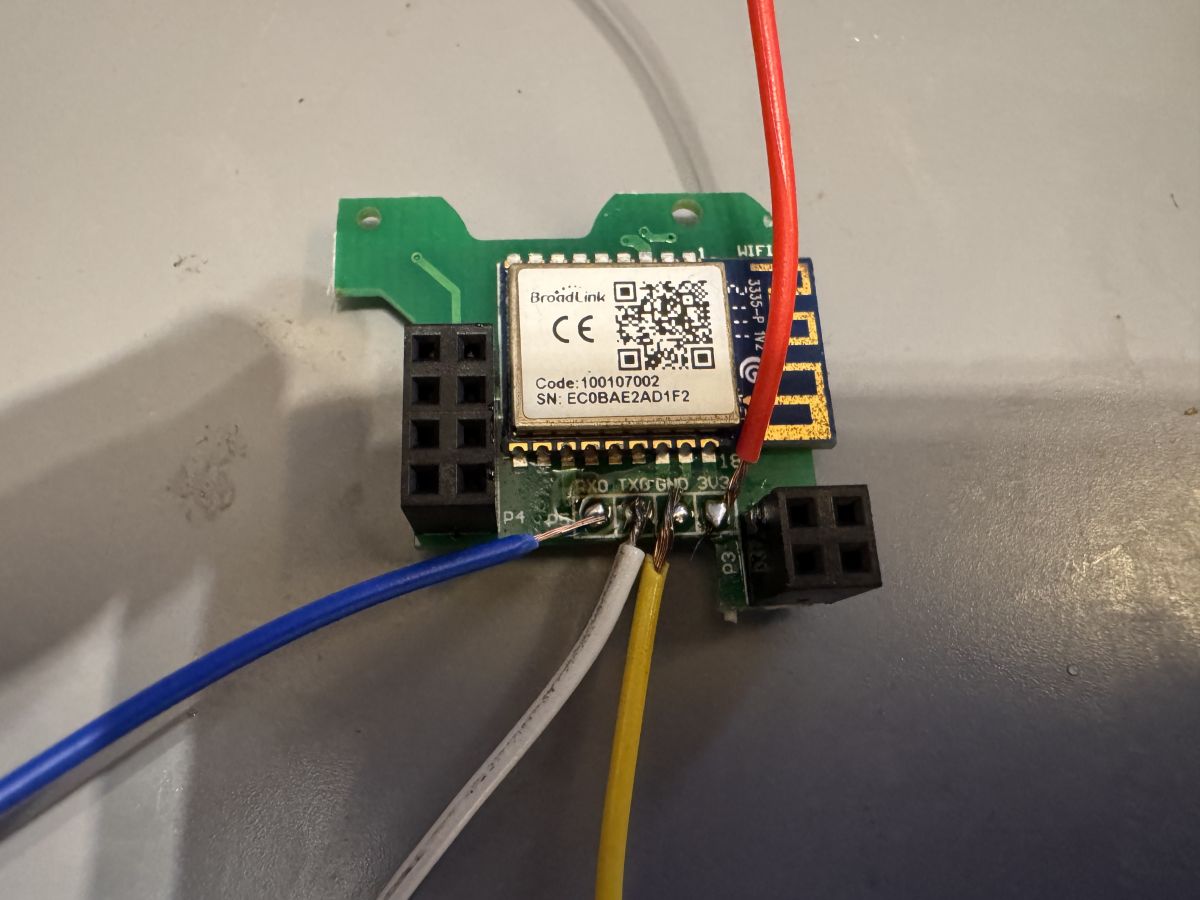

  • Correct dump settings for BL3335-P flash extraction
    #16 21719655
    bertjones
    Level 4  
    >>21719588
    I've had some BG sockets connected to Home Assistant for a couple of years and have always wanted to replace the firmware with something that doesn't continually try to connect to the internet. I've got the sockets blocked by a router firewall rule. They still work but blocking them causes them to drop and reconnect to the wifi regularly.
    I've just found this forum and the very helpful information on it. I've flashed lots of ESP devices but have never flashed Broadcom or Tuya type devices so I'm very new to this. After reading this thread and a bit of experimenting I've managed to do a rom dump of the BL3335-P with its factory settings and a rom dump with my wifi settings in it.
    Hopefully the information below will be of help. Some of it may be obvious to you but as a beginner it wasn't to me. :-
    With the module pcb plugged into the BG socket pcb I powered it from an external 3.3v supply.
    Red leds flashed at boot up. I assume until wifi connected.
    Blue leds go on and off with the power buttons.
    NOTE
    The relays will not turn on as they use a higher voltage power supply that isn't available unless the mains is connected. WHICH IT MUST NOT BE WHILE CONNECTED TO THE USB TO SERIAL ADAPTOR.
    Ran RDA Dump Tool v01.00.03 in Windows 10
    With the default settings :-
    Baudrate 921600
    Dump Address 0x 18000000
    Length of Word 0x3fc00
    Set to 1MByte
    EDIT
    After reading https://www.elektroda.com/rtvforum/topic4148573.html I've realised that the 1M Dump setting doesn't give the full 1M rom dump!
    To get the full dump set Length of Word to 0x7fc00 and Flash Size to 2M, so dump is just short of 2mb. The file can be trimmed down in HxD later.
    Alternatively, select 2mb flash size and word length of 0x3ffff.
    With a USB to Serial adaptor connected to RX and TX and earth. So the 3.3v supply earth and flasher board earth are connected together.
    With the Dump Tool running and connected to the USB to Serial adaptor port, hit Start. Then turn on the 3.3v power to the BG socket. It will connect and create a dump file. You may need to power the BG board on and off a few times before the Dump Tool will connect to it.
    Tried with 1M, 2M and 4M settings and all dump files were 1M in size and the Dumped 100% value was 0x180fc000 in all cases.
    Checking the MD5 of the files and they were all identical.
    When the Dump Tool has connected to the module the red leds do not come on at power up and the buttons will not turn the blue leds on or off. If the leds flash then the Dump Tool hasn't connected and you need to turn the 3.3v power off and on again for it to connect.
    I then reset the socket by holding the left button until red leds flashed fast.
    Then ran the Dump Tool to get a factory rom dump. Had to power the module off and on a few times before the Dump Tool connected and started to do a backup.
    ________________
    EDIT
    Post https://www.elektroda.com/rtvforum/topic4148573.html also explains that to get a readable log using Putty you need to pull GPIO21 high at boot up which means removing the metal shield to get to it.
    Before using the Dump Tool I used PuTTY to listen to the com port. It showed characters but was gibberish. Tried 9600, 115200, 921600 with 8,N,1 and 7,N,1 etc. None gave a readable output. 921600 was the worst and seemed to be the same 3 characters in random order.
    But 7,N,1 gave a more readable output.
    Tried N, E, O, Mark, Space with None and Xon/Xoff etc. None gave a non gibberish output.
    If the module pcb is unplugged and powered up, the red leds flash until connected to wifi, the blue leds stay lit all the time and don't go on and off with the buttons.
    If you need a copy of the factory rom dump let me know.
    Next is to use OpenRDA5981 and try to get the sockets fully working with it. Hopefully gandi69 will have figured it all out before I try it which will save me some time!

  • Power-cycle BL3335-P to dump complete ROM
    #18 21719975
    bertjones
    Level 4  
    >>21719695
    After reading your very helpful BroadLink SP4L-UK tear down https://www.elektroda.com/rtvforum/topic4148573.html I've realised that the ROM dumps I've taken will not be complete.
    So in case anyone reads my previous post I've edited it with the corrections to get the complete 1M ROM dumps.
    Powering on the BL3335-P after hitting Start on the ROM dump program worked to allow the ROM to be dumped. If it didn't work 1st time powering it off and on a couple of times always allowed it to connect and do a ROM dump. That's much easier than removing the metal can and using a pin to connect to IO21
    Hopefully someone will work out how to get OTA working

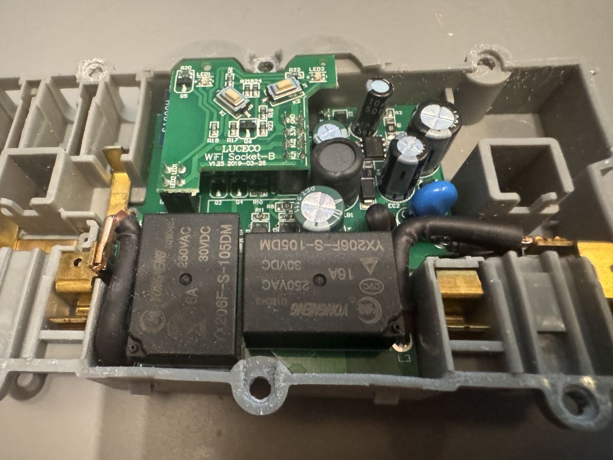

  • Photos of BG smart socket internals for OpenRDA flashing
    #27 21723928
    gandi69
    Posts: 99
    Just a few pictures for those have these and wish to flash them to OpenRDA.
    Back of BG smart socket with visible L, E and N connection terminalsClose-up of electric socket interior showing metal mounting clip and plastic housingClose-up of ground lug inside an electrical socket mounted in plastic housingWi-Fi electronic module with relays and capacitors in a plastic housingESP8266 WiFi module with connected wires on a prototype PCB
    I’ve tried another socket which was a “time guard” which flashed to Tasmota so would take OpenESP 8266 really easily but the quality of the hardware is low so won’t be bothering again with those.
    Next one on my list is the Varilight double socket which is Tuya based. As they come in other colours rather than white it’s ideal for other areas of my home however they are significantly more expensive than these BG electrical ones.

    Photos of BG Electrical socket internals for OpenRDA flashing
    #29 21799281
    geekydrewbie
    Level 4  
    Just a few pictures for those who have these and wish to flash them to OpenRDA.
    @gandi69 Just came across this forum post as I have several of the BG Electrical 822/HC-01 sockets that I want to customise to stop them speaking to the internet. If I block them, they don't behave and seem to turn things on and off, so I will be trying to do that using what is outlined in this article. How did you fix the earth strap after removing it?
  • #30 21799296
    gandi69
    Posts: 99
    You can either re-rivet it back on or simply put the mounting screw through it and tighten it up - that’s what I did and they’ve been fine. It’s earthed all the way along that strap from the other side anyway so shouldn’t be a problem

How do I flash OpenRDA5981 on Windows, step by step?
  1. Connect 3.3 V, GND, TX, RX between your USB‑serial adapter and BL3335‑P.
  2. In the RDA Windows tool, select the COM port and settings; click Start.
  3. Apply 3.3 V power to the module; retry power‑cycling until it connects and completes. [Elektroda, bertjones, post #21719655]
Where do I download the OpenRDA5981 firmware binary?
Releases are published under the OpenBK7231T_App releases page referenced in‑thread. Grab the OpenRDA5981 build from the releases section before flashing with the RDA tool. [Elektroda, divadiow, post #21712734]
Does OpenRDA5981 support OTA updates now?
Yes. As of November 2, 2025, OpenRDA5981 supports OTA, and Easy Flasher also supports RDA read/write. Older OpenRDA builds will need a one‑time wired update to migrate. “OpenRDA now uses the Ali bootloader.” [Elektroda, divadiow, post #21739104]
What pins do I need to wire for flashing?
Only 3.3 V, GND, TX, and RX are needed. A user confirmed successful OpenRDA flashing with just power and UART lines, no extra boot‑mode pins required. This keeps the hardware hookup simple. [Elektroda, gandi69, post #21716496]
What UART settings and sequence work best?
Use 3.3 V UART at 921600 baud. Start the RDA Dump/Flash tool, then power the module. If it doesn’t connect, power‑cycle and retry; it will usually attach after one or two attempts. [Elektroda, bertjones, post #21719655]
How do I get readable boot logs instead of gibberish?
Pull IO21 high at boot for a readable debug log, and share ground between your power supply and USB‑serial adapter. This tip comes directly from the thread’s BroadLink/RDA5981 logging guidance. [Elektroda, divadiow, post #21719695]
My relays don’t click on the bench—what’s wrong?
On bench power (3.3 V), the relays won’t energize because they use a higher‑voltage supply only present on mains. Do not connect mains while the USB‑serial adapter is attached for safety. [Elektroda, bertjones, post #21719655]
How do I map buttons, relays, and LEDs in a template?
Example mapping: Btn_n on pins 3 and 4 (channels 60/59), Rel on 7 and 26, LEDs on 8 and 25 to follow channels. Match channel numbers to link each LED with its relay. [Elektroda, gandi69, post #21720578]
The blue LED rings only light when relays are on—can I make them independent?
Yes. Set GPIO25 to AlwaysHigh so the blue rings can light independently. After applying AlwaysHigh;0 on pin 25, both rings behave as expected with button control. [Elektroda, gandi69, post #21720596]
Any hardware caveats when opening the BG double socket?
Accessing the module often requires cutting the rear earth strap rivet, then restoring it properly. Plan for safe rework so that the earth continuity remains sound after reassembly. [Elektroda, gandi69, post #21716534]
