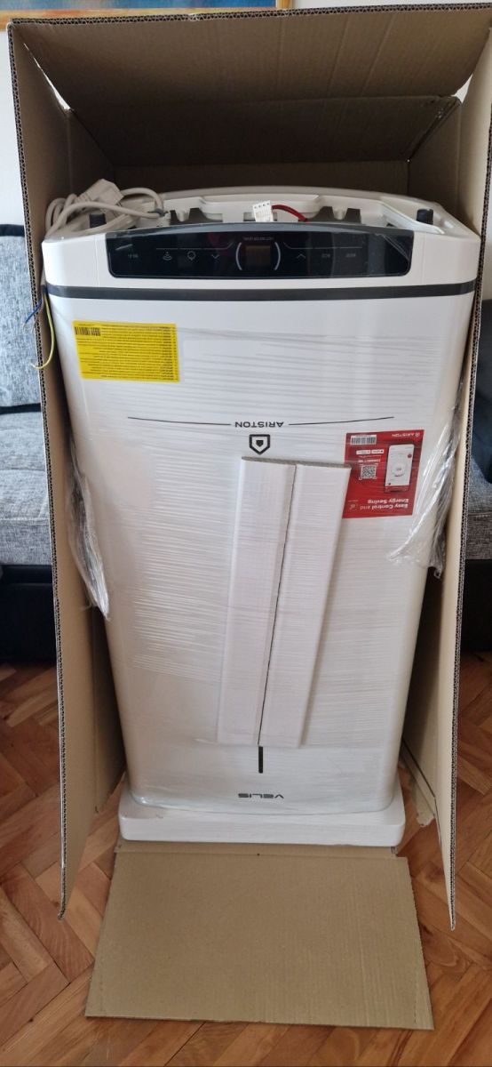

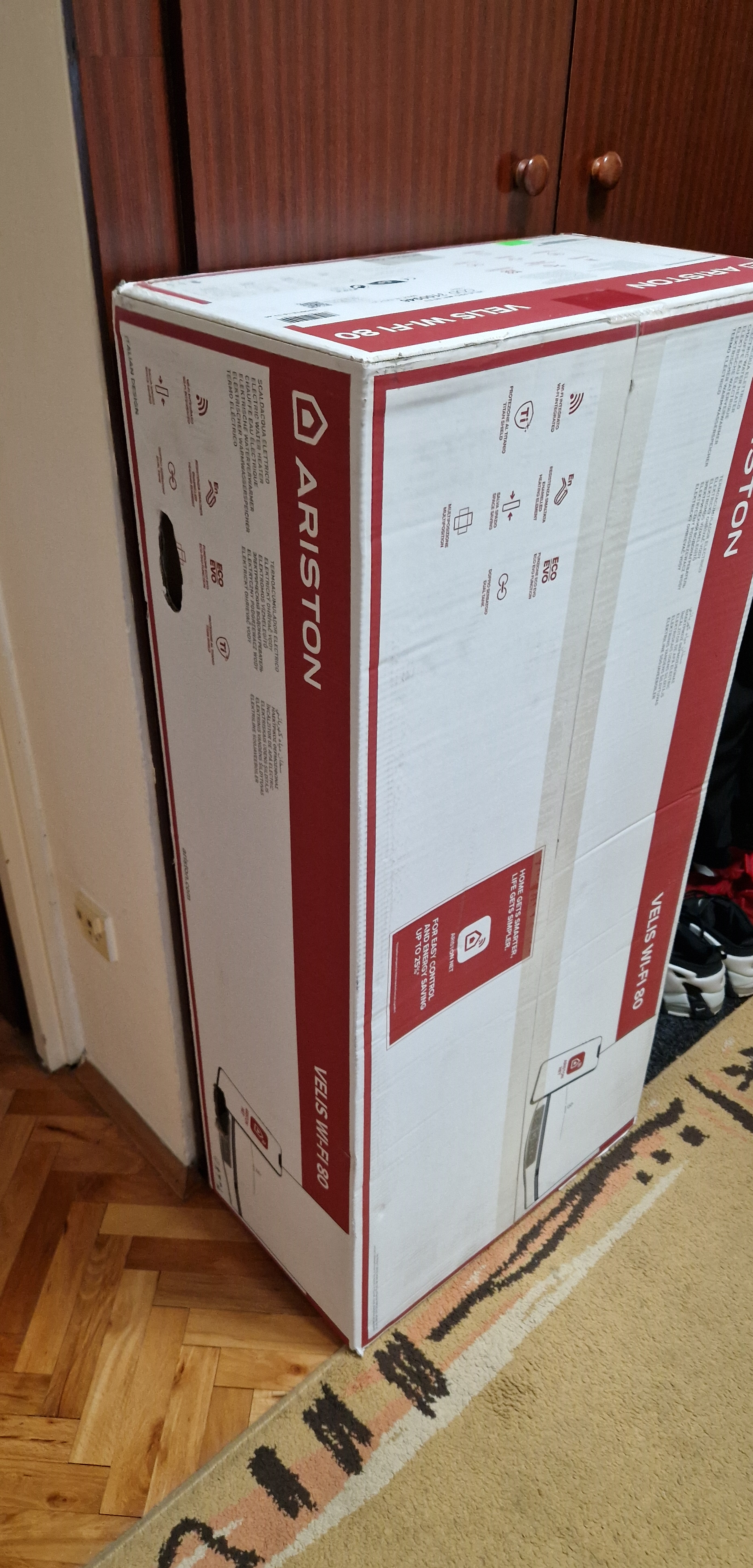

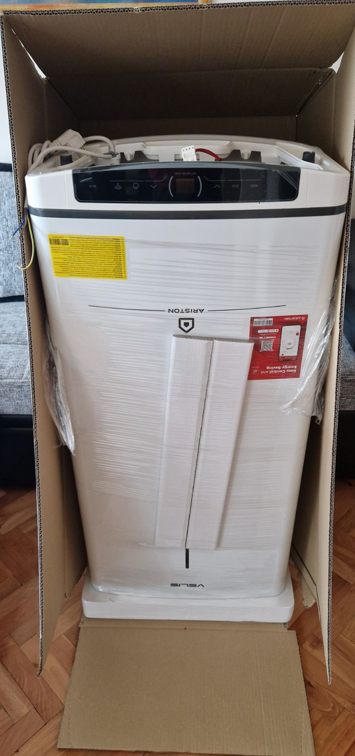

    The package arrived quite quickly, the courier brought such a box:
    Box of the Ariston Velis Wi-Fi 80 water heater standing vertically by the wall. .

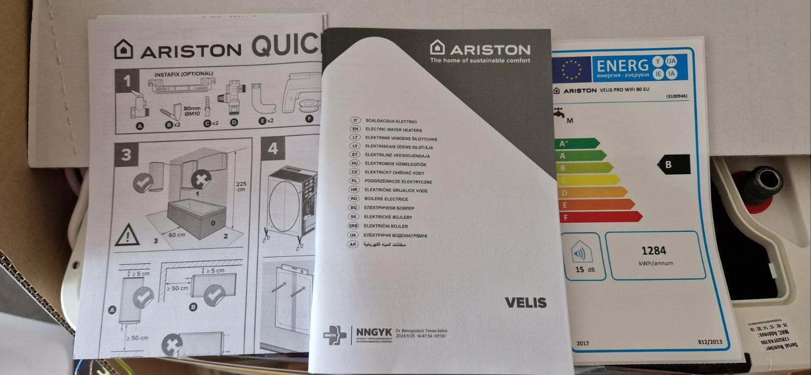

    The whole thing is well packed for transport. In the box we have a full pictorial manual and a detailed multilingual manual. There is also a leaflet declaring the energy class B of the product.
    Set of Ariston Velis 80 documents with manual and energy label .

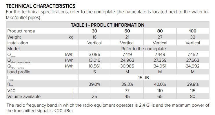

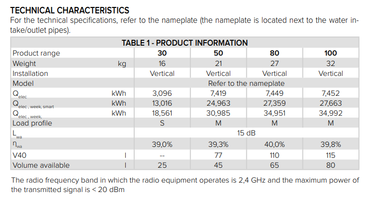

    The manual is also available online. It specifies parameters such as (for the 80 version) a weight of 27 kg, a capacity of 65 litres, a noise level of 15 dB and a declared energy consumption per week of approximately 27 kWh in smart mode and 35 kWh in standard mode.
    Technical data table for Ariston water heaters with 30–100 liter capacities .

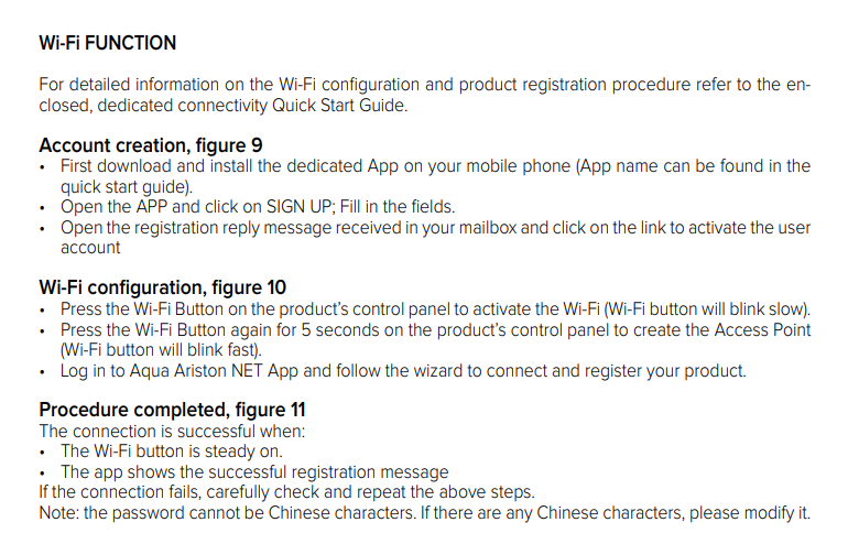

    Pairing is very simple, we simply put the device into pairing mode following the instructions after registering with the app.
    Instructions for Ariston NET Wi-Fi setup and app registration procedure .

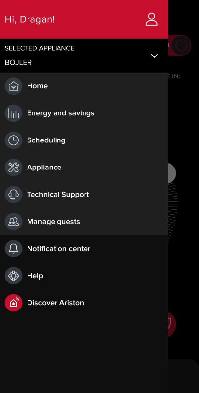

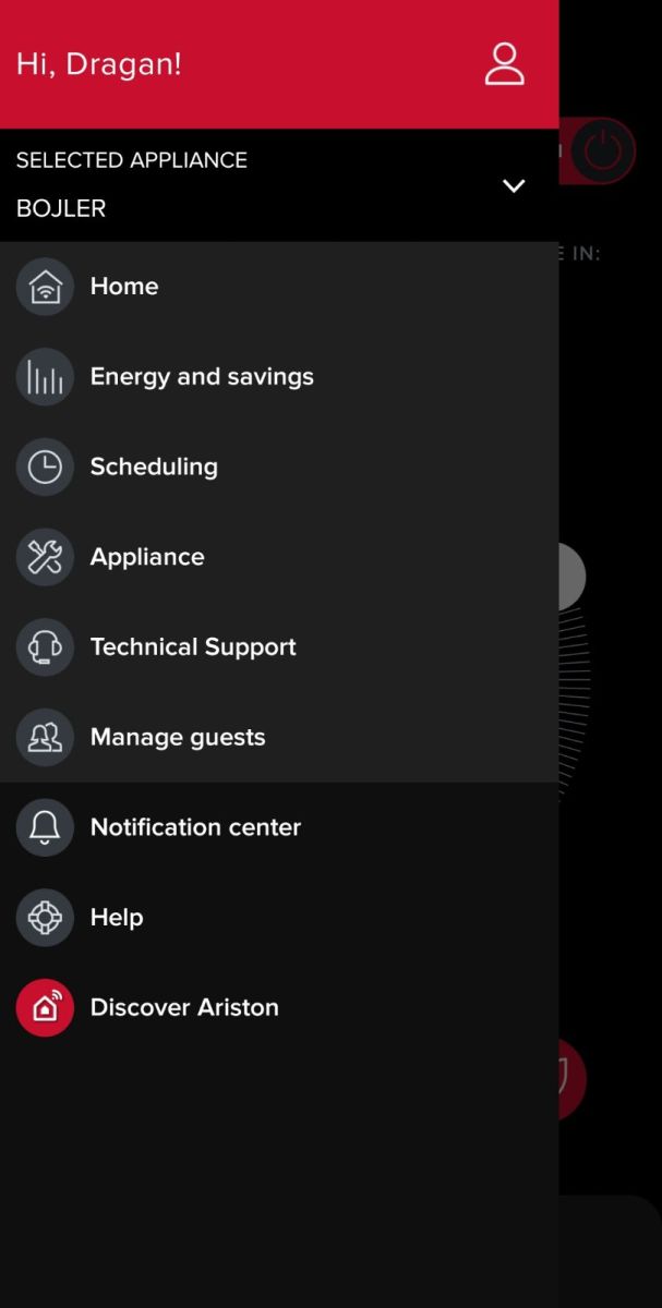

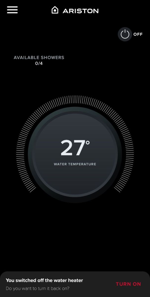

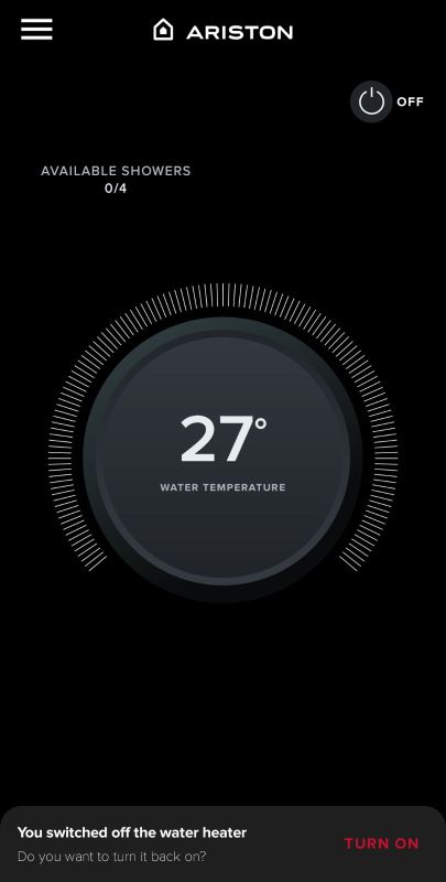

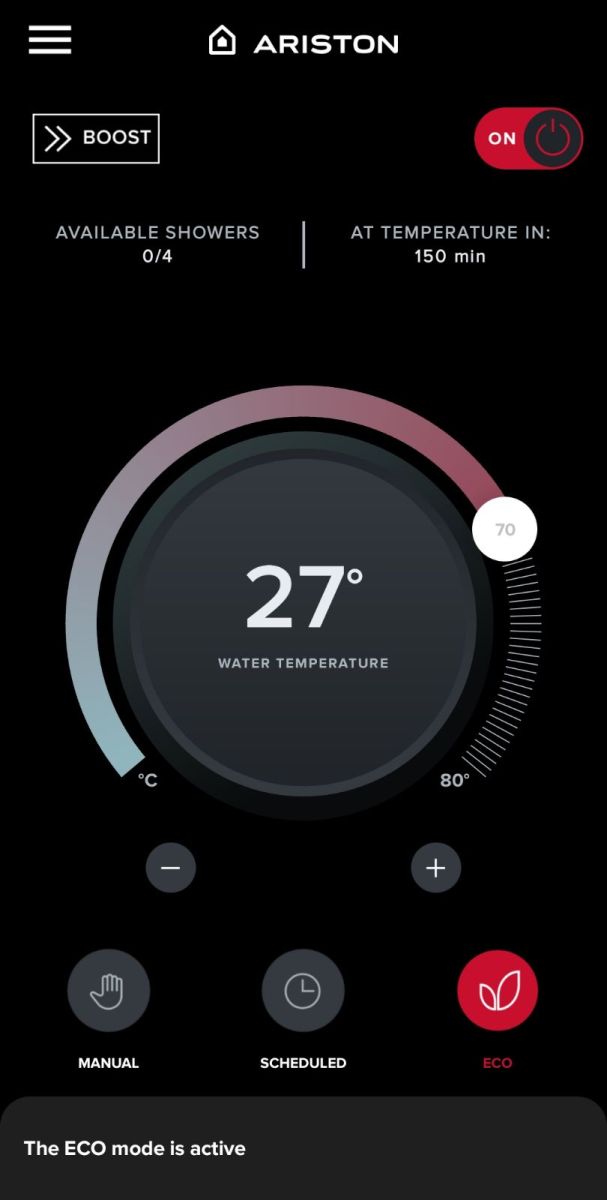

    We then get access to the boiler panel, where we can edit its programme and schedule, create automation, view the current and target temperatures, check the time left to heat up and the estimated number of 'showers' its condition will allow:
    Ariston NET app screen showing 27°C water temperature with ECO mode active Ariston NET app menu with selected device BOJLER and greeting Hi, Dragan! Ariston NET app interface with water temperature at 27°C and heater turned off .

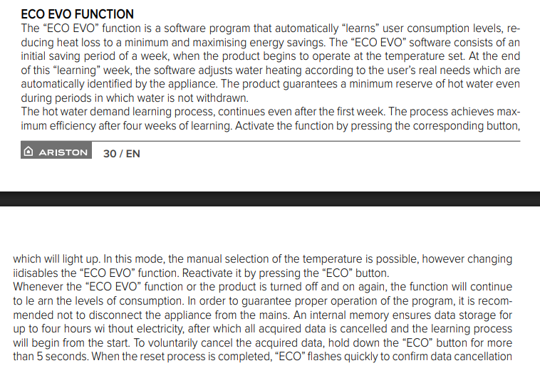

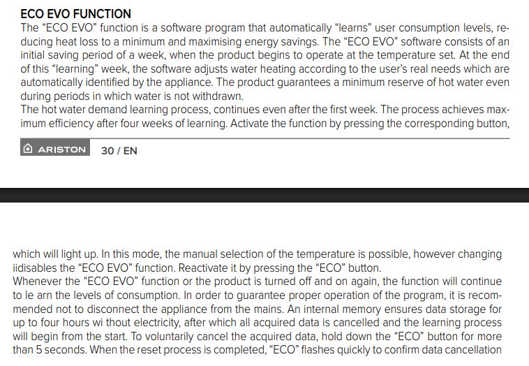

    An interesting feature is the ECO option - this is based on an analysis of the user's previous habits. At first, this function "learns" for a week how we use the boiler and then adapts the heating to our habits. The aim is to reduce energy consumption and reduce heating when it is not needed.
    Description of ECO EVO function from Ariston boiler user manual .
    The learning process continues and reaches its greatest efficiency after a few weeks. At the same time, the algorithm makes sure that even in an unexpected situation, the boiler has a minimum of usable hot water.

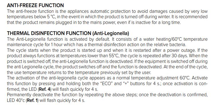

    Description of antifreeze and thermal disinfection functions in Ariston water heater .
    The boiler also has functions such as antifreeze, which is automatic protection against water freezing inside the unit by activating the heater when the temperature drops below 5 °C, and anti-legionella, which is a thermal disinfection cycle that heats the water to 60 °C per hour to eliminate Legionella bacteria.

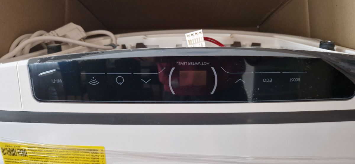

    Time to start disassembly. What does such a device control?
    Ariston Velis 80 water heater unpacked in vertical box .

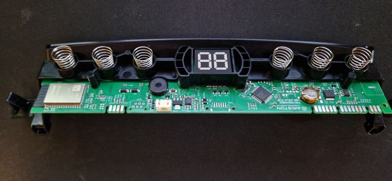

    Control panel of Ariston Velis water heater with Wi-Fi and LED display

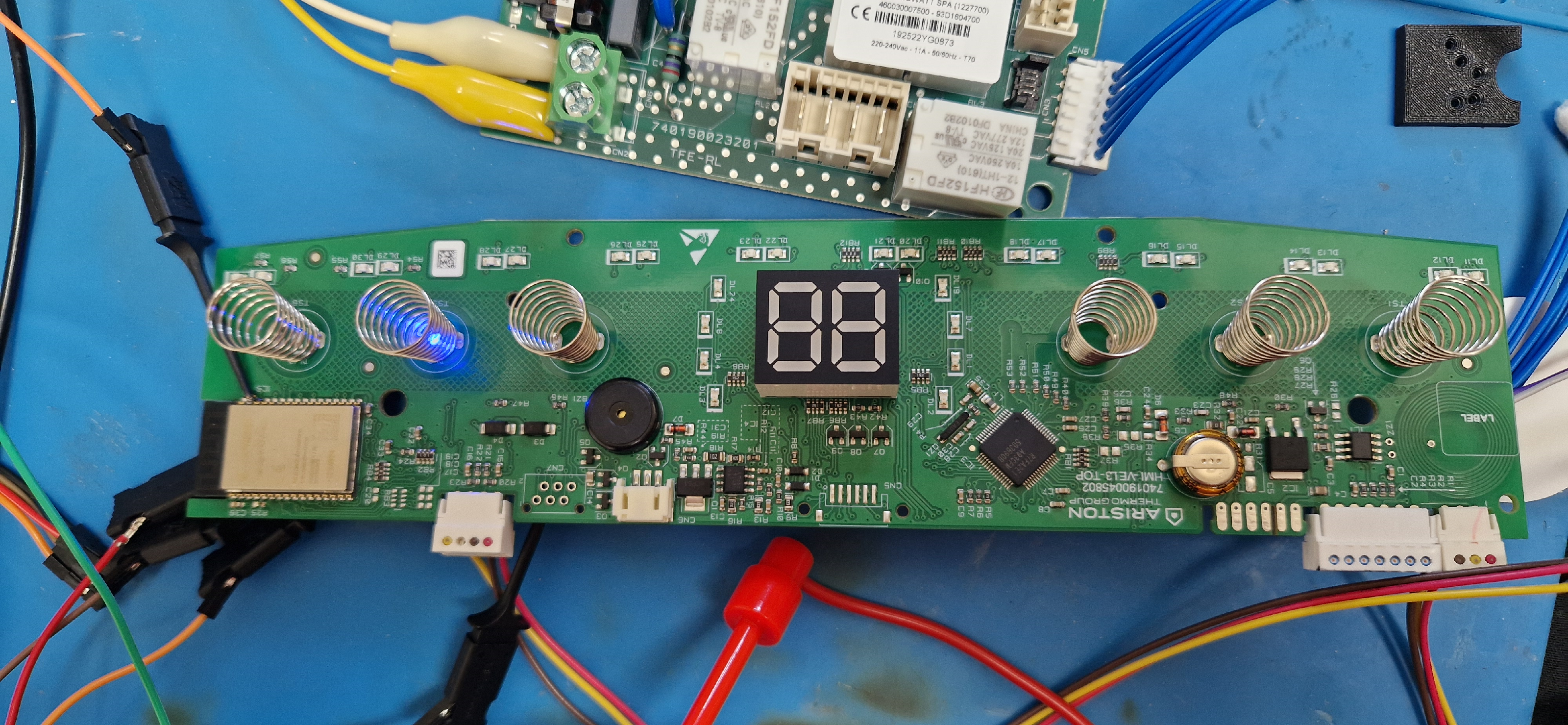

    Electronics on the table during testing:
    Ariston boiler control PCB with display and ESP32 module on a workbench .

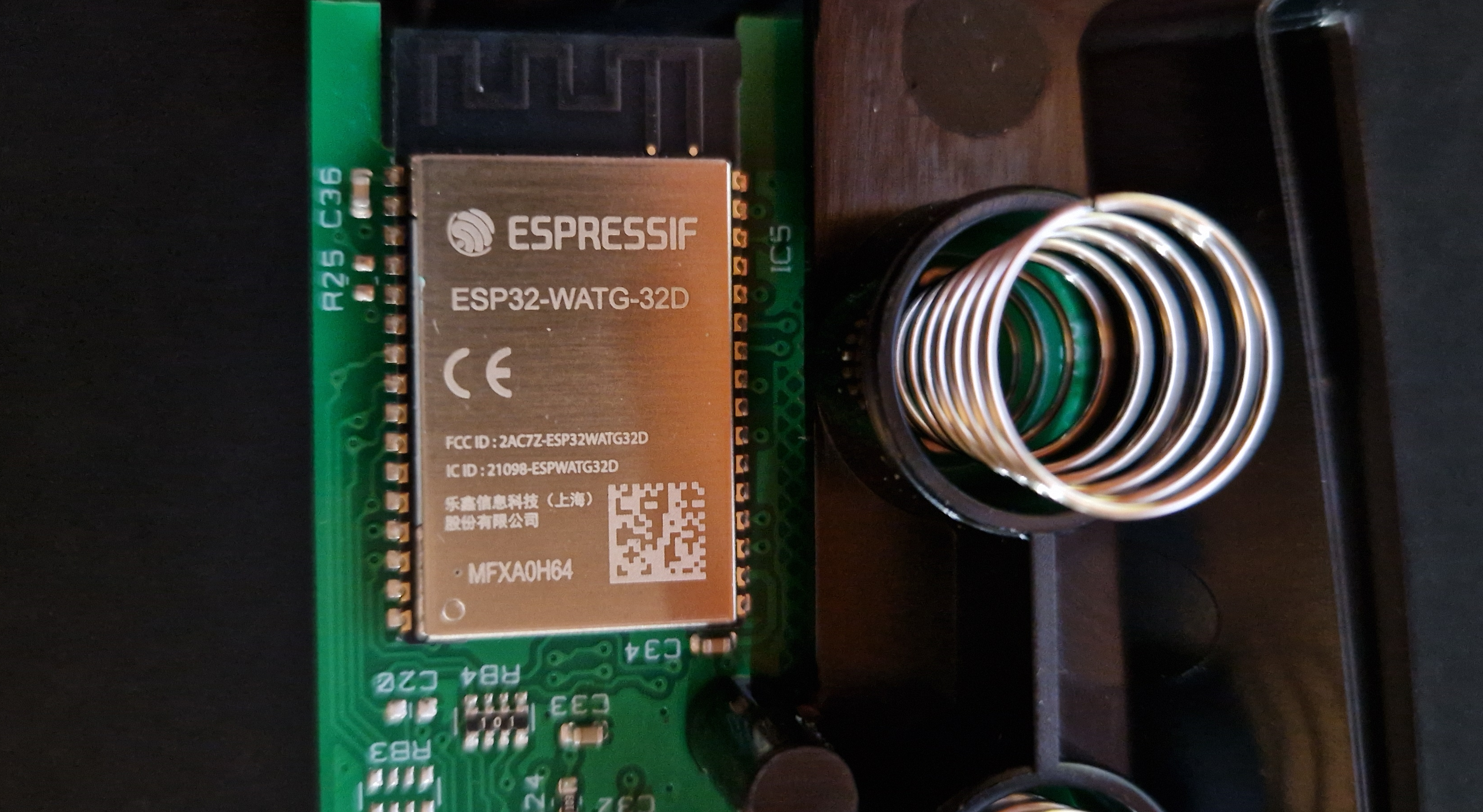

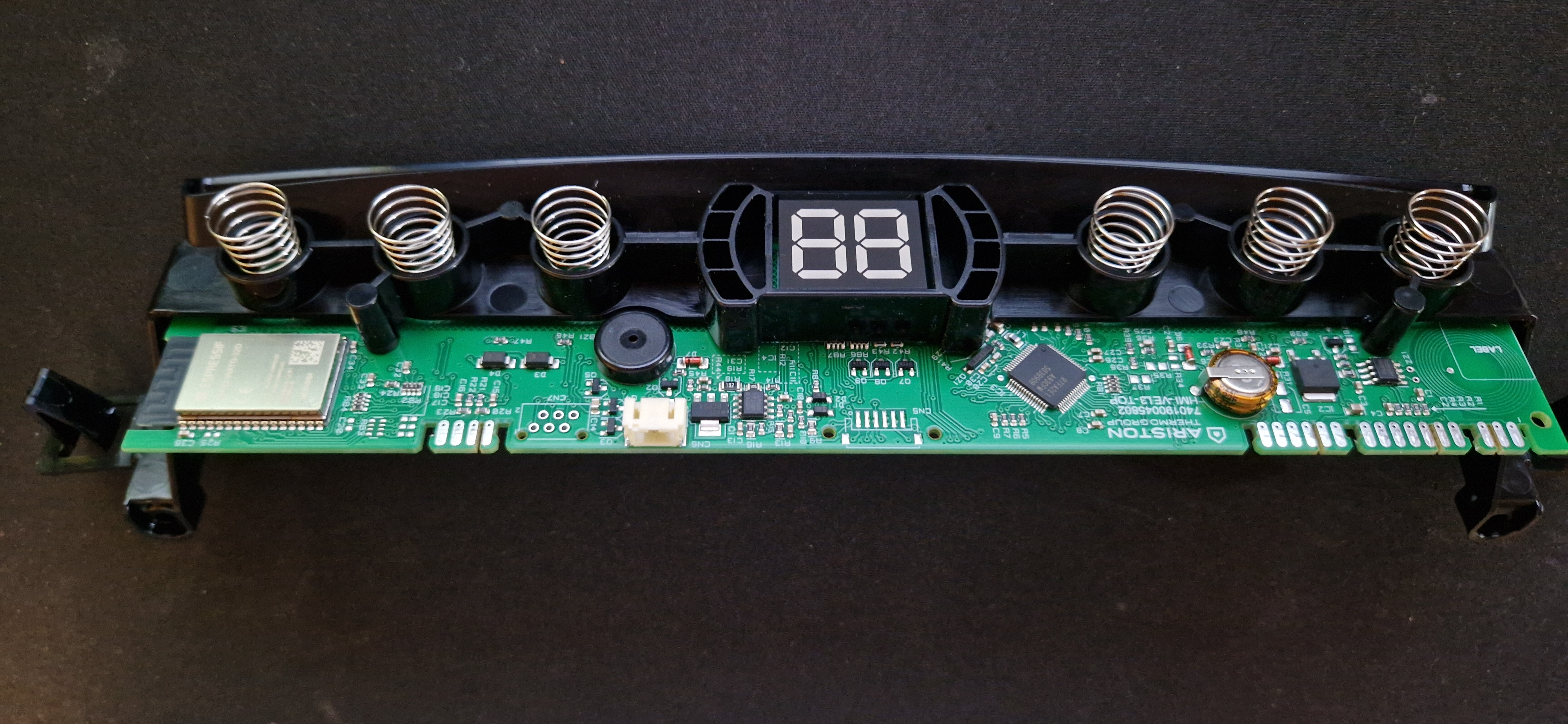

    The main panel has a 7-segment two-digit display, a Wi-Fi module with ESP32, and an additional microcontroller.
    Ariston boiler control panel with Wi-Fi module, display, and spring contacts .

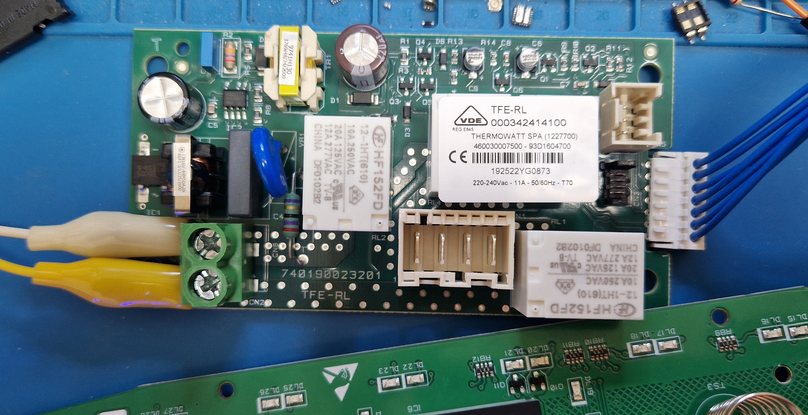

    Separately, we have a power supply with relay. The power supply is based on the LNK623DG. The designation is 740190023201 TFE-RL. Interestingly, there are even interference filters and a varistor inside already. However, this is not the cheapest product from China.
    Boiler control board with relays, capacitors, connectors, and testing clips .

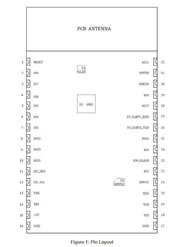

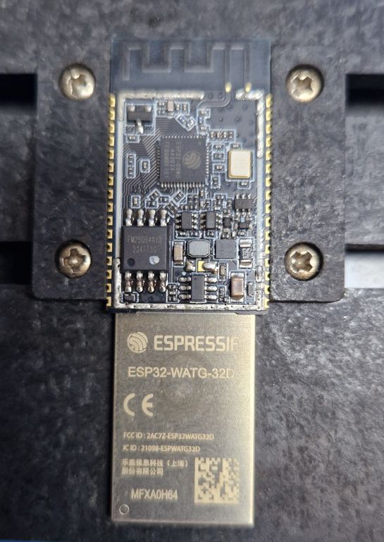

    Let's focus on the Wi-Fi module. Here we have the ESP32-WATG-32D:
    ESP32-WATG-32D module on PCB with large coil on the right .
    Outputs:
    . . . . . U0RXD
    Name No. Type Function
    RESET 1 I Module enable signal (Internal pull-up by default). Active high.
    I36 2 I GPIO36, ADC1_CH0, RTC_GPIO0
    I37 3 I GPIO37, ADC1_CH1, RTC_GPIO1
    I38 4 I GPIO38, ADC1_CH2, RTC_GPIO2
    I39 5 I GPIO39, ADC1_CH3, RTC_GPIO3
    I34 6 I GPIO34, ADC1_CH6, RTC_GPIO4
    I35 7 I GPIO35, ADC1_CH7, RTC_GPIO5
    IO32 8 I/O GPIO32, XTAL_32K_P (32.768 kHz crystal oscillator input), ADC1_CH4, TOUCH9, RTC_GPIO9
    IO33 9 I/O GPIO33, XTAL_32K_N (32.768 kHz crystal oscillator output), ADC1_CH5, TOUCH8, RTC_GPIO8
    IO25 10 I/O GPIO25, DAC_1, ADC2_CH8, RTC_GPIO6
    I2C_SDA 11 I/O GPIO26, I2C_SDA
    I2C_SCL 12 I GPIO27, I2C_SCL
    TMS 13 I/O GPIO14, MTMS
    TDI 14 I/O GPIO12, MTDI
    +5V 15 PI 5 V power supply input
    GND 16,17 PI Ground
    VIN 18 I/O 12 V / 24 V power supply input
    TCK TCK TCK 19 I/O GPIO13, MTCK
    TDO
    TDO 20 I/O GPIO15, MTDO
    EBUS2 21,35 I/O GPIO19/GPIO22, EBUS2
    IO2 22 I/O GPIO2, ADC2_CH2, TOUCH2, RTC_GPIO12, HSPIWP, HS2_DATA0
    IO0_FLASH 23 I/O Download Boot: 0 SPI Boot: 1 (Default).
    IO4 24 I/O GPIO4, ADC2_CH0, TOUCH0, RTC_GPIO10, HSPIHD, HS2_DATA1
    IO16 25 I/O GPIO16, HS1_DATA4
    5V_UART1_TXD 26 O GPIO23, 5V UART Data Transmit
    5V_UART1_RXD 27 27 I GPIO18, 5V UART Data Receive
    IO17 28 -. GPIO17, HS1_DATA5
    IO5 29 I/O GPIO5, VSPICS0, HS1_DATA6
    U0TXD 30 I/O GPIO1, U0TXD
    U0RXD 31 I/O GPIO3, U0RXD
    IO21 32 I/O GPIO21, VSPIHD
    GND 33 PI EPAD, Ground
    +3.3V 34 PO 3.3V power supply output
    Diagram showing ESP32-WATG-32D pin layout with PCB antenna at the top .
    We soldered it out using flux and hot air.
    ESP32-WATG-32D module and PCB with coils inside the Ariston water heater. .

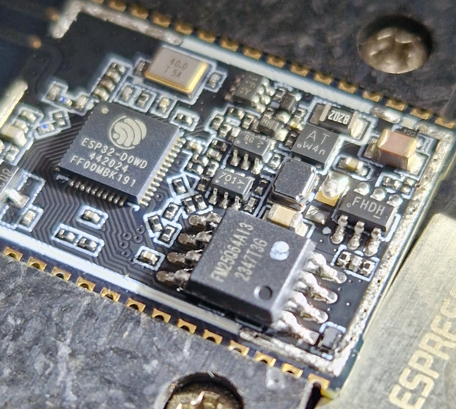

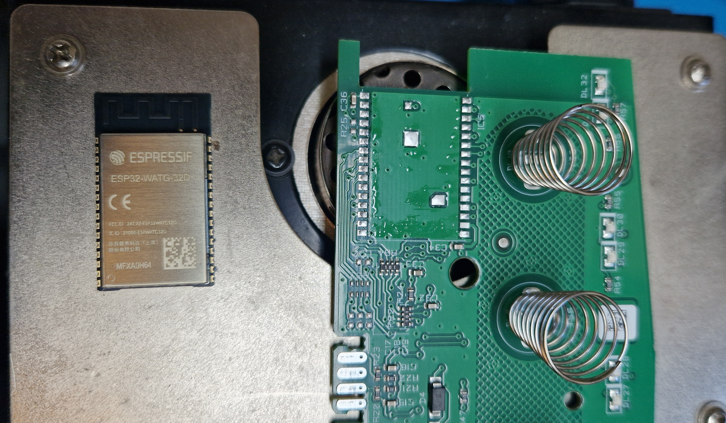

    We also looked under the screen to get to the Flash memory:
    ESP32-WATG-32D Wi-Fi module by Espressif with visible electronic components .
    Next to the ESP is the Flash memory with SPI interface - FM25Q64A13, which is 64M-BIT. Divided by 8 gives us 8Mb.
    ESP32 module with FM25Q64A13 Flash memory on printed circuit board .

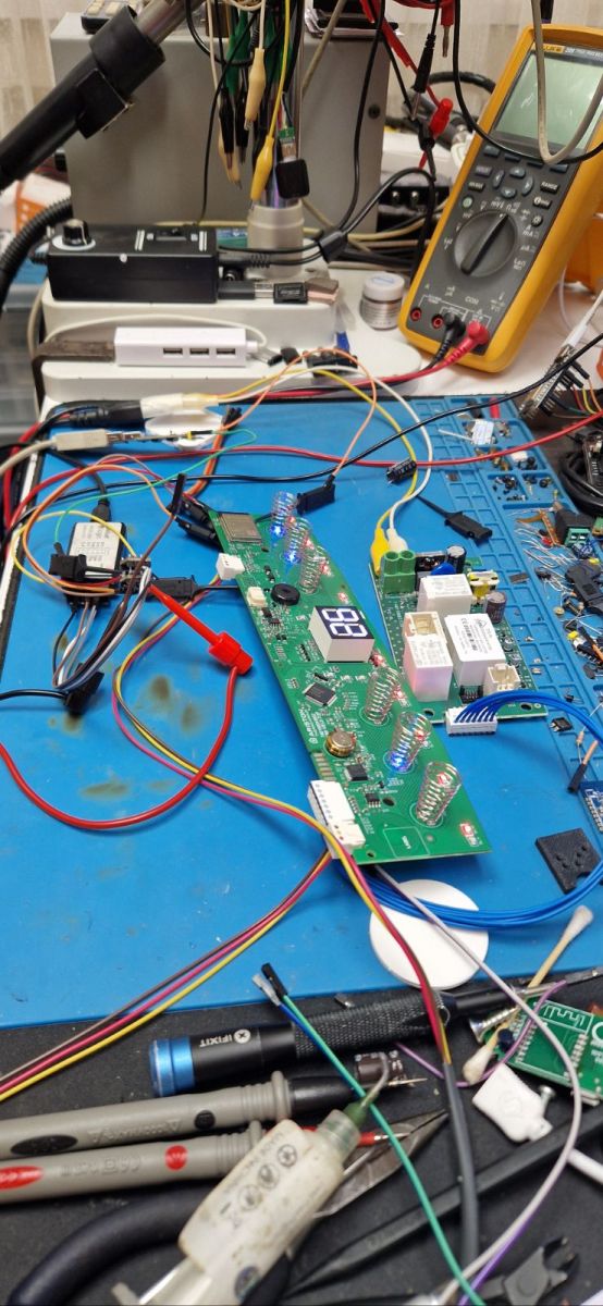

    The board connected for testing:
    Boiler PCB with ESP32 module and 7-segment display on worktable

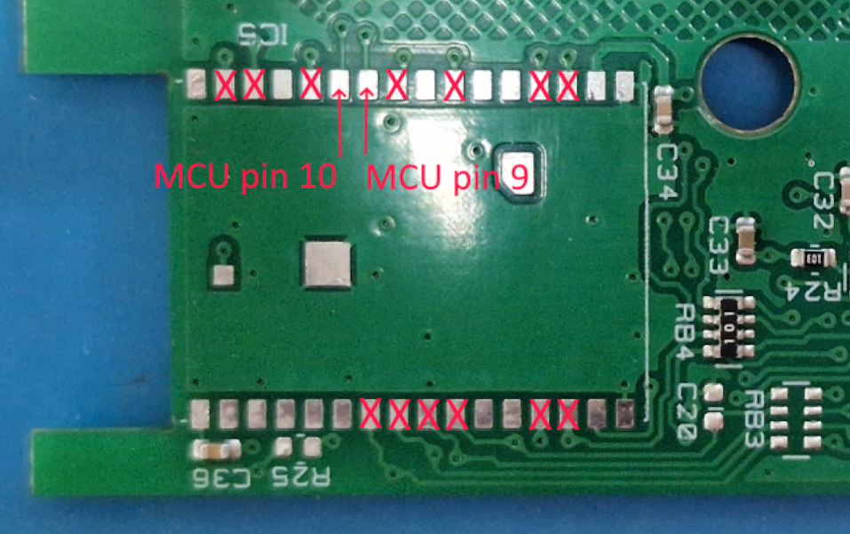

    Green PCB with MCU pins 9 and 10 labeled on removed ESP32 module pads .
    It's probably this main MCU that controls the heating, and the module from ESP32 just communicates with it. As if we knew this protocol, it would only be possible to change the ESP32 batch and so control the whole thing.

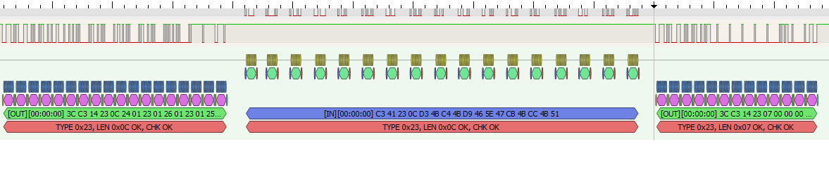

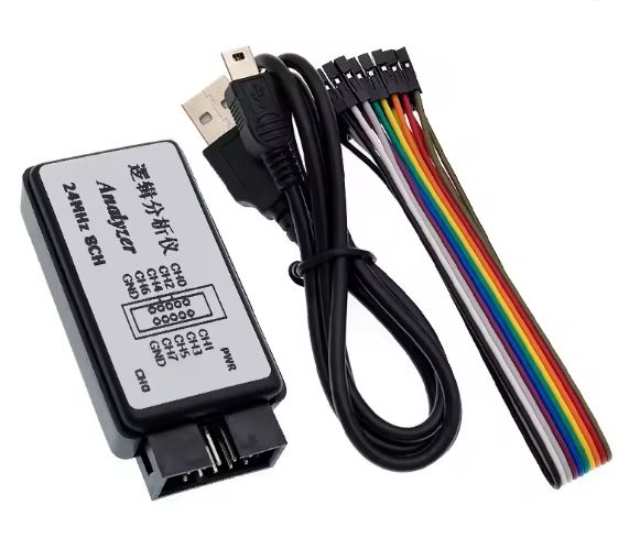

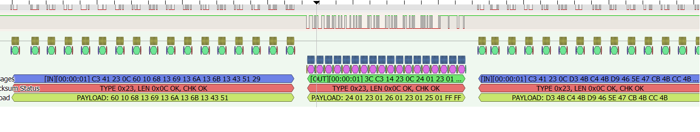

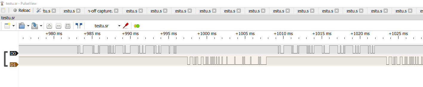

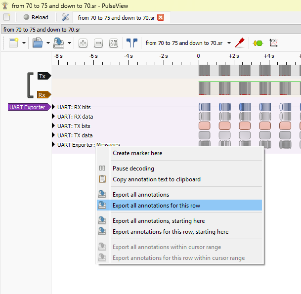

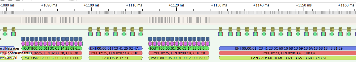

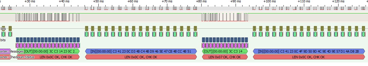

    The same can be previewed in Pulse View. Let's connect our analyser:
    24MHz 8-channel USB logic analyzer with cable and signal wires .

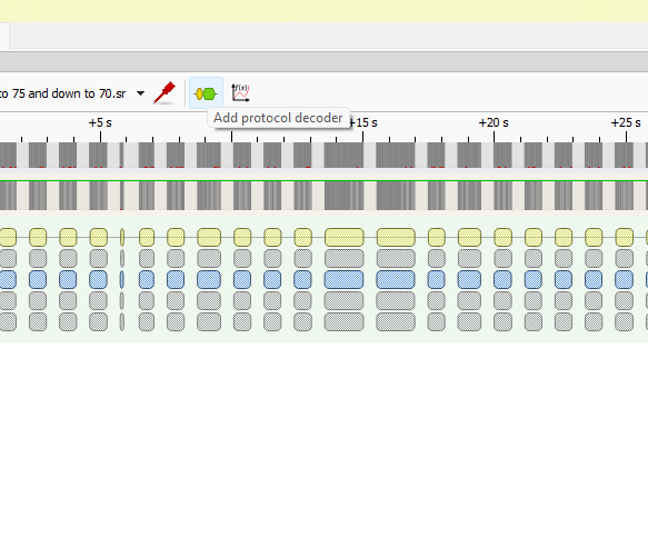

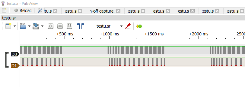

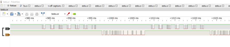

    First we capture the signals:

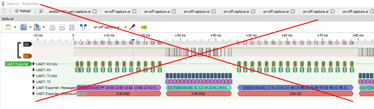

    PulseView interface showing UART data on channels D0 and D1 .

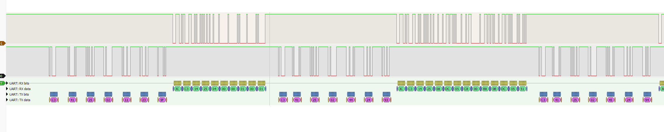

    You can see groups of transactions here, let's zoom in:
    PulseView screenshot showing UART signals on channels D0 and D1 .

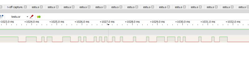

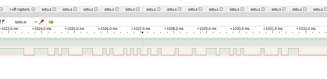

    You can also see the individual bits:
    PulseView screenshot displaying UART waveform during protocol analysis .

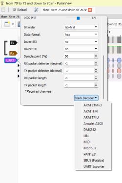

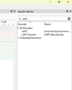

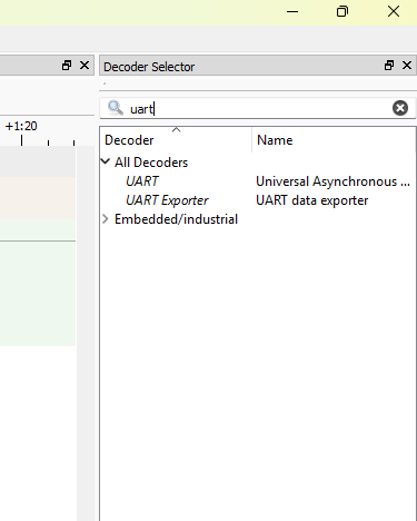

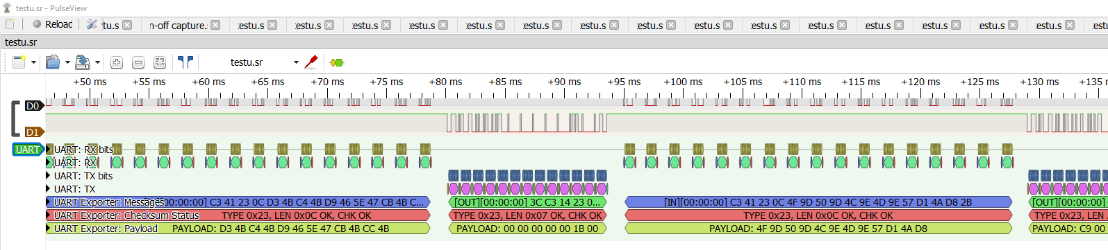

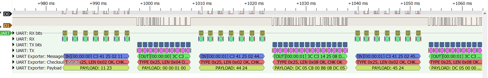

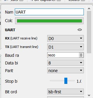

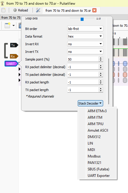

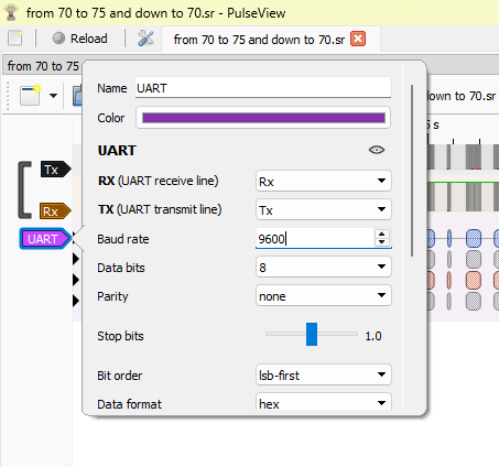

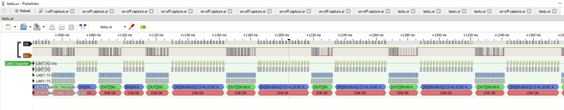

    Then we add the UART decoder:
    UART decoder settings in PulseView with 9600 baud rate configured .

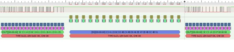

    The UART decoder allows us to easily apply bytes to the waveforms. We can then also see the transactions taking place.
    PulseView screenshot showing UART transaction analysis between devices .

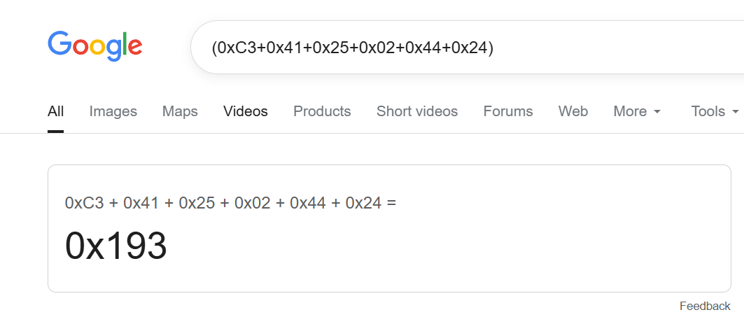

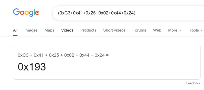

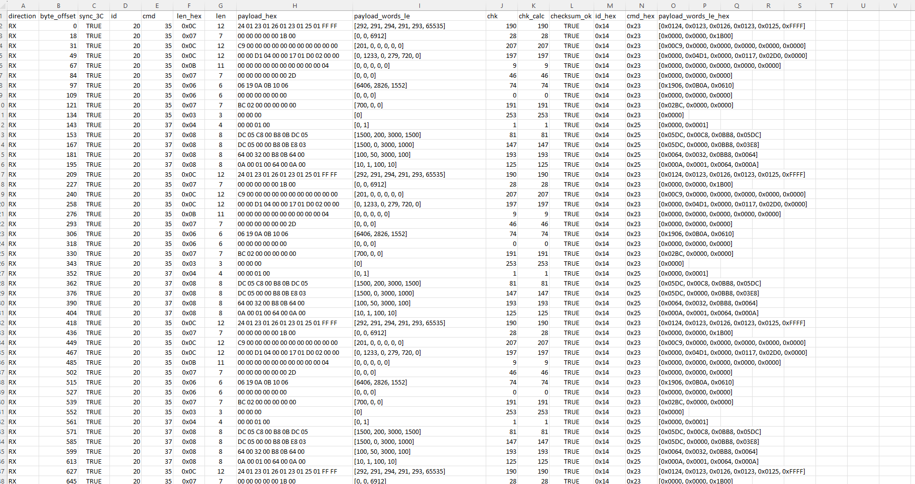

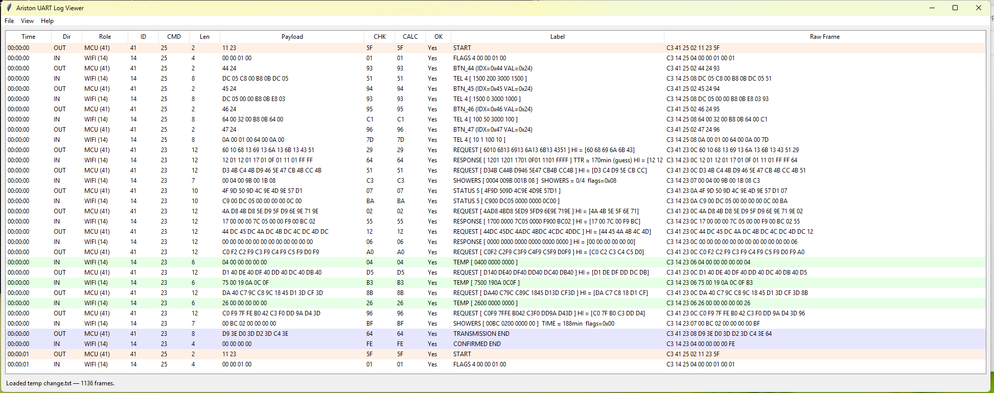

    But in fact, even without Saleae you can quickly distinguish the frames. This can be seen from the repeated packet headers:
    C3 41 23 0C 45 DC 4A DC 4B DC 4C DC 4D DC C0 F2 A4
    C3 41 23 0C C2 F9 C3 F9 C4 F9 C5 F9 41 FA D1 40 71
    C3 41 23 0C DE 40 DF 40 DD 40 DC 40 DB 40 DA 40 DE
    C3 41 23 0C C7 9C C8 9C 18 45 D1 3D CF 3D C0 F9 2A
    C3 41 23 0C 7F FE B0 42 C3 F0 DD 9A D4 3D D9 3E F4
    C3 41 23 06 D0 3D D2 3D C4 3E 4B
    C3 41 25 02 11 23 5F
    C3 41 25 02 44 24 93
    C3 41 25 02 45 24 94
    C3 41 25 02 46 24 95
    C3 41 25 02 47 24 96

    Here you can see that something is growing and the checksum is growing with it. You can try to derive this sum. 0x45 has increased by 1 and the control sum has also increased by one.... so it's probably the sum modulo 256, a quick check confirms:
    Hexadecimal addition result in Google search: 0x193 .
    This can now be verified. PulseView allows you to write plugins, and plugins can be based on other plugins - so for example Modbus is based on UART. Documentation:
    http://sigrok.org/wiki/Protocol_decoder_HOWTO
    I have therefore prepared a CRC checking plugin:
    Code: Python
    After checking, I put the result under the decoded packet. This allows me to quickly check all communication. These plugins are really very convenient.
    Code: Python
    However, something went wrong. It seems that half of the packets have one byte in front, which is skipped in the CRC.
    PulseView screenshot with UART frame marked CHK BAD by checksum validator
    Corrected:
    Code: Python
    Much better:
    PulseView screenshot with UART decoder showing validated checksum packets .
    You can go one step further and verify the length as well. This will allow us to quickly check that I have correctly understood the meaning of the box in the frame. I compare the length from the frame field with the actual length of the frame (reduced by the header and CRC):
    PulseView screenshot showing UART communication analysis between ESP32 and MCU .
    Similarly, packet type information can be issued:
    PulseView screenshot showing UART analysis and decoded 0x23 type packet frames.
    I have also added a display of the data carried by the package:
    Screenshot of PulseView showing decoded UART communication packets .
    Now you can move on to the next step. Consider this section:
    UART capture screenshot with decoded packets, CRC check, and payload annotations .
    It looks like packet 0x25 could be a kind of value reading.
    Here we have:
    - a query of what is at address 11 23
    - answer that 00 00 01 00
    - a query about address 44 24
    - reply, DC 05 C8 00 B8 0B DC 05
    - request for address 45 24
    - answer DC 05 00 00 B8 0B E8 03
    - request for address 46 24
    - reply 64 00 32 00 B8 0B 64 00
    - request for address 47 24
    - reply 0A 00 01 00 64 00 0A 00
    Then packets 0x25 end and 0x23 begin:
    PulseView screenshot showing UART protocol analysis of Ariston Velis 80 boiler .
    Let's go back to 0x23. It looks like the addresses are consecutive - 0x4424, 0x4524, 0x4624. In that case, one could bet that the first is a less significant byte, and in practice we have here 0x2444, 0x2445, etc.
    This excerpt also confirms this - 00 00 01 00 - this is simply 1.
    Then what do we have here?
    DC 05 C8 00 B8 0B DC 05 .
    DC 05 -> 05DC -> 1500
    C8 00 -> 00C8 -> 200
    B8 0B -> 0BB8 -> 3000
    I wonder what the values are - hours? But that may come later.
    It's now still the 0x23 package:
    PulseView screenshot showing UART packets and decoded boiler data .
    Z - query, O - answer.
    Z: 60 10 68 13 69 13 6A 13 6B 13 43 51
    O: 24 01 23 01 26 01 23 01 25 01 FF FF
    Z: D3 4B C4 4B D9 46 5E 47 CB 4B CC 4B
    O: 00 00 00 00 00 1B 00
    Z: 4F 9D 50 9D 4C 9E 4D 9E 57 D1 4A D8
    O: C9 00 00 00 00 00 00 00 00 00 00
    Next:
    Z: D0 3D D2 3D C4 3E
    O: 00 00 00
    At this point I'm puzzled by the change in response length with the same query length. I thought these were setting records, but it's hard to tell at this point.

    If I remember the service diagrams correctly this tank has two heaters and two temperature sensors.
    I hope this helps something.
  • UART exporter workflow for parsing 9600 baud captures
    #3 21717956
    DeDaMrAz
    Posts: 621
    Help: 34
    Rate: 130
    Just to visualize some data l parsed them in a table to get some sense and try to understand the protocol.
    Spreadsheet with hexadecimal data and technical command columns
    Also If anybody is willing to play along here are some captures and Python GUI app to view the data. Raw data is being exported from Pulseview thanks to @p.kaczmarek2 addon called uart exporter. To do so install pulseview, find the installation folder, in windows it should be in
    C:\Program Files\sigrok\PulseView\share\libsigrokdecode\decoders\
    extract the archive and copy/paste in that directory. Start/restart Pulseview, open any capture and from the decoder list:
    Screenshot of Pulseview program with decoded UART signals visible
    search and select uart
    PulseView decoder selector window showing search results for “uart”: UART and UART Exporter
    Click on UART on the left, set your Rx and Tx pins and baud rate to 9600
    UART decoder settings window in PulseView with transmission parameters
    on that same tab scroll to the bottom and click stack decoder, uart exporter should be on the list
    PulseView screenshot showing UART decoder settings with stack decoder dropdown visible.
    Once data is decoded, right click on the bottom row and select Export all annotation from this row
    Screenshot of PulseView with UART exporter and annotation export menu open
    Save the file and use the provided Python app to parse and figure stuff out - app will be available on Github as well soon, with more datapoints being decoded as we get to figure the traffic out.

    "flash_crypt_cnt: 7" - means that the flash is encrypted and probably the module has a blocked re-flash via the UART. You will have to buy a new module to experiment with your own code.
  • #12 21718404
    Posts: 14770
    Rate: 12913
    Good point. I wonder if you can get an ESP32-WATG-32D easily. And if not then just solder a QFN - not a problem for us. I've already soldered QFN myself to reprogram the T34 (such a WiFi module - BK7231N SoC).
  • ESP8266 proxy to intercept UART TX line
    #13 21718455
    krzbor
    Posts: 1783
    Help: 42
    Rate: 1072
    The problem is that your work will be a curiosity (although I'm rooting for it!) - not many people will use it because it's not straightforward to solder an ESP32, and somehow I don't see these modules on offer. For a communication chip it has quite a few pins connected. Perhaps touch support? If it was only used for communication it could be replaced by something simpler such as ESP8266. You can think of a chip that only reads - you can duplicate the circuits - you only need the power supply and one line for tapping. Unfortunately, parallel transmission on the UART is not possible. However, you can get around this by creating a sort of proxy - just cut the TX line of the ESP32 and 'pass' through your module (e.g. ESP8266). Normally there would be a pass through, but the ESP8266 can block the transmission and transmit its own.
  • #14 21718479

    Module is used strictly for communicating, none of the pins are actually routed anywhere else but to the test points on the back of the board. The only problem is that this particular module has 5V UART and uses it to communicate with MCU, so for any other module some level shifter has to be employed for that purpose (search for ADUM1201 for example).
    Replacing the module completely is an option as I can't find this exact module anywhere for sale as well, but all that is trivial compared to actually decoding the protocol that can than be replicated and implemented into OBK for example.
    what was the read back of esptool get-security-info against the ESP32?
  • Two heaters and sensors suggest ESP32 retrofit

    @divadiow that part will have to wait until we figure out what is going on on this UART, we are getting there but the process is time consuming.
    Screenshot of Ariston UART Log Viewer showing MCU and WiFi frame data

    The manual writes about service or maintenance - watch the heaters, possibly clean them and replace the magnesium electrode every 2 years. I haven't looked into it, it's been using electricity so far, which means it's probably not too bad.
    My question was only whether it was possible to pour out the water without taking it off the wall.
    And I don't boil the water - 50°C permanently, once every 30 days an "anti-legionella" setting is set, i.e. 60°C to sanitise the tank. Over the course of a year, if I do not use the water for a few days and once every 2 weeks, it is worth doing so, as the smell of the water can be puzzling when I turn on the tap after a long break. Unfortunately, if you don't have what you like, you don't have what you like and you have to take care of the equipment you use.
    Page 14 of the manual (the Polish manual says exactly the same thing):
