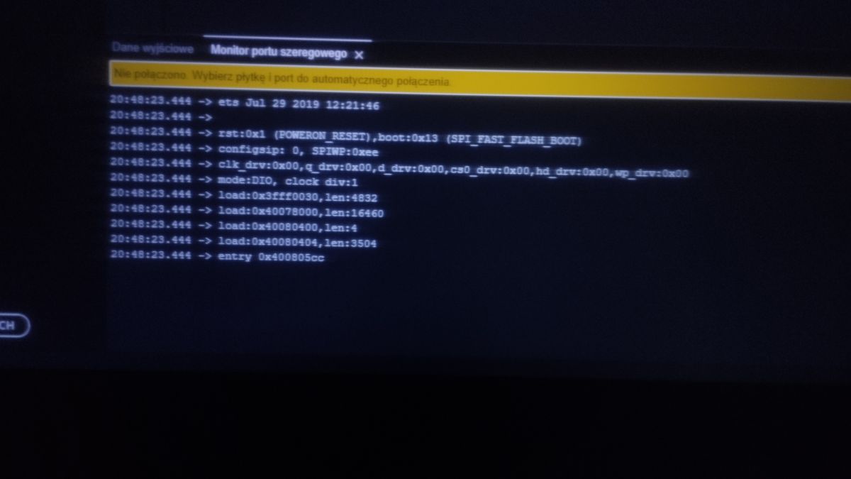

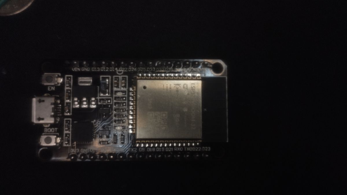

    Hi, I have recently started playing with the Esp32 wroom 32 V1 board, however lately the diode on the board has been flashing, and in the Arduino it goes on and off, as if it is resetting all the time. Is there any way to fix this, or is the only thing left to do is to buy a new board? If only buying, please give me some suggestions, I will add that I am interested in deuther projects and others of this type. Thank you for all the answers.

    It's not the power supply's fault, as I've tried powering it via USB (with a port from my laptop, a cube from the charger and a phone with an org adapter) and a tested battery with a 3.3V voltage regulator via the "VIN" pin on the board.
    I think the model is simply ESP32 Dev Board V1, it has 30 pins and says "ESP32S" on the back.

    Have you checked that it doesn't actually reset?

    I don't know how to check it other than that it keeps appearing and disappearing in the device manager.

    The Arduino Monitor shows what is happening at boot time.
  • #7 21270845
    michalwyk2
    The Serial Port Monitor only shows the message "Not connected", and only the "Esp32"/"Esp32 [not connected]" mark flashes alternately in the lower right corner. Only when I hold down and release the "EN" button does the terminal show: ESP32 WROOM 32 V1 - LED flashes, resets in Arduino IDE, what to do? ESP32 WROOM 32 V1 - LED flashes, resets in Arduino IDE, what to do? .

    And I've noticed that the voltage regulator is getting quite hot, so I'll check tomorrow to see if the power consumption jumps and other such.

    What settings do you have?
