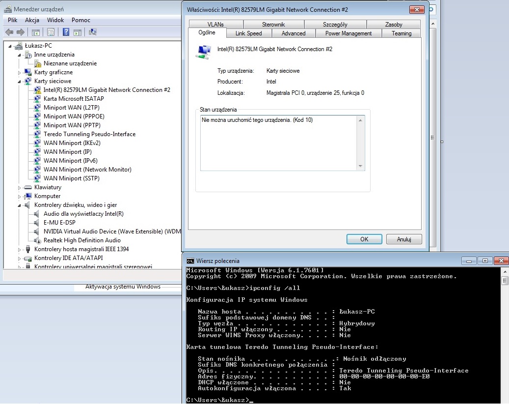

    I've had a problem with my Win7 64bit network adapter on my desktop PC for a long time. After turning on the computer, the network card does not work (red cross in the taskbar). After rebooting or after enabling and disabling the adapter driver in device manager everything works fine. The problem always appears when turning on the computer.
    I tried to reload the system and it still had the same problem.
    It appeared, most likely, after repairing the bios on the motherboard (replacing the BIOS chip)
    • intel - Network card - code 10 failed to start this device - strange s1.jpg (218.1 KB) You must be logged in to download this attachment.

    What is this computer? Do you have the latest bios uploaded now? You reset cmos and set everything up again?
    What is this unknown device and why didn't you install drivers for it?
    Do you have all the updates from WU installed?

    The unknown device is a sound card, therefore not 100%.
    The bios is uploaded good.
    What do the updates have to do with this, since the computer previously ran normally.

    I had similar problems with Intel cards on the Optiplex 7010 models (same card model seems to be). No witchcraft, no BIOS updates, no versions of the card and chipset drivers to help. As the hardware was under the seller's warranty, I was sent a new motherboard - and then, without any changes to the settings, the card started to work properly.
    The problems were roughly like this - system loading extended by 20-30 seconds, then code 10 in the manager. Sometimes the system loaded normally, the card worked. In the case of code 10, removal and redetection of the card with the reinstallation of the driver caused the card to work until the next restart. In the case of delayed start and code 10, the system logged an error in the event log about this situation (unfortunately I do not remember the exact content).
    An intermediate solution also worked - disabling the card in the BIOS (so as not to unnecessarily extend the start of the system) and adding another network card (in one model after the warranty, I was forced to do so).
