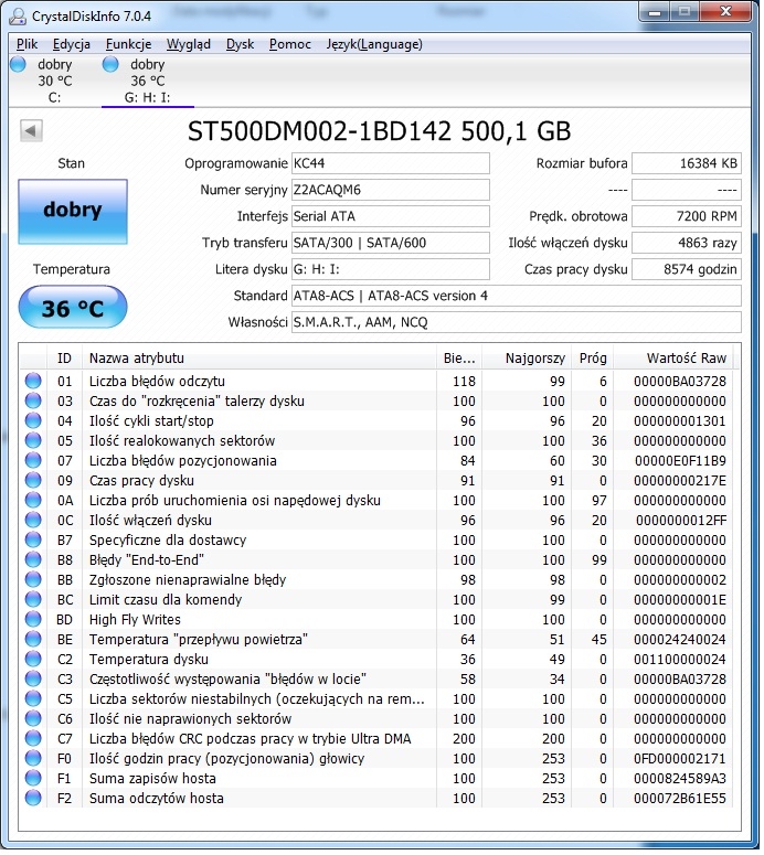

    A smart disk is attached.
    Power supply: HEDY 4002 Windows7 Startup Issue: System Repair Tool Fails to Automatically Fix & No Internet Connection

    Computer repaired. The Windows 7 operating system was damaged. The disk is in working order. I had to reinstall windows and reinstall all programs. It took a long time, but everything is OK.
    As for the power supply, it may not be brand-name, but it works for several years (I bought a computer in 2015). Maybe I found a good copy. During the last repair during copying, he had 3 SATA disks connected and a working SATA DVD drive. He pulled it all.
