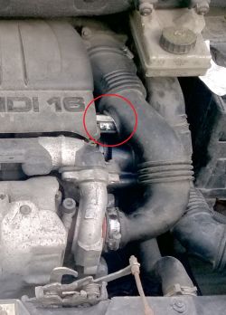

    Good morning,
    The problem is oil pouring on the engine from the combination of pneumothorax with the intake. The connection is press-fitted, sealed with an O-ring. Plastic-material seating. There may be a leak. I disconnected them and my engine oil is leaking. The car has about 160 kkm on the meter.
    This is normal for these engines, does this indicate a leakage at the bottom / valve seals?
    Initial I thought it was from the valve cover but not (only).
    You have some experience with these engines. The construction is successful, but maybe there is a flaw or a damaged copy.

    The place marked in red is an emphysema - and there is an oil separator in the head cover.
    Turns out it doesn't meet anymore and is releasing oil.
    The new head cover at ASO costs PLN 440.

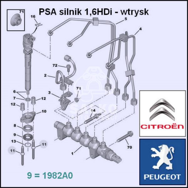

    #19 18583928
    Sebek961
    Rate: 7
    You're all right, but the fault here lies in the injector leaks. This causes emphysema and turbo.The part of the injector between the rubber seal and the copper seal is located under the valve cover. When it blows out the copper seal, the exhaust gases get under the valve cover, the pressure in the crankcase rises, the oil thaws and the diaphragm is damaged. Blow-off gases mix with the oil mist to form an oil sludge which then clogs the turbine lubrication tube and the engine falls asleep. To eliminate the cause, replace the complete injection seal and make sure that the oil is changed at least every 15 kkm, and preferably every 10 kkm. The problem is described in more detail here

    hmm, the author seems to have got it wrong. In this engine, the injector is not in any part under the valve cover and is not in contact with the oil. Yes, the design with the injector under the cover is, for example, in the tdi 1.6 2.0 from VW but not in the hdi

    This connection that you are writing about is an emphysema, it is normal in older cars worn out emphysema
    The entrance to the intake plug the exit from the pneumothorax, extend and release somewhere at the bottom of the engine so that the oil and exhaust gases escape there
    The emphysema is responsible for venting the crankcase, the excess pressure from the bottom of the engine is then removed, it is attached to the intake only for ecological reasons because it cannot be released for the engine / intake because oil leaks from there after some time and drips, and as you know leakage from the engine is forbidden by law due to environmental reasons
    As I mentioned, plug the hole in the intake and extend the exit from the pneumothorax to the engine

Can injector copper washers cause crankcase pressure?
On 1.6 HDi the injectors sit outside the cover; failed washers do not pressurise the crankcase, unlike some VW TDI engines [Elektroda, Arton, post #18584317]
