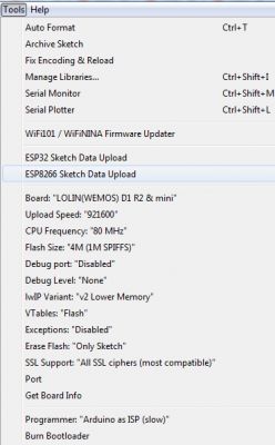

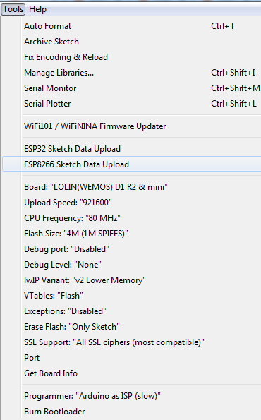

    Here is a tutorial on how to use the WIFI MANAGER library for ESP Link .
    Alternatively there is the FSBrowser NG project Link . The HTML local page is saved in regular HTML files. You need to have a file system upload plugin added to the ESP, this makes sense for flash larger than 1MB. Example you compile for FS (SPIFFS) at least 128kB (no larger than the contents of the DATA directory), upload firmware, upload web page files separately:
    How do I set the ESP8266 to AP mode for WiFi network selection on first startup? .
    Within the example is a set of sample files, if you save the example AS, there is a DATA folder added in its directory, inside are sample HTML files - WIFI configuration, adding a password, updating firmware from a browser, etc. bits and pieces:

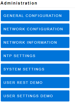

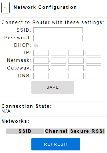

    The first time you start up, you connect to the module set to AP+ST mode, go to 192.168.4.1/admin, then from the network settings menu and select the network parameters as if you were using a smartphone:
