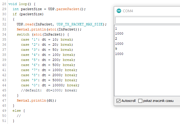

    I've wrapped up UDP both ways, just as I wanted. Now I have a problem. The AP sends commands 1 to 9 to the sensor, and the sensor is supposed to respond by assigning a value to the dt variable. Why this is not working is beyond me!
    ESP8266 - Changing the SSID and password of a Wi-Fi network without software intervention .
    Communication works, commands arrive, it works up to line 33 of the code. What is displayed on COM4 is the result of running 33 and 47 lines of code. The value 1000 is displayed because dt was declared at the beginning as: short int dt = 1000; Although commands are recognised no value is assigned to dt :-( .
    help

    The obvious. The worst thing is to check your mistakes. Thanks to
