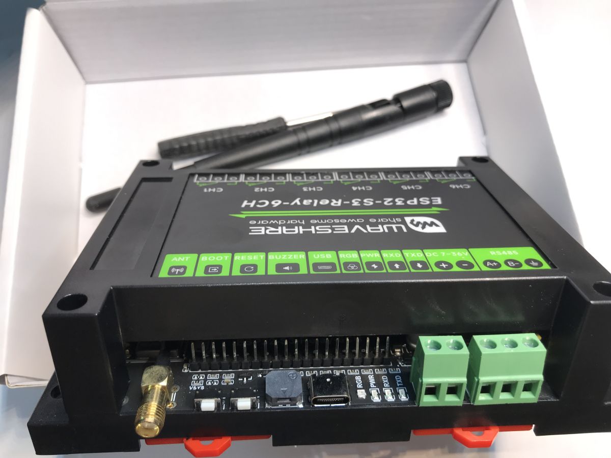

    Unboxing
    Let's see what's in the box. It seems that antenna and small screwdriver are included.
    Waveshare ESP32-S3-Relay-6CH controller with ports and connectors in a box

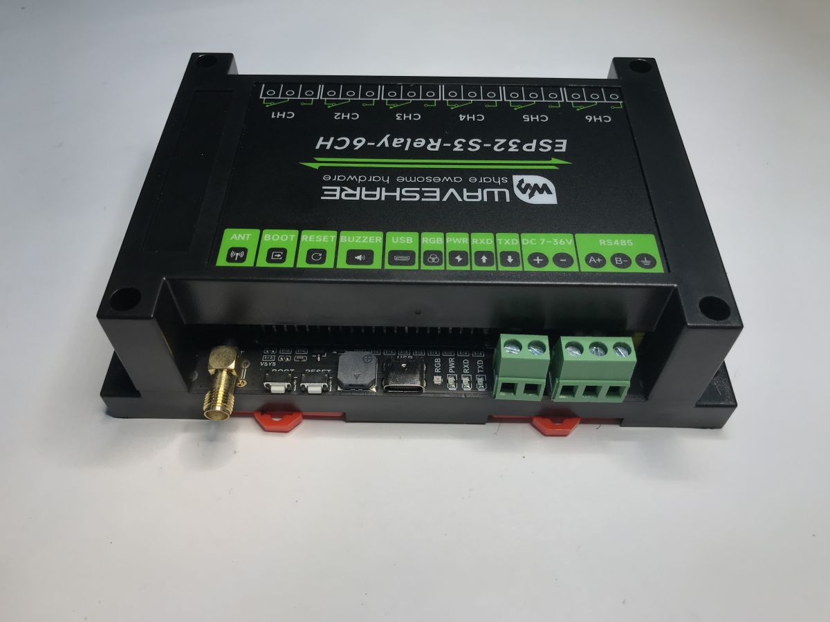

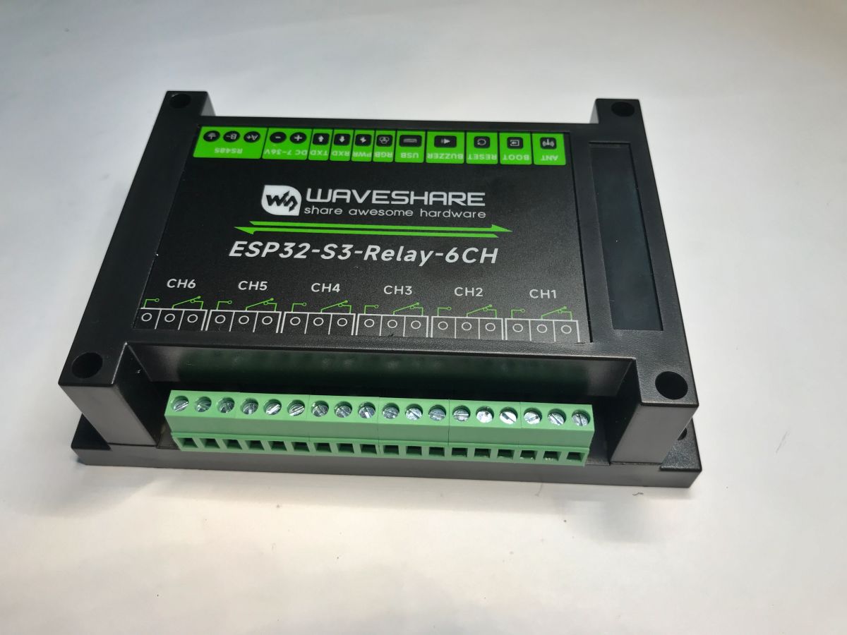

    The module is fully encased and all IO terminals are labeled. Relays are on the front side, each has three terminals (both normally open and closed):
    Waveshare ESP32-S3-Relay-6CH relay module with six green terminal channels

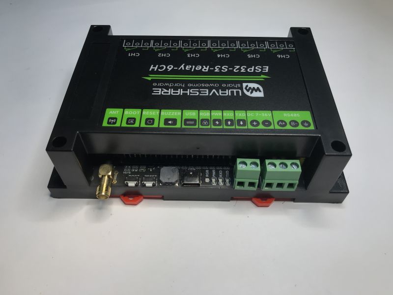

    On the rear side, you have antenna connector, boot and reset buttons, buzzer, USB connector, RGB diode, status LEDs, power terminal and RS485.
    WaveShare ESP32-3S-Relay-6CH controller with visible connectors and function labels

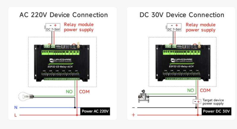

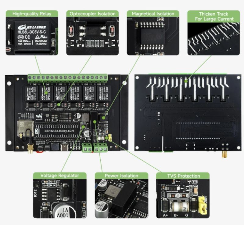

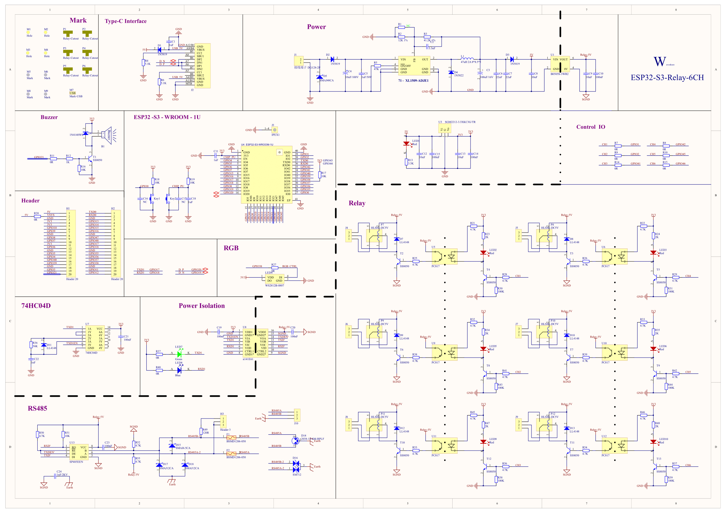

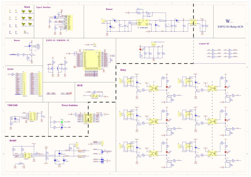

    Here is the board schematic - it shows which GPIOs are used for features like relays, WS2812 or which extra GPIOs are available inside.
    Electronic schematic of ESP32-S3 module with interfaces, relays, and power supply
    ESP32-S3 relay board with 6 relays, isolation features and protection components shown

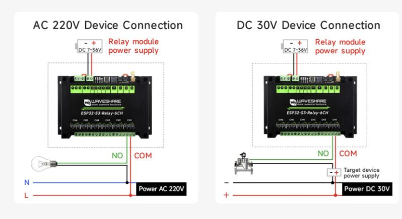

    Wiring diagram for ESP32 relay module with AC 220V and DC 30V devices
    ESP32-S3 board with RS485 interface and 40-pin Raspberry Pi Pico HAT header

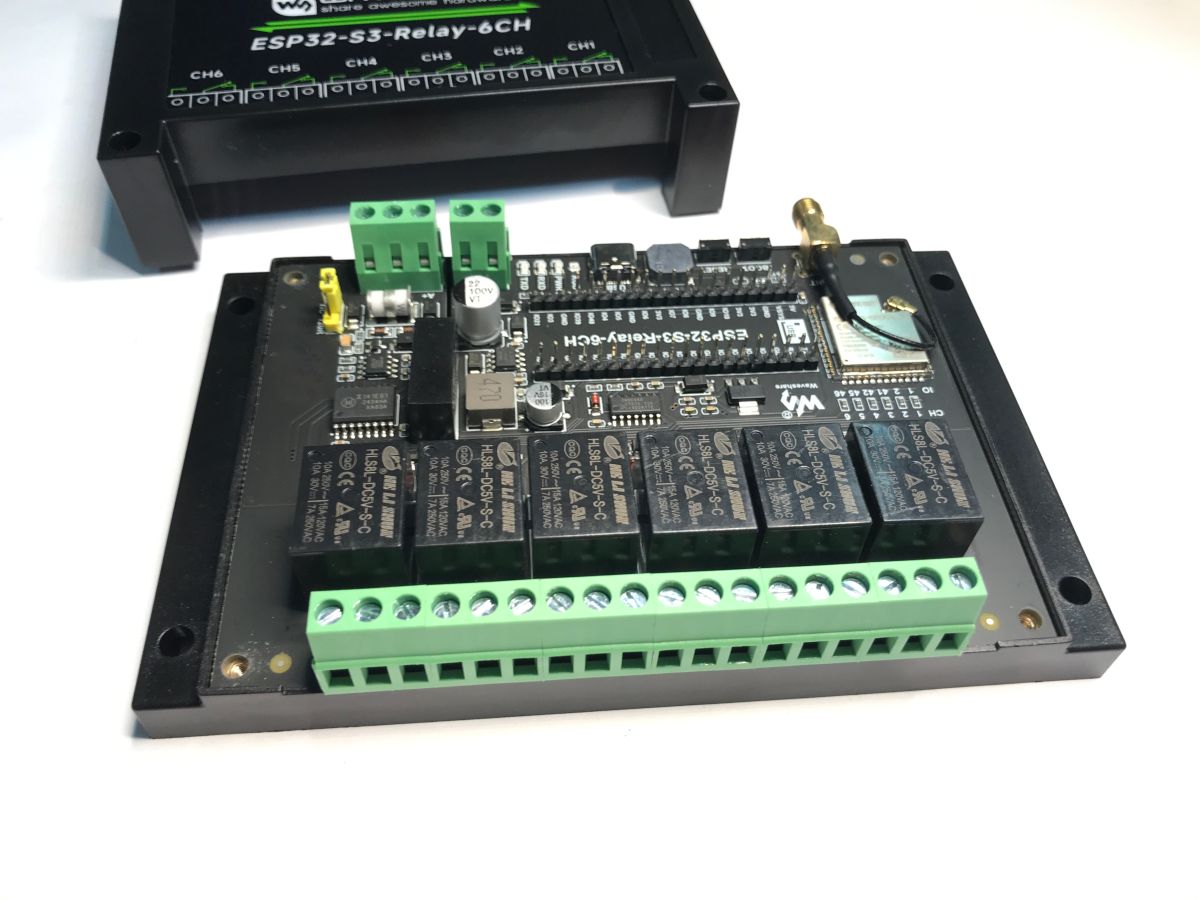

    Quick teardown

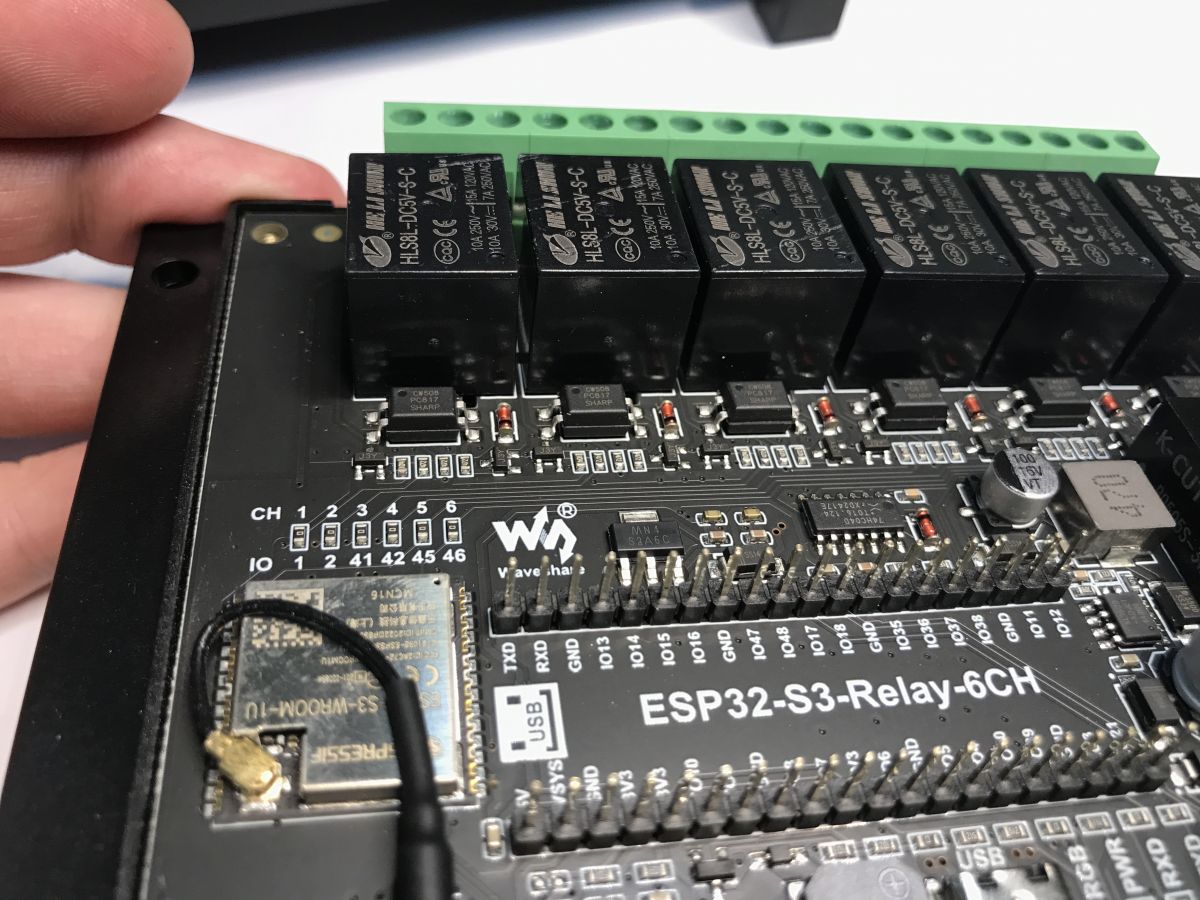

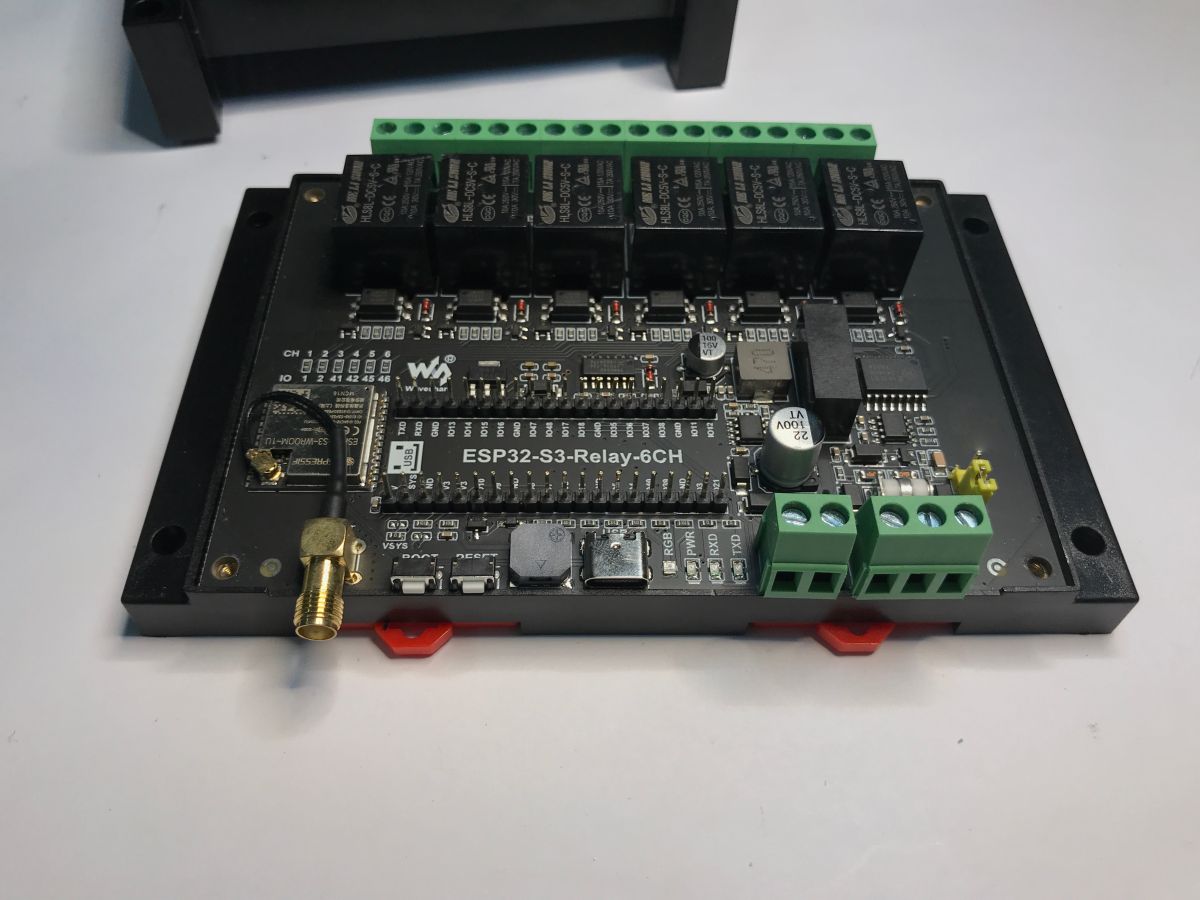

    This is not needed for flashing and usage, but it's always interesting to check how things are made. You can unscrew the cover with the screwdriver that is included in the set.
    ESP32-S3 module with 6 relays and green terminal blocks

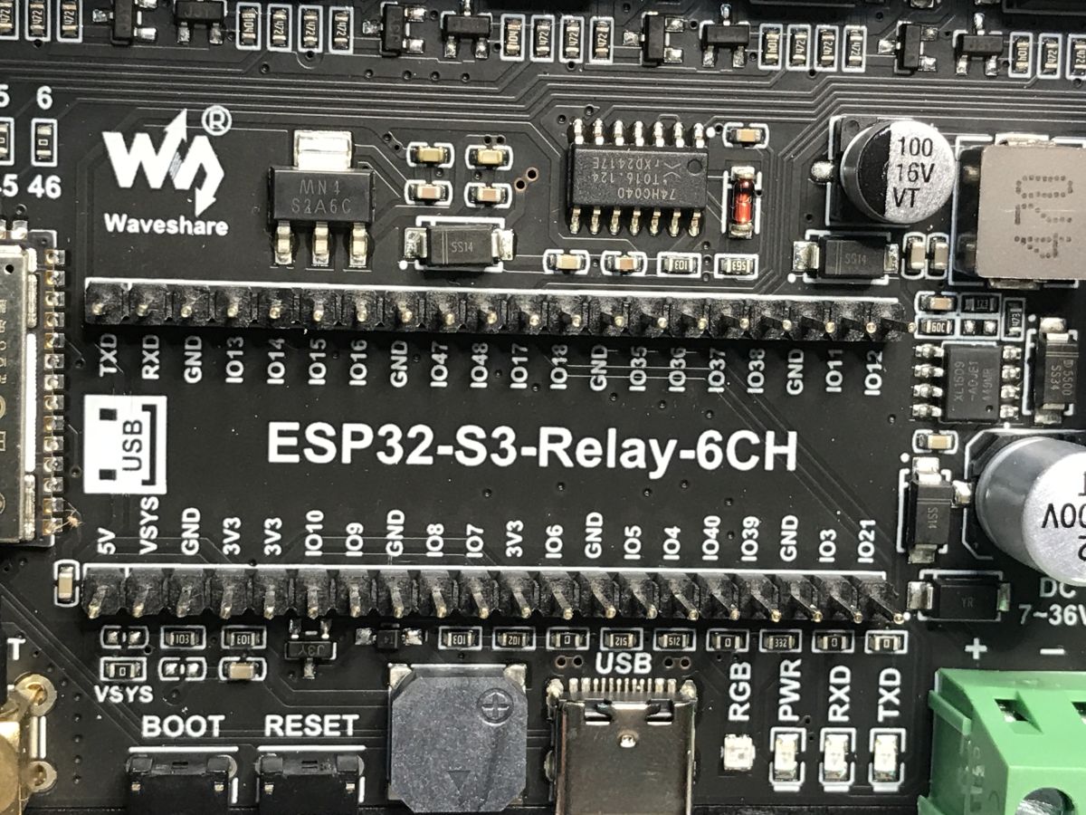

    The device is made mostly out of surface mount components. There are two extra 2.54mm pin headers inside, which can be used to route out GPIO. They are compatible with Raspberry Pi Pico Hats.
    ESP32-S3 board with relay module and green terminal connectors
    Some closeups:
    ESP32-S3 board with six relays and screw connectors visible Close-up of ESP32-S3 relay board with relays, capacitors, and labeled pins Waveshare ESP32-S3-Relay-6CH board with labeled pins and electronic components Close-up of a circuit board with labeled IC and SMD components

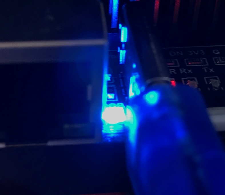

    Close-up of USB cable and blue LEDs on an electronic board with labeled connections
    NOTE: This particular photo is taken from the similar Waveshare board, but the one in the topic was tested as well.

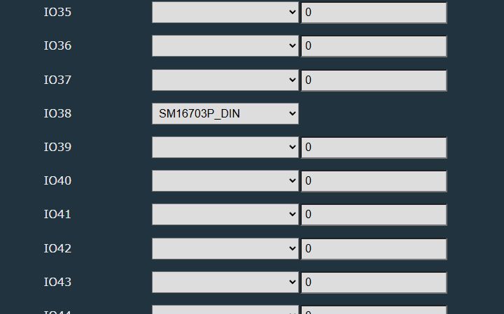

    The video does not cover it, but WS2812 can be also controlled in OpenESP. Just set pin role:
    Configuration interface with dropdowns and value fields for IO35–IO44
    and setup driver:
    startDriver SM16703P
    SM16703P_Init 1 GRB
    SM16703P_SetPixel 0 255 0 0
    SM16703P_Start
    startdriver pixelanim

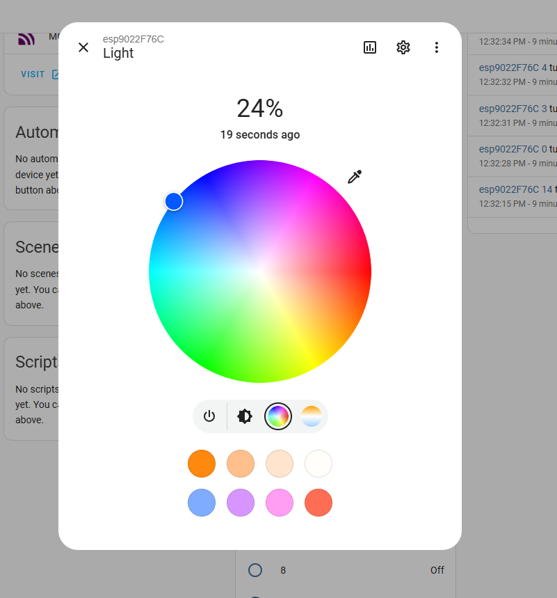

    This way you can also get this to HA, but you must run HA discovery after running the script.
    Light control interface with color wheel and 24% brightness level

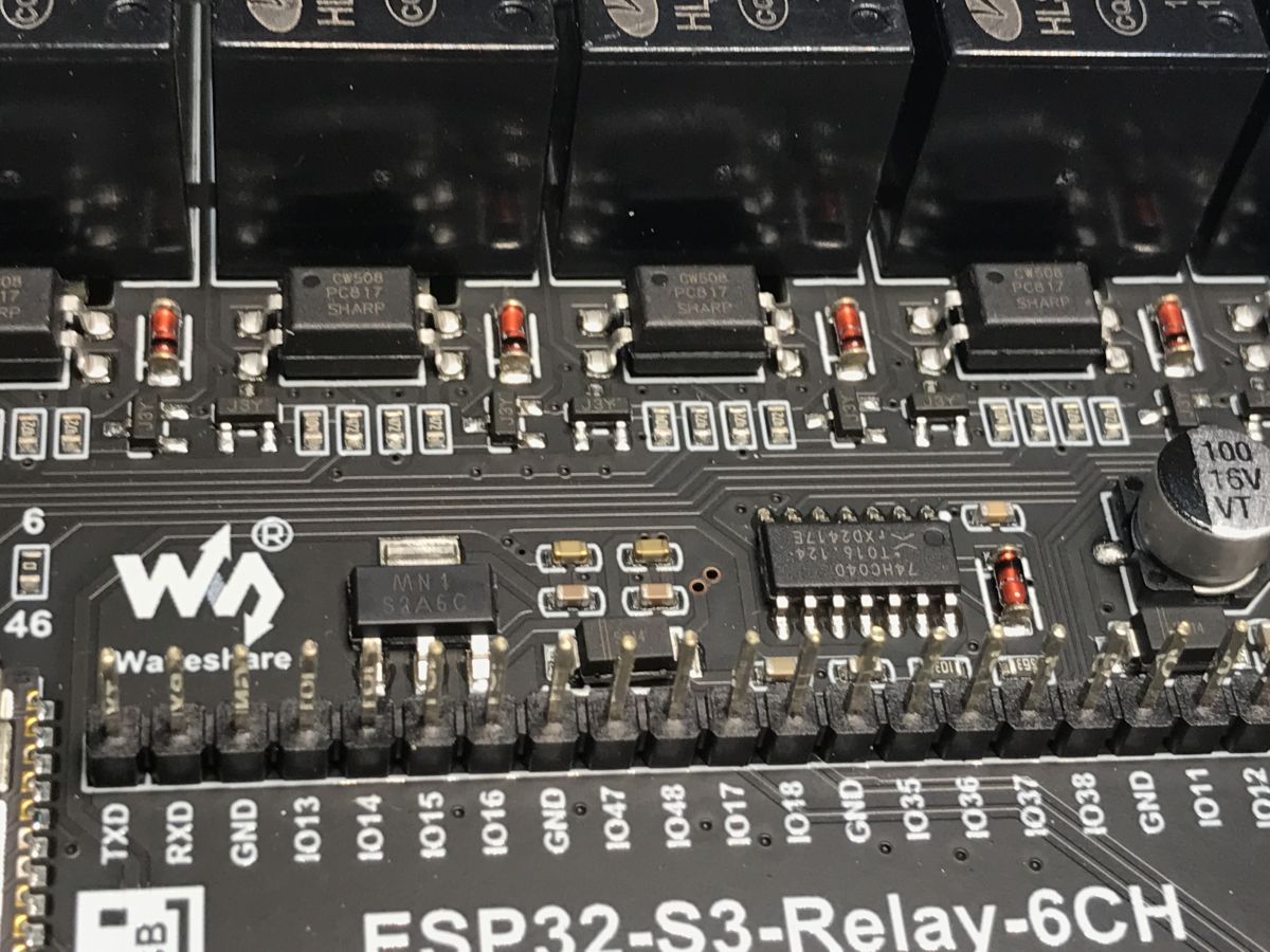

    Perhaps someone knows - why do the Chinese, so renowned for their economy in electronics, use opto-isolation for relays? Even their cheap executive modules have opto-isolation.

    That's what I thought too, but the "secondary side" of the optoisolation is fed from the same voltage as the "primary".

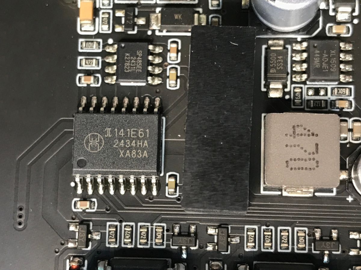

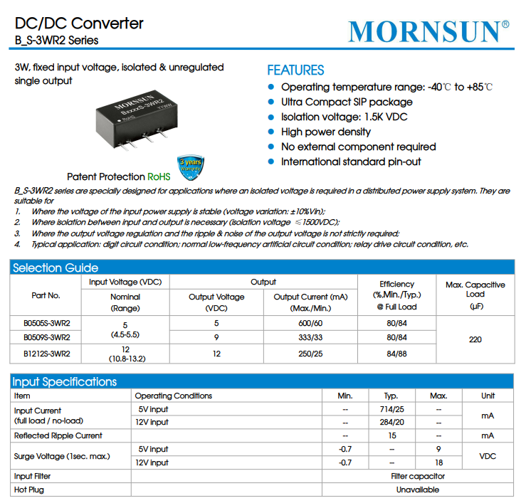

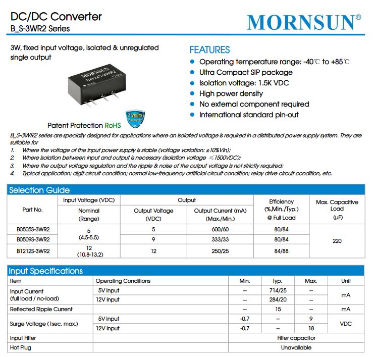

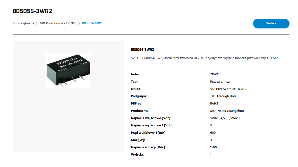

    @krzbor see the Power section and how the schematic is partitioned. There is a B0505S-3WR2 there and it powers a separate Relay-5V line while maintaining galvanic isolation.
    Mornsun B0505S-3WR2 DC/DC module in black SIP case with five metal pins. .
    Mornsun B0505S-3WR2 DC/DC converter datasheet with electrical specifications .
  • Galvanic isolation uses B0505S-3WR2 and optocoupler chain

    There is a B0505S-3WR2 and it feeds a separate Relay-5V line while maintaining galvanic isolation.
    You're right - I hadn't noticed that. That is, to drive the relay from the I/O output of the processor we have: an isolated DC/DC converter, an amplifying transistor for the optocoupler diode, an optocoupler, an amplifying transistor for the relay coil and a fair handful of passive components. It looks as if someone does not believe that the relay itself provides galvanic isolation.
