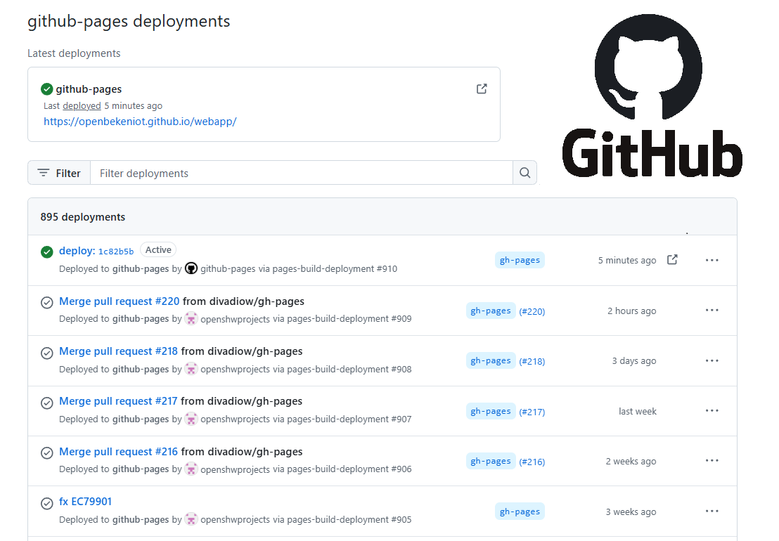

  • GitHub Pages deployments panel showing recent commits and deployed link .

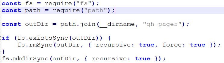

    Minimal example, deletion section:
    Screenshot of JavaScript code clearing and recreating the gh-pages directory .

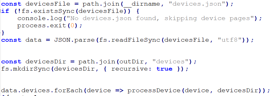

    Loading JSON, creating a folder for the devices and iterating:
    Node.js code snippet loading devices.json and processing devices

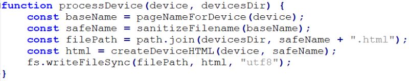

    Device processing function:
    JavaScript code snippet generating HTML files for IoT devices
    pageNameForDevice converts the name of the manufacturer and model of the device into a page name, and sanitizeFilename makes sure it is file system friendly. Not all characters can be in file names. We are left with createDeviceHTML. Here is an example implementation:

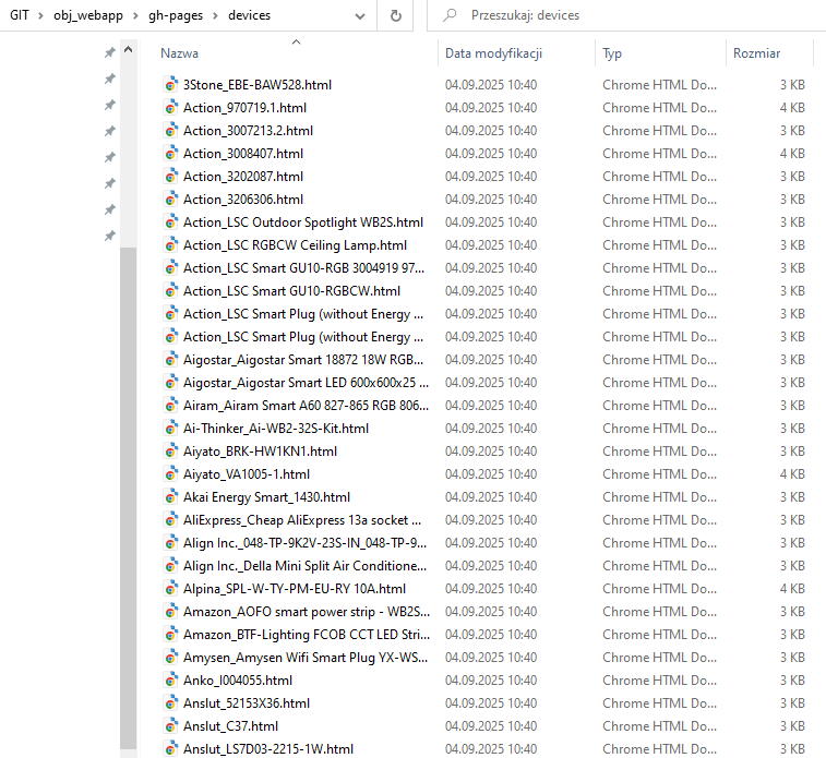

    The whole thing should execute correctly and generate files for our JSON database:
    Screenshot of devices folder with HTML files generated for individual devices .

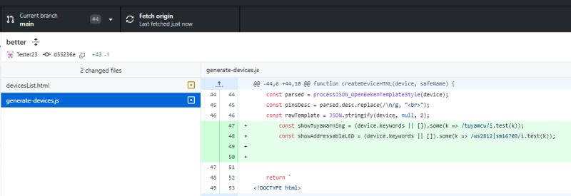

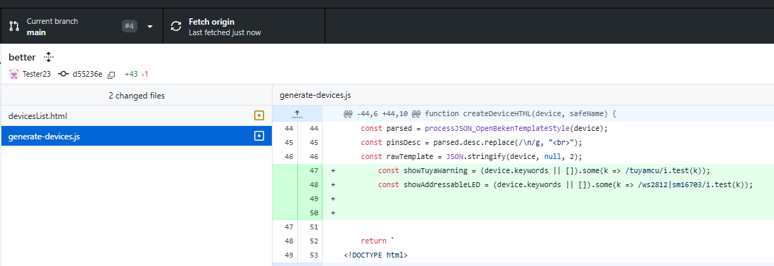

    Let's see how this works in practice. I've added some changes via the GitHub GUI:
    GitHub editor view showing changes in generate-devices.js file .

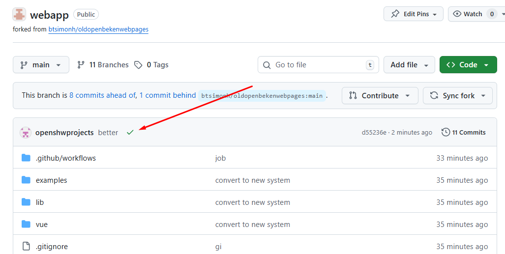

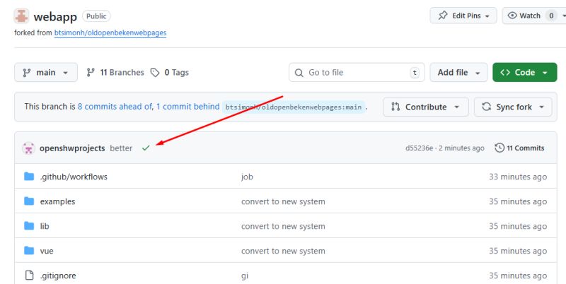

    A commit with a "bird" appears on GitHub:
    Screenshot of GitHub repository “webapp” with active “main” branch shown .

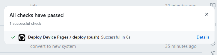

    In the preview we have information about the success of the deploy operation:
    GitHub Actions notification: Deploy Device Pages completed successfully .

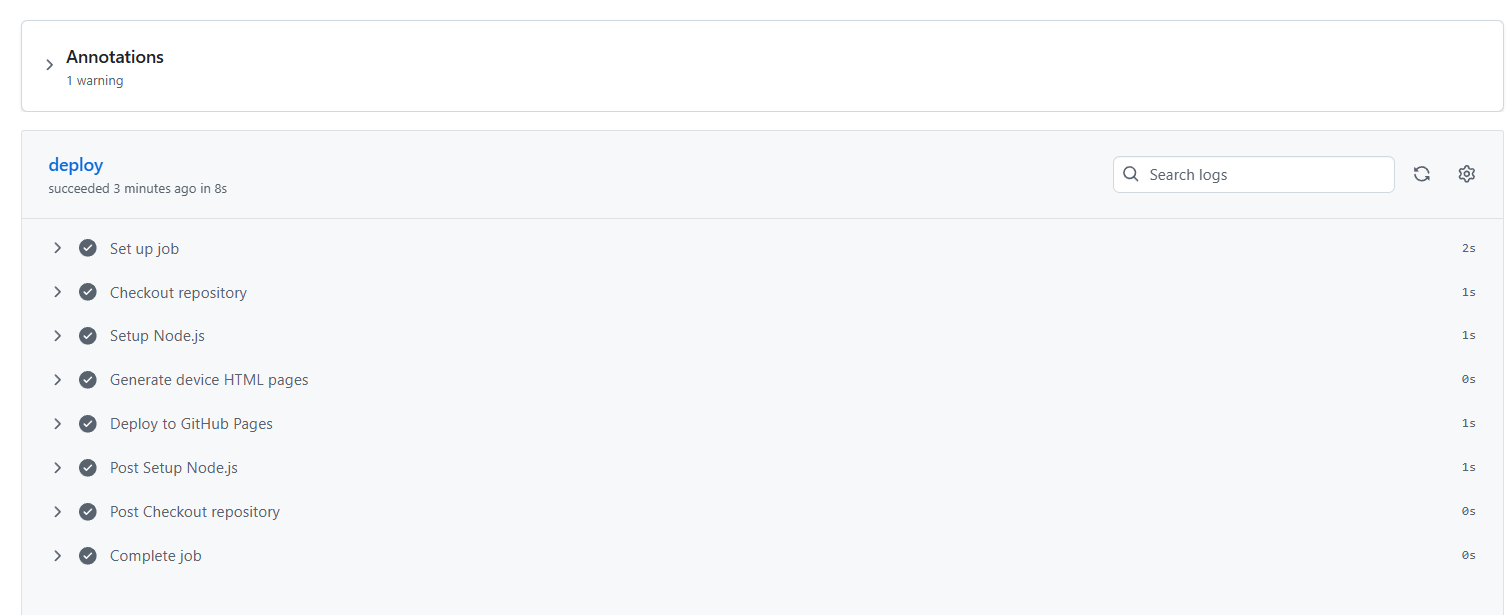

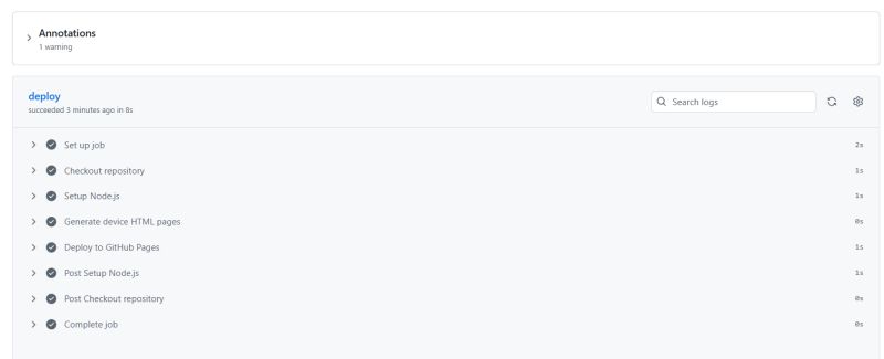

    In the details we have the entire log of the operation:
    View of completed GitHub Actions job showing step list and execution times .

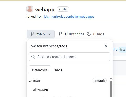

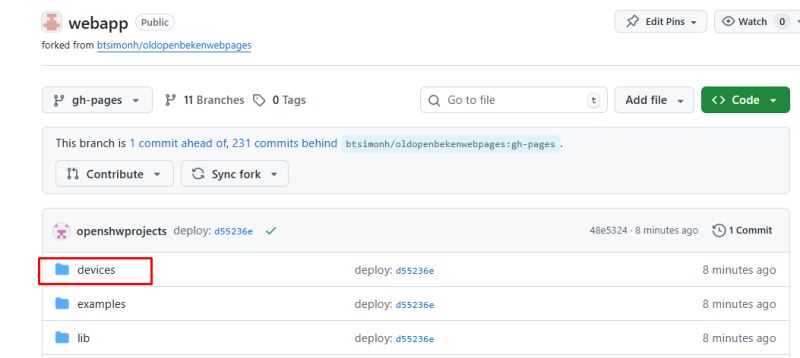

    Now we can look at the gh-pages branch:
    Dropdown menu showing main and gh-pages branches in a GitHub repository .

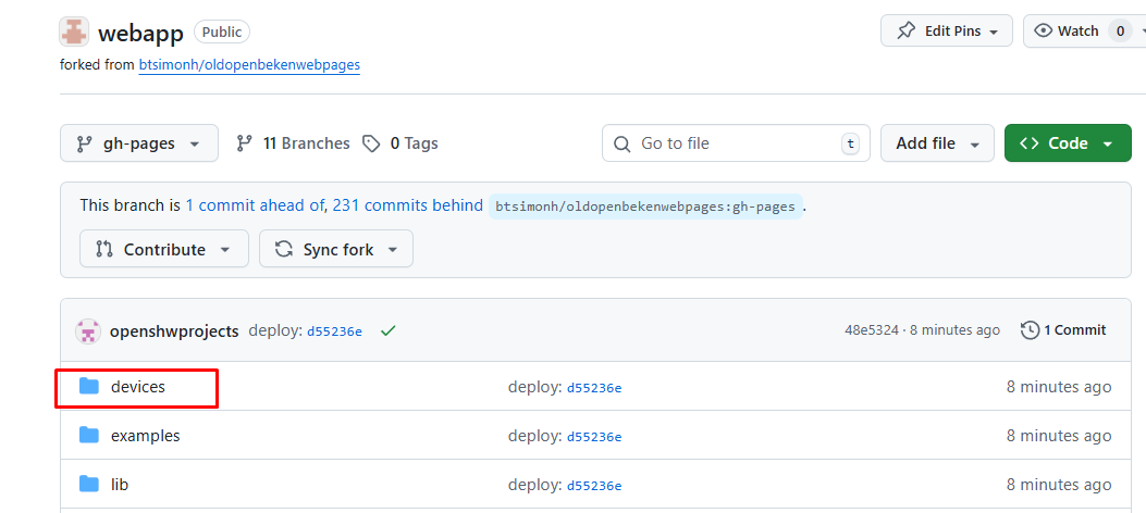

    There is a devices folder generated on it:
    GitHub repo view showing “devices” folder in the gh-pages branch .

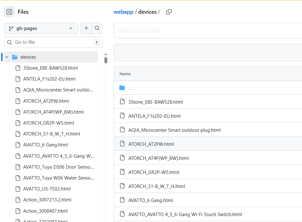

    Our HTML files are also in it:
    List of device HTML files in the devices folder on the gh-pages branch on GitHub .

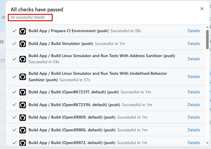

    And let's not forget GitHub Actions - it's an equally powerful tool. GitHub Actions essentially provides us with a clean virtual machine with a repository where we can perform any operation, including compiling firmware. Linux machines are available, as well as Windows machines.
    It is in GitHub Actions that my firmware compilations for IoT devices are created:

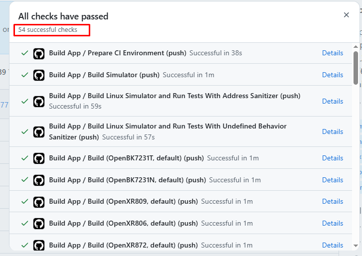

    Any change to the repository results in compilations for platforms such as BK7231T, BK7231N, BK7231M, BK7231U, BK7238, BK7252, BK7252N, XR809, XR806, XR872, BL602, W800, W600, LN882H, TR6260, RTL8710A, RTL8710B, RTL87X0C, RTL8720D, RTL8721DA, RTL8720E, ECR6600, ESP32, ESP32-S2, ESP32-S3, ESP32-C2, ESP32-C3, ESP32-C5, ESP32-C6, ESP32-C61, ESP8266, TXW81X and Windows (Simulator). In total (with some additions) this is up to 54 operations running on GitHub virtual machines:
    List of 54 successful GitHub Actions checks for firmware build process .
    This is very convenient, as I can't imagine compiling these dozen or so binary files manually for each new firmware release.

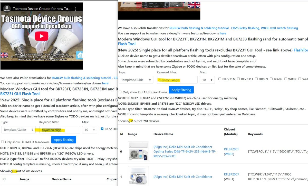

    I've been vibe coding with overrides.
    Here's a summary of changes seen in here https://github.com/divadiow/OpenBekenIOT-webapp/blob/main/devicesList.html
    Dropdown list with chip selection and table of devices with names and images
    Website showing TuyaMCU device list and flashing tools with filter applied
    addresses some of these maybe https://github.com/OpenBekenIOT/webapp/issues

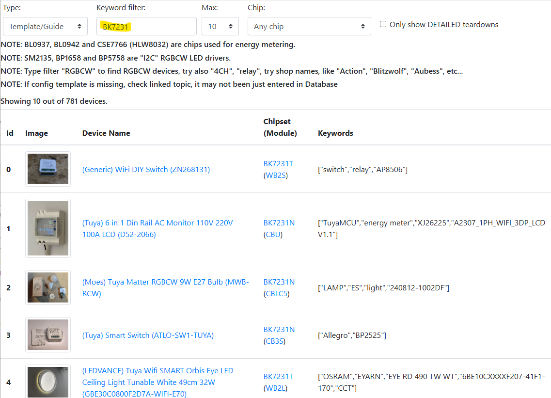

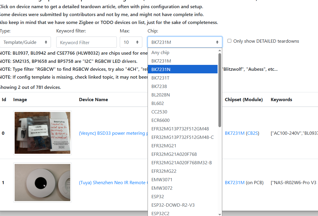

    not bad... would it work if I type "BK7231" in search box? Show only BK7231 T and N devices? And U... if present.
  • #8 21654228
    Posts: 5236
    Help: 450
    Rate: 920
    seems so
    Device list with BK7231 chip shown in table with images and technical details

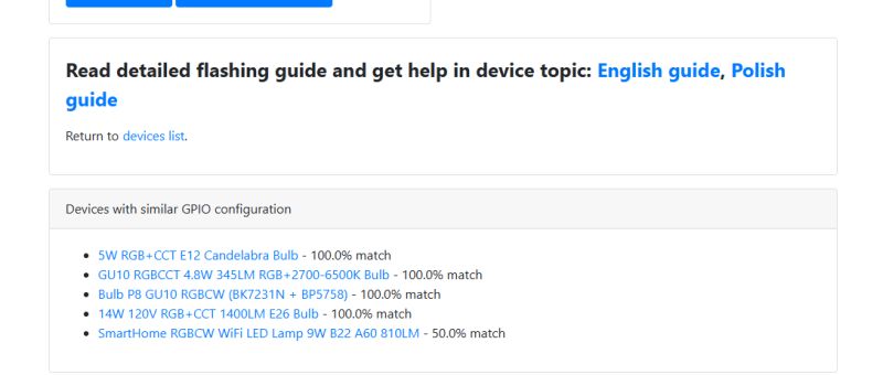

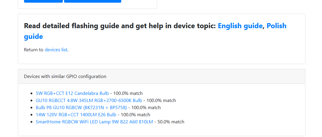

    I am also trying to improve it - next idea is to display similar devices:
    List of GPIO-compatible devices and links to English and Polish guides
