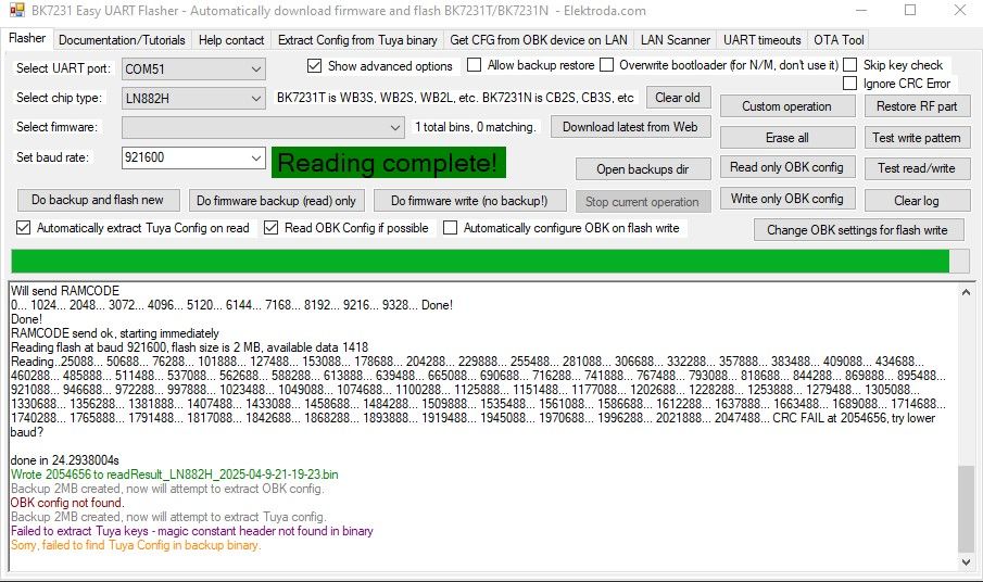

  • A9 was grounded for UART download mode, the backup used TX at 2000000 baud, and A5/A6 traced to the LED disc's BP5758D DAT and CLK lines.
  • Easy Flasher backed up the original firmware, the bulb booted from the backup, and OpenLN882H then broadcast an AP at 192.168.4.1 and joined home Wi-Fi.

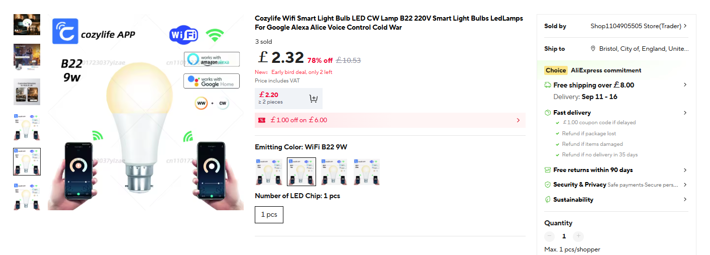

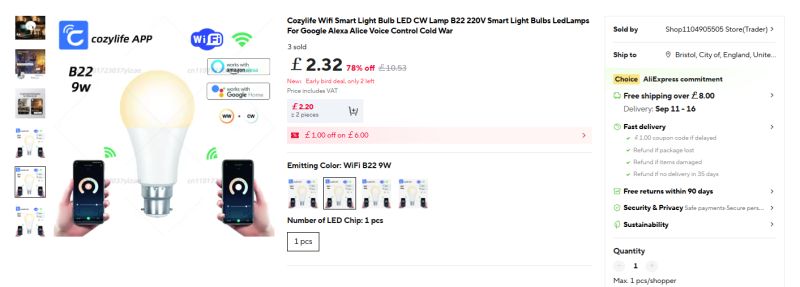

  • Here's a swift tour of a basic CozyLife B22 9W CW/WW LED bulb bought from Ali Express
    Smart LED bulb B22 9W with app control and Wi-Fi connectivity
    https://www.aliexpress.com/item/1005009804894661.html
    The box gives the impression it's an RGB bulb, but it's just a generic box that's been seen with many varieties of bulb. This device is cold white/warm white.
    White LED light bulb with bayonet cap lying on a wooden surface Open box with a GU10 bulb seen from above, showing metal connector pins. Smart Bulb package with RGB color and 2700–6500K adjustable white light Colorful Smart Bulb box showing RGB lighting and color temperature range
    Box of RGB WiFi LED smart bulb B22 9W compatible with Google Alexa

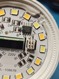

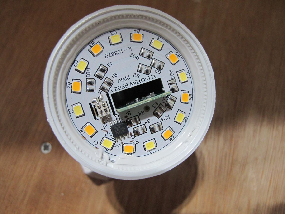

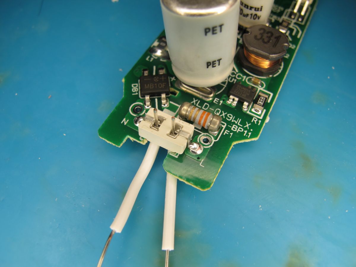

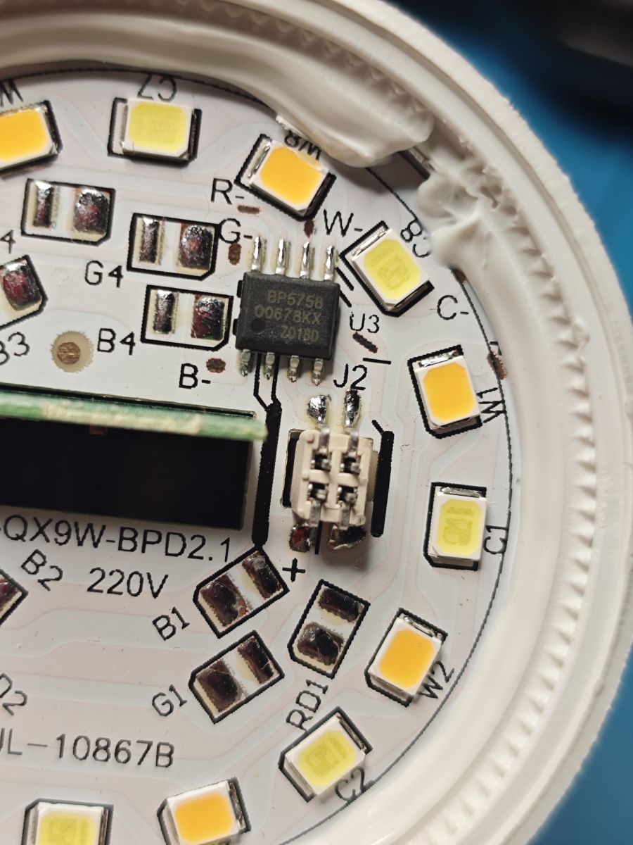

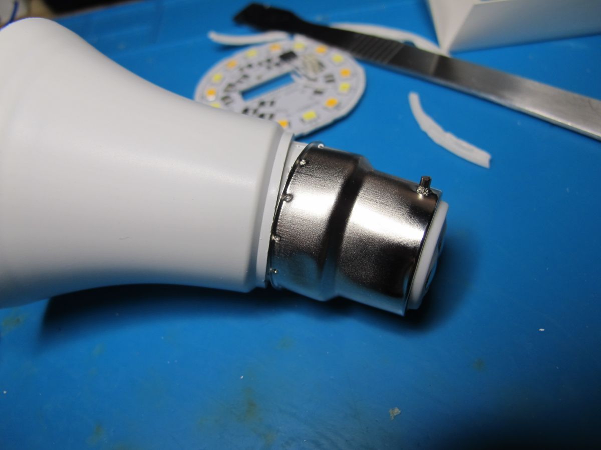

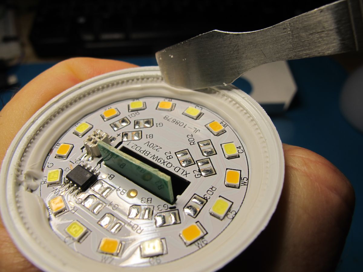

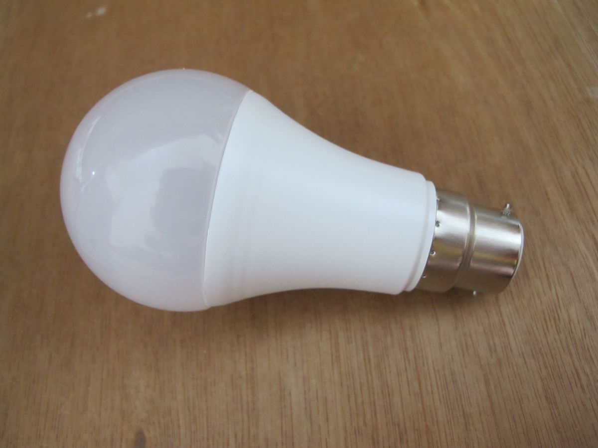

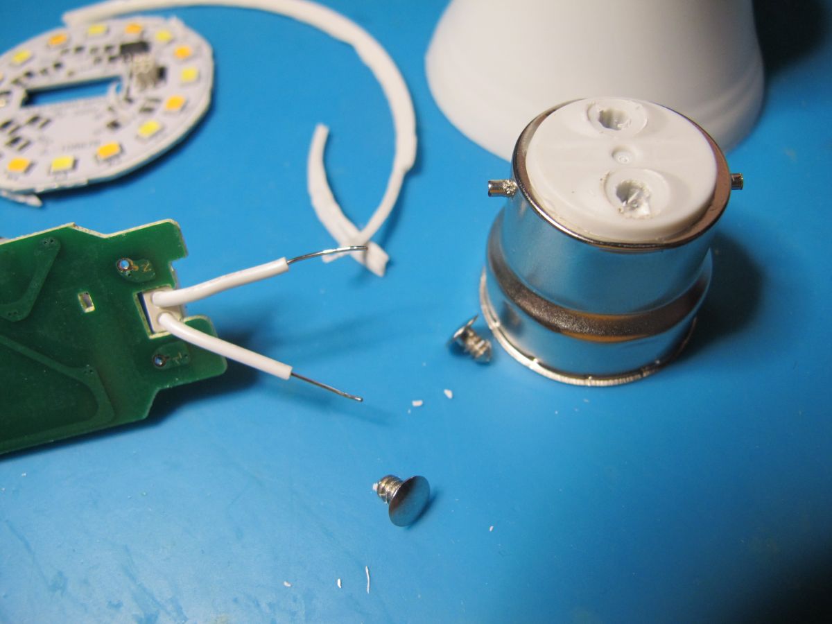

    No markings on the exterior of the bulb at all. With reasonable force the dome can be popped off by hand, the silicon removed with a spudger and the positive/neutral lugs at the base lifted out with a scalpel.

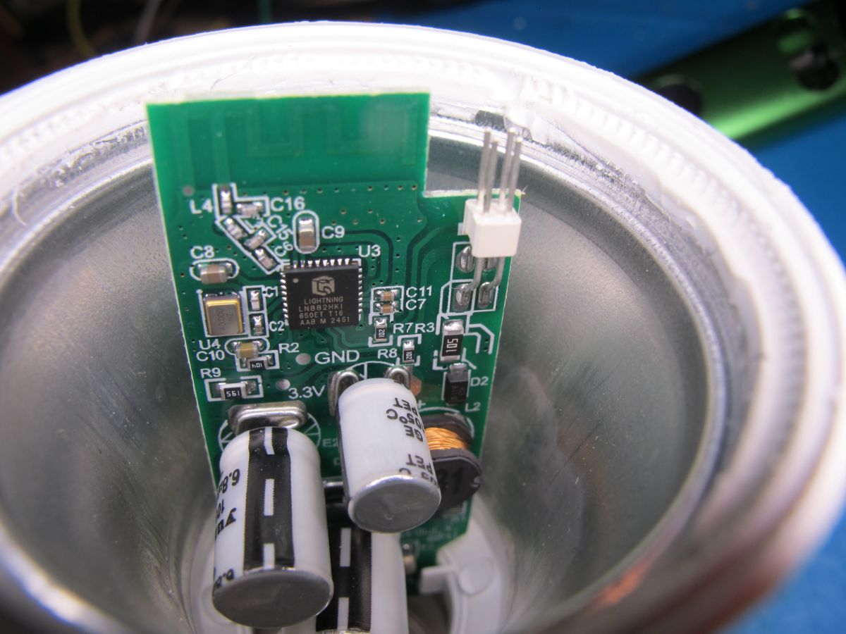

    Close-up of LED lamp interior with circuit board and multiple LED elements Disassembled LED bulb showing internal electronics and mounting components
    Close-up of LED circuit board with SMD LEDs and BP5758 IC Close-up of green PCB with microcontroller, capacitors, and a PCB antenna. Close-up of green PCB with LIGHTNING LNB82HK1 chip and SMD components Green circuit board with visible traces and two connected white wires on a blue surface Close-up of circuit board with capacitors, inductor, and integrated circuits Electronic circuit board with electrolytic capacitors and SMD components Close-up of PCB with capacitors, resistor, and MB10F bridge rectifier Printed circuit board with capacitors, a chip, and an integrated PCB antenna Disassembled LED bulb with metal base and internal parts on blue background Close-up of PCB with electronic components inside an LED lamp housing Close-up of an LED bulb's internal circuit board with LEDs and components.

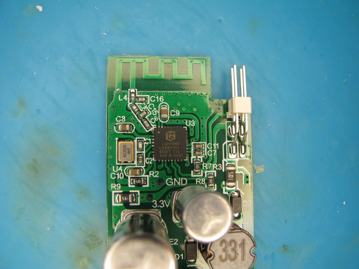

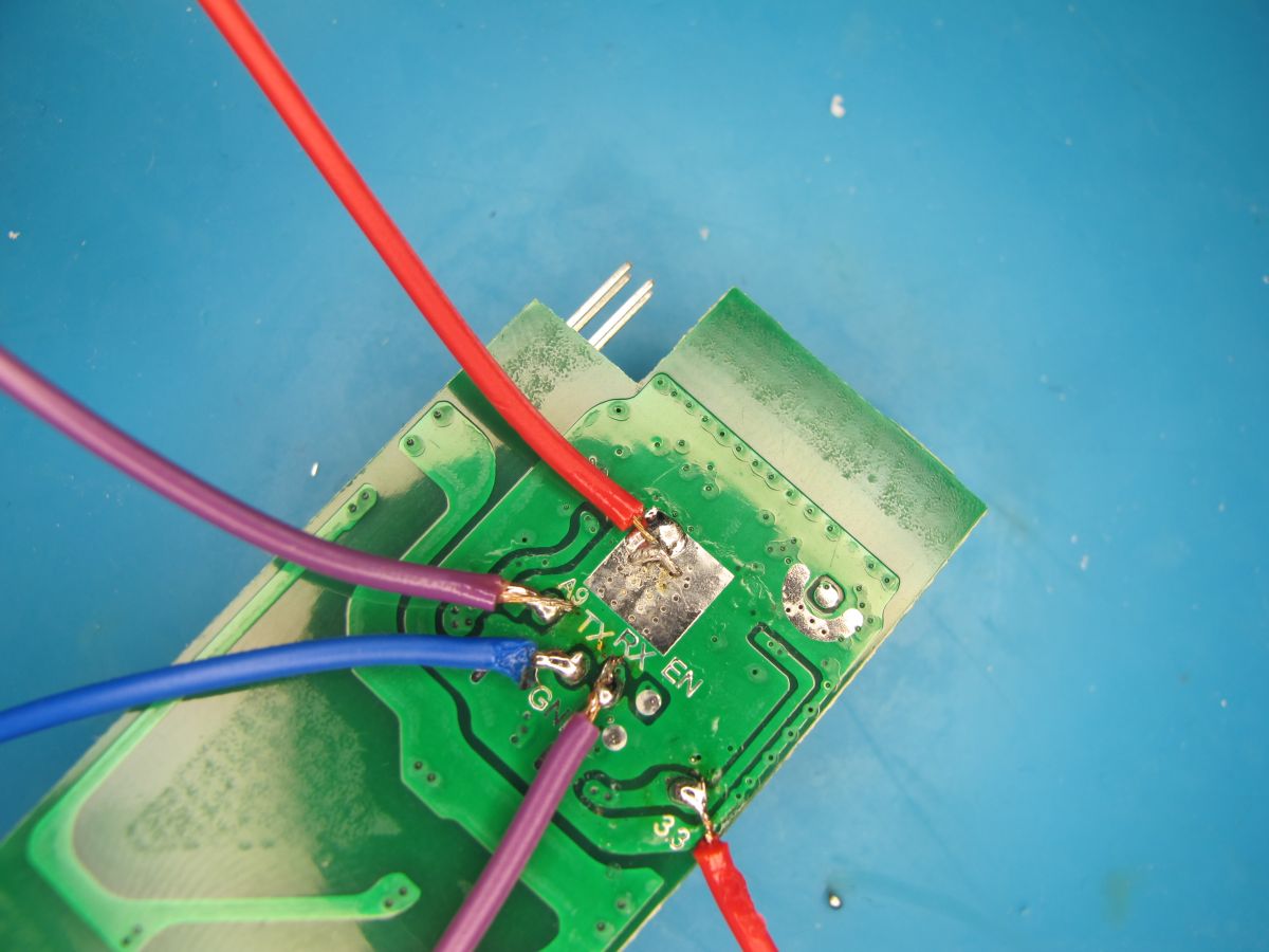

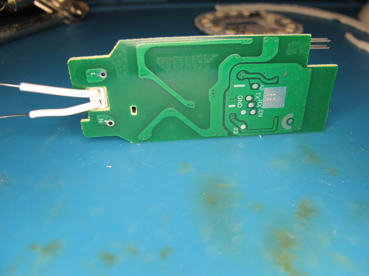

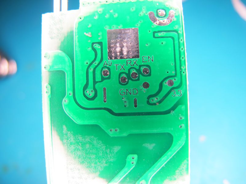

    A9, RX, TX, GND and 3V3 are nicely labelled on the rear of PCB
    Close-up of green circuit board with labels TX, RX, GND, and 3.3
    soldered-up ready for flash backup and programming of OpenLN882H
    PCB with soldered wires in various colors on a blue surface

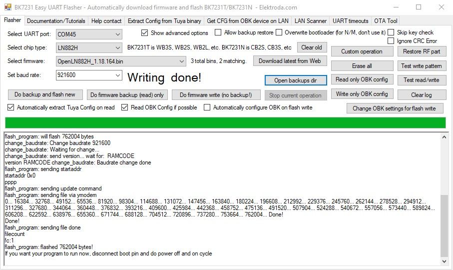

    boot log from TX at 2000000 baud
    A9 grounded for UART download mode, Easy Flasher takes backup
    BK7231 Easy UART Flasher interface with Reading complete! message

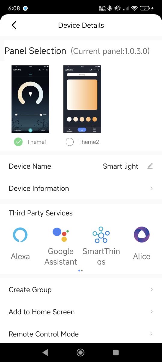

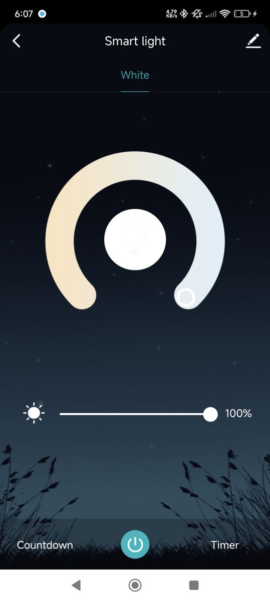

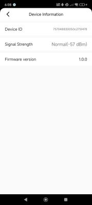

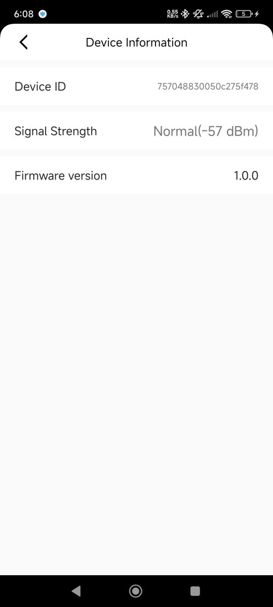

    backup flashed to dev board to be sure it was a good backup. It boots and can be paired with CozyLife app
    Smart lighting app screen set to white mode with brightness at 100%. Settings screen showing device ID, signal strength, and firmware version Smart light app screen with control panel theme selection and integrations
    A9 still grounded Easy Flasher programs OpenLN882H to flash
    BK7231 Easy UART Flasher interface showing successful firmware flashing log

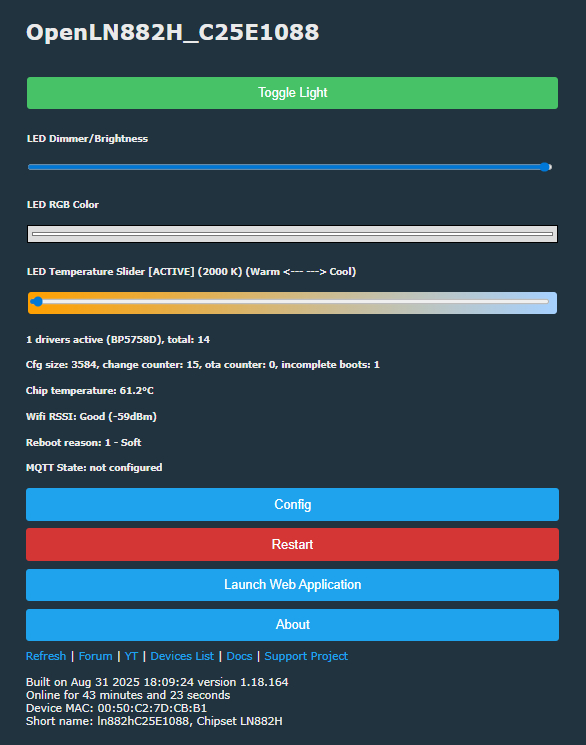

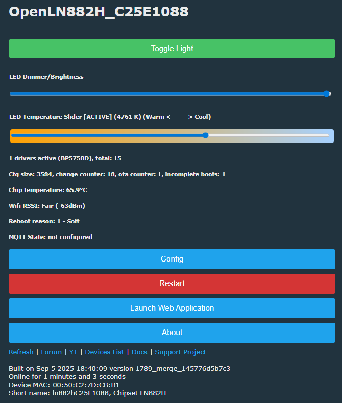

    OBK boots, AP broadcast, accessed at 192.168.4.1 when connected as a client, join home wifi.

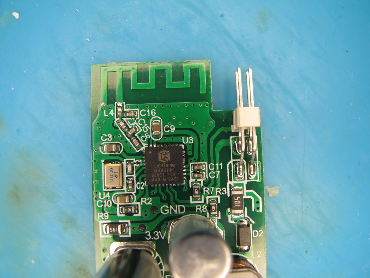

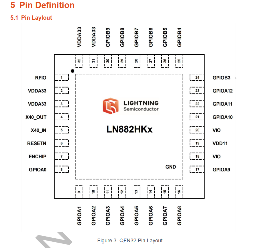

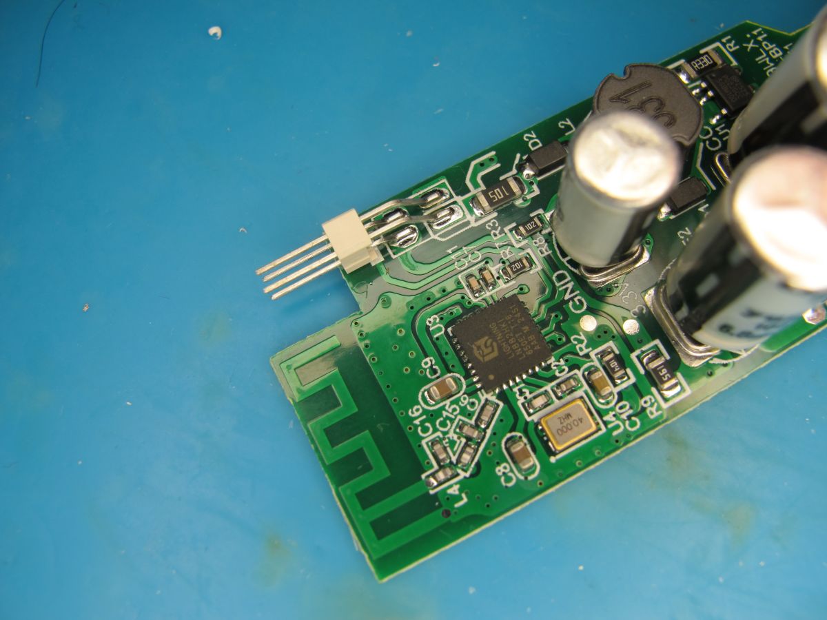

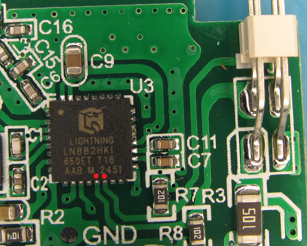

    We see in a close-up picture that A5 and A6 are tracing to the 4 pins that go to the LED disc. These two will be CLK and DAT lines for the BP5758 controller chip on the disc.
    Close-up of LIGHTNING LN882HKI chip on green PCB with SMD components
    Pin layout diagram of LN882HKx chip in a QFN32 package
    A5 = BP5758D_DAT
    A6 = BP5758D_CLK

  • Questioning the cost savings of unused BP5758 channels
    #2 21653834
    Posts: 14755
    Rate: 12880

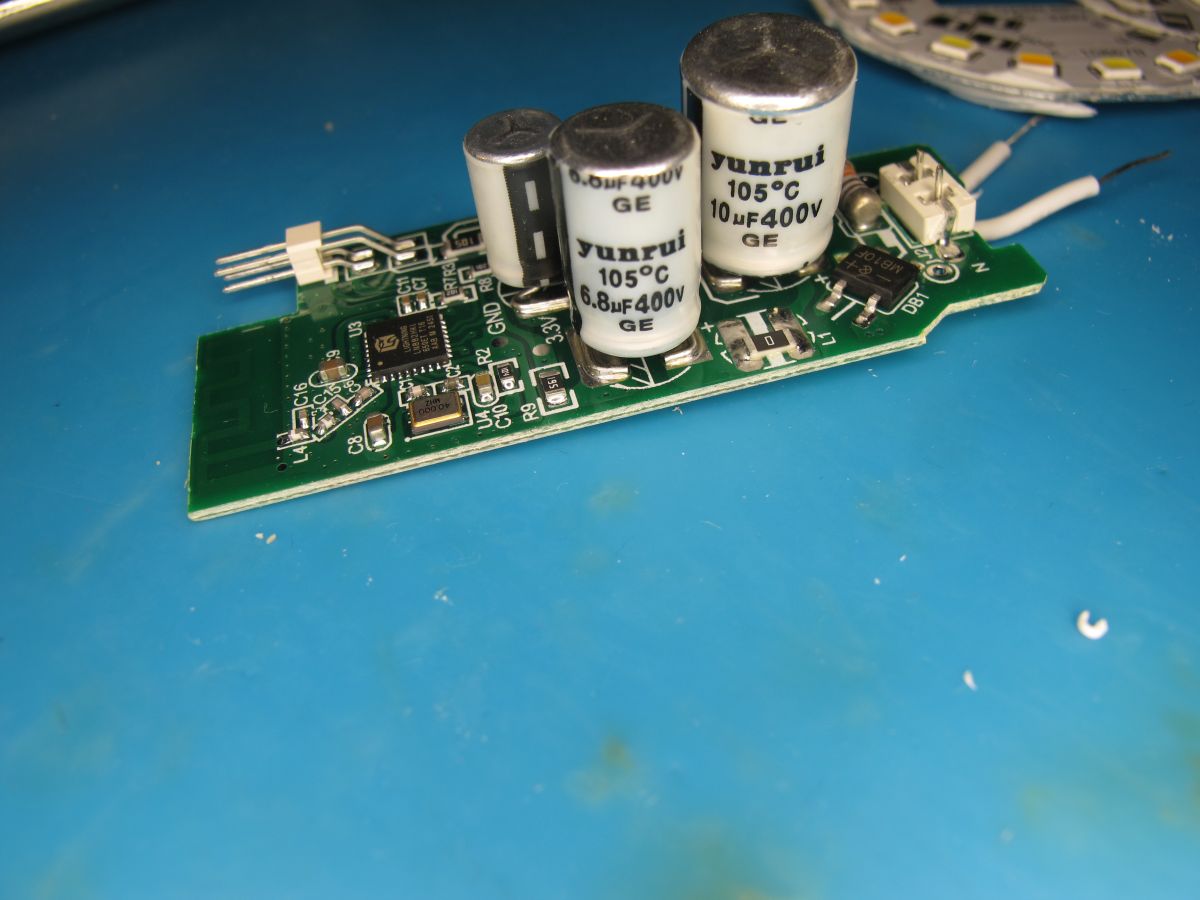

    CW bulb with 5-channels two-wire chip BP5758? So 3 out of 5 channels are not used... How does it make sense?
    Is it at least cheaper than RGB+CW?
    With the current board layout, you could easily solder Red, Green and Blue LEDs and get back it working into RGB+CW mode.
    Or wait - maybe not, depending on the power supply circuit? That powers LEDs?
    How much did they even save by stripping four red, green and blue diodes? Considering they came extra cheap and in packs of 100 or 1000 or so on...

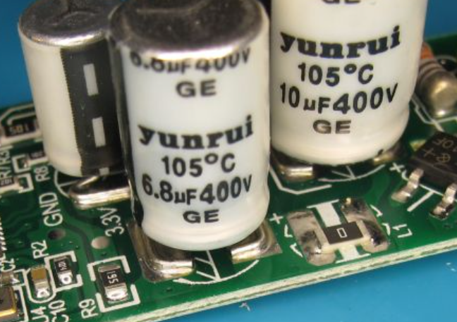

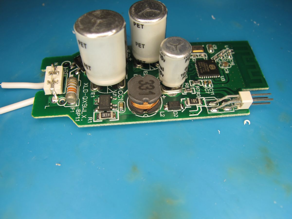

    Also, that's indeed an interesting way to mount a capacitor:
    Close-up of Yunrui electrolytic capacitors on a PCB
    Very interesting. I am happy to see you still making teardowns, especially that even now they feel fresh and show new things.
    PS: Maybe it would be economically viable to set lower current for those diodes, depending on how bright you need them. This can seriously prolong their life, some people even do the same for non-smart bulbs:

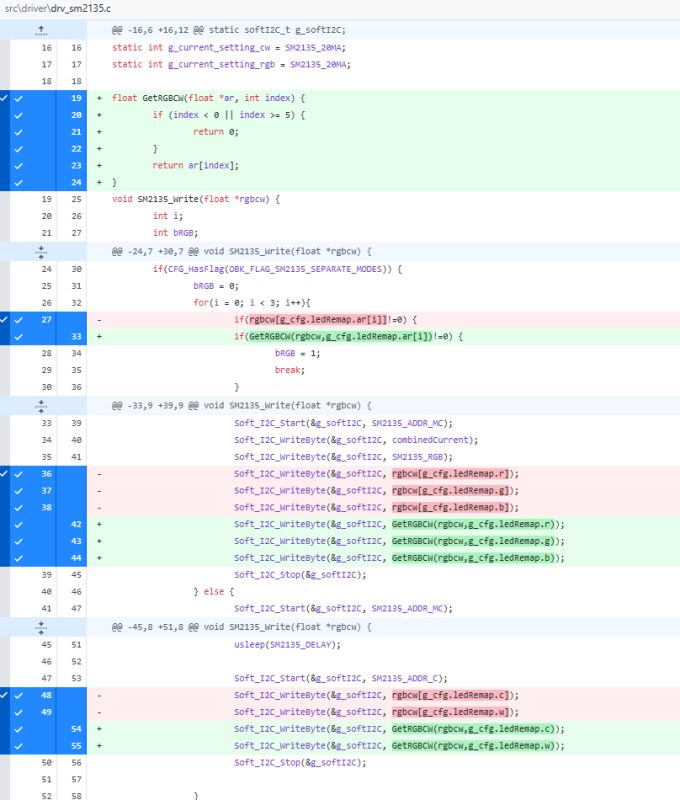

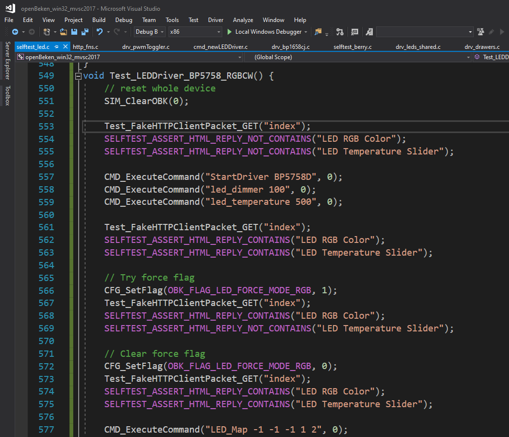

    I am preparing self test to add handling for these cases.
    Test code for LED driver shown in Visual Studio interface
    I will probably opt for something like this:
    LED_Map -1 -1 -1 1 2
    This means that only OBK C and W are mapped to channel 1 and 2 of BP5758, and others are 0, and page code checks for that and concludes it's CW.
    Any suggestions, before I implement it?
  • #10 21654269
    Posts: 5212
    Help: 446
    Rate: 914
    not from me!
    -1 -1 -1 make sense to me
    does that also cover @insmod's missing CW
  • #11 21654339
    Posts: 14755
    Rate: 12880

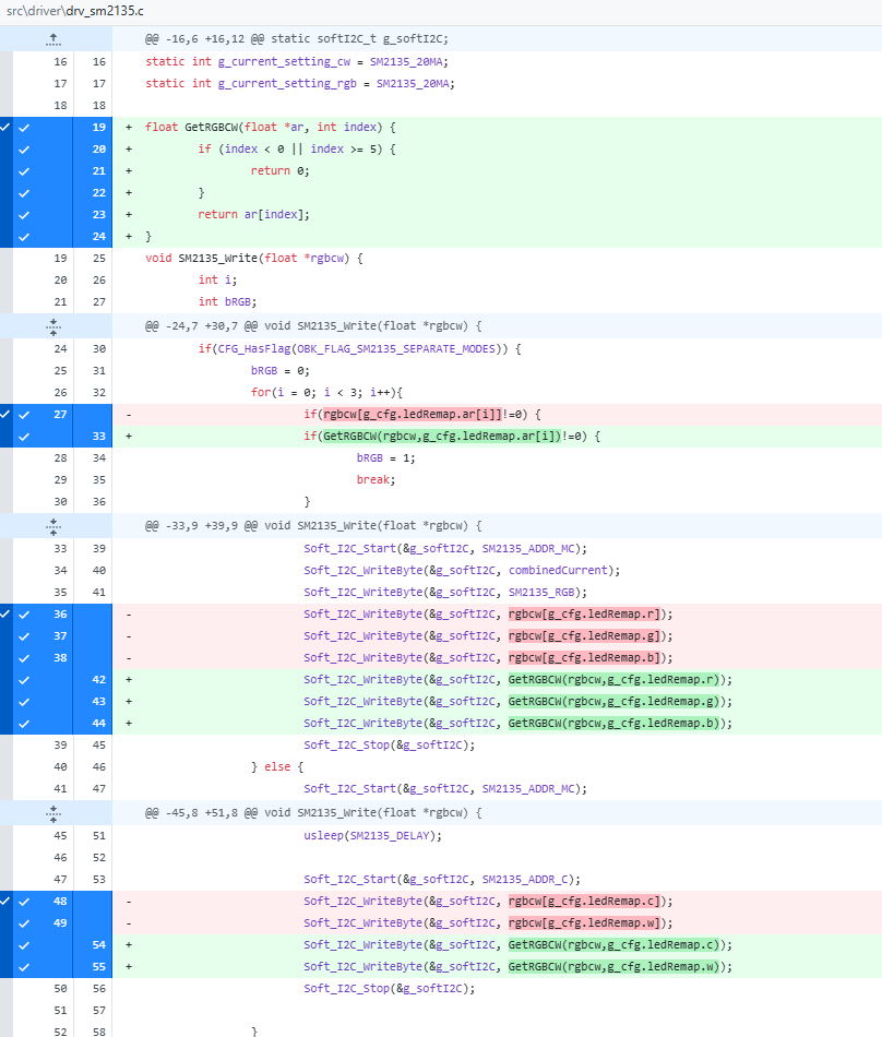

    The only downside is that I need to check for this -1 (0xff, 255) in remap... hopefully this will suffice:
    Screenshot showing a code diff in the C file highlighting the use of GetRGBCW
    I will open a PR in few minutes.
    Added after 26 [minutes]:
    https://github.com/openshwprojects/OpenBK7231T_App/pull/1789

    GUI looks good but sadly no light. toggling dimmer makes no diff
    LED control panel interface with brightness and color temperature sliders
    toggling 100% green and blue buttons does bring the CW/WW LEDs on
    Highlighted “100% Green” and “100% Blue” buttons in the LED tools section
    Added after 30 [seconds]:
    startup
  • #13 21654419
    Posts: 14755
    Rate: 12880

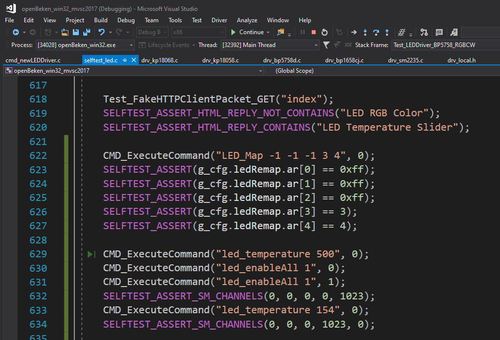

    I suspect I know what may be wrong. If you have CW light, then OBK CW channels have indexes 3 and 4. So your LED_Map should consist only of -1 (for skipped channels) and 3 and 4.
    In other words, this self test passes:
    Autotest code in Visual Studio showing LED_Map configuration and SELFTEST_ASSERT checks
  • #14 21654440
    Posts: 5212
    Help: 446
    Rate: 914
    yep. that's all it was. dimmer, toggle, web app all good now

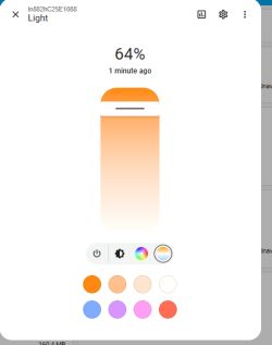

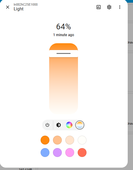

    Added after 6 [minutes]:

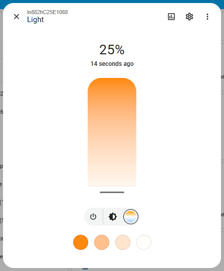

    HA works. RGB bits are there but CW/WW works
    Light control app interface with brightness set to 64%
  • #15 21654457
    Posts: 14755
    Rate: 12880
    I didn't adjust HA discovery yet, so that's expected. I only changed UI of OBK.
    Added after 4 [minutes]:
    Pushed HA Discovery. I just count number of non-negative remaps and use it as number of pwms. Didn't test it yet. I may cover it with self tests soon.
  • #16 21654469
    Posts: 5212
    Help: 446
    Rate: 914
    yep cool
    Light control app interface set to 25% brightness
