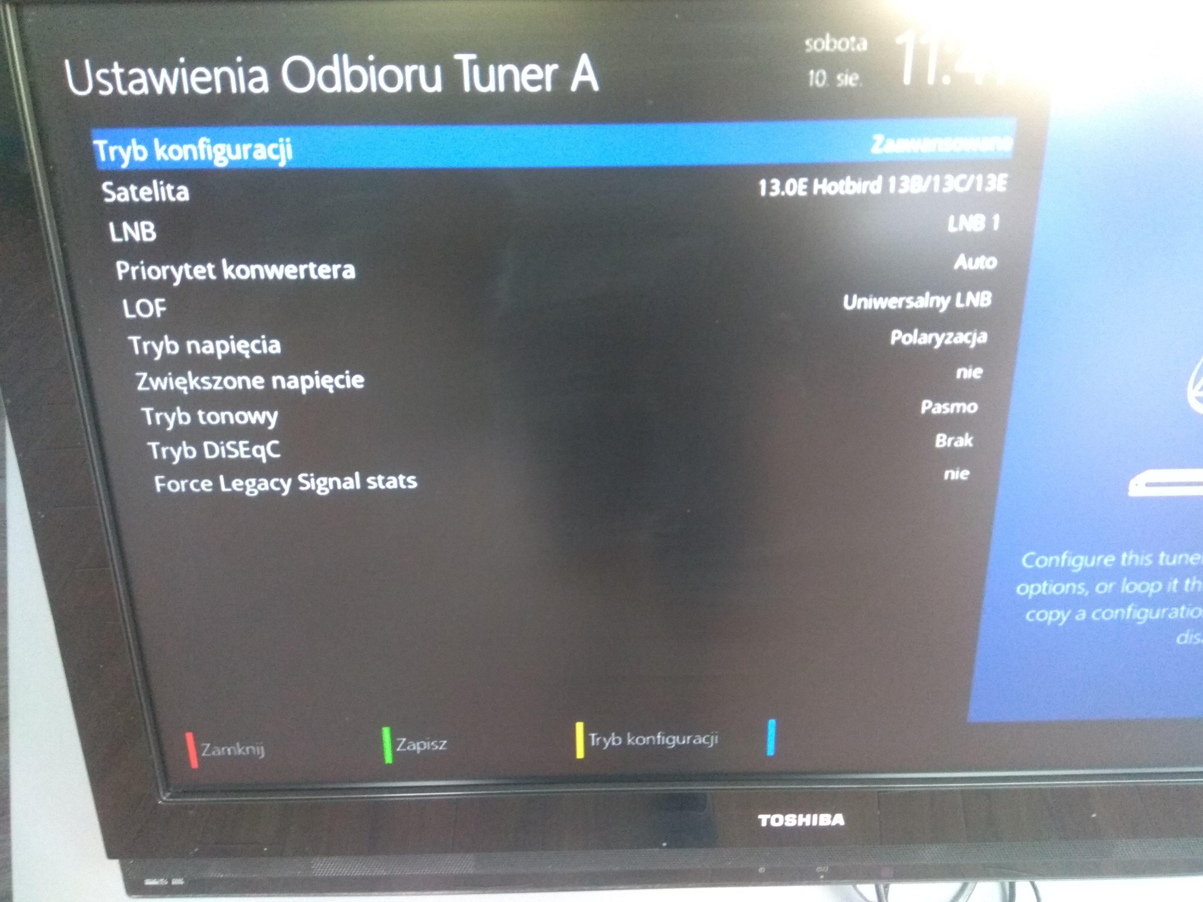

    Good day.
    I have a converter as in the photo. I connected a tee to the zgemma 9.2si decoder to the evobox from Polsat. Polsat works zgemma 9.2s does not see the satellite. I am asking for help in configuration.
    Is the tee used suitable?

    Evobox configured for this type of LNB takes up all 4 SCR frequencies. For Zgemma to function, it must be connected via a separate wire to at least one of the two Legacy outputs.
    In order for both decoders to work on one cable, you need to use a converter in the Unicable / SCR II technology.

    Thanks for the hint. When changing the converter to the one that is compatible with the standard mentioned by you, the distributor I put in as the second one will be appropriate?
    Now I have unplugged the evobox, it is only hooked up and still does not see the satellite :(
    Hooked up to the golden exit. What am I wrongly positioned?
    What should be the configuration for unicable and what is the usual output?

    Thanks for the links! Now it's easier for me to understand what's going on.
    With the setting of the evobox to which the table is, I have no problem, I have a problem to type in h9.2s on enigma2 with openATV but in one of the articles there is an example I will try on it.

    In the LOF section, you change to Unicable.
    The options for selecting converter manufacturer, converter type, channel, frequency, etc. are activated.

    Playing and beeping. Even on that messy tee.
