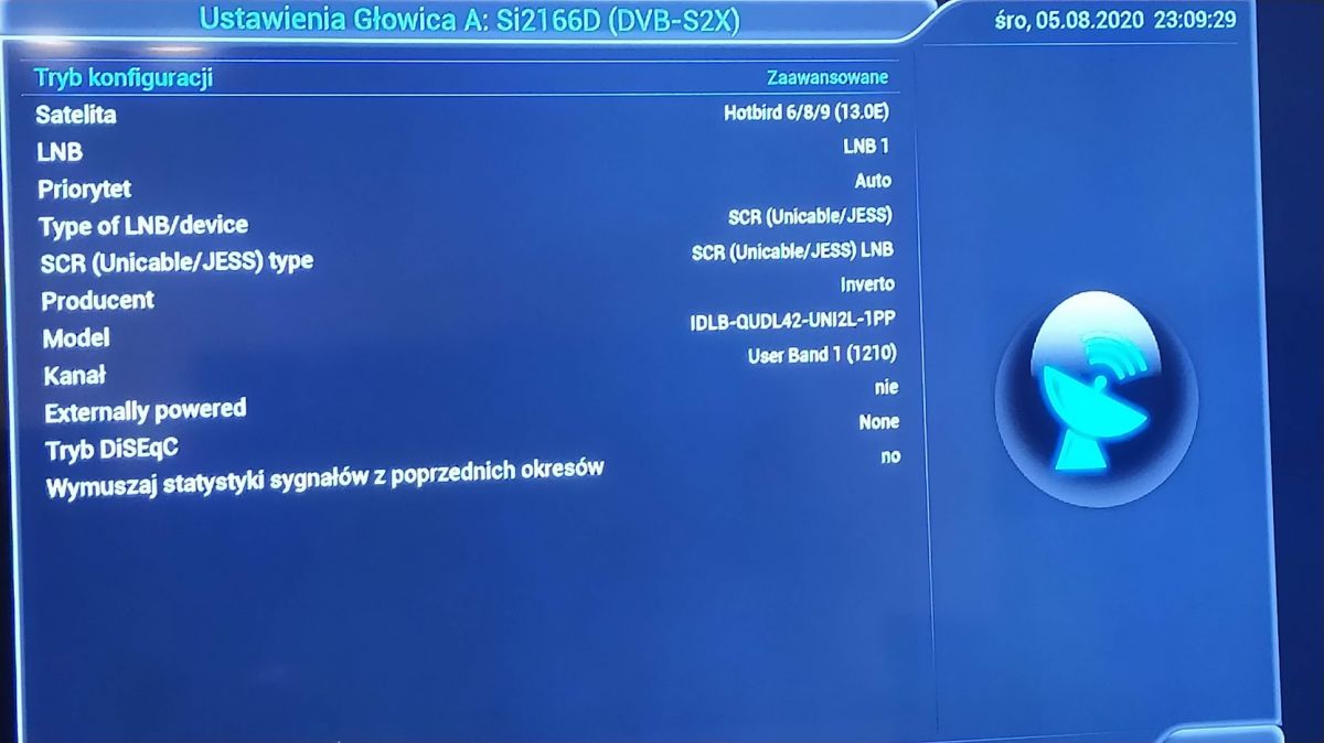

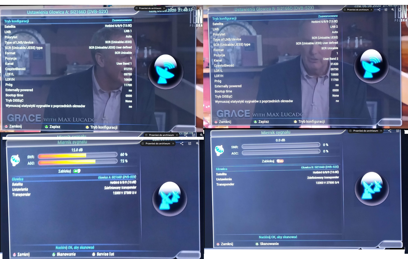

    I can't cope with the decoder settings to record and watch another channel at the same time.
    When switching channels and simultaneously recording another, the message tuning failed and a black screen appear
    1) Are the settings of the head one correct? Unfortunately, I cannot indicate my converter from the menu because this brand is not on the list. If wrong, what to correct?
    2) Should the settings of the head No. 2 be the same as the first one?
    3) Should the antenna cable be connected to any of these connectors with one wire or should it be split into two, and if one, which connector should be screwed into?

    From the gold converter output, connect the antenna cable to the splitter, from it with short sections to the decoder, to inputs A and B.
    If you assigned channel 1-1210 MHz in head A, then in head B assign channel 2 - 1420 MHz.
    Restart the decoder - test.

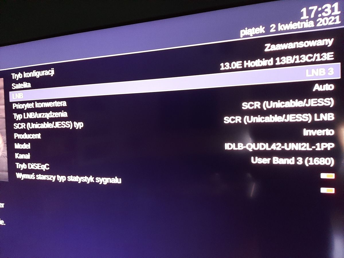

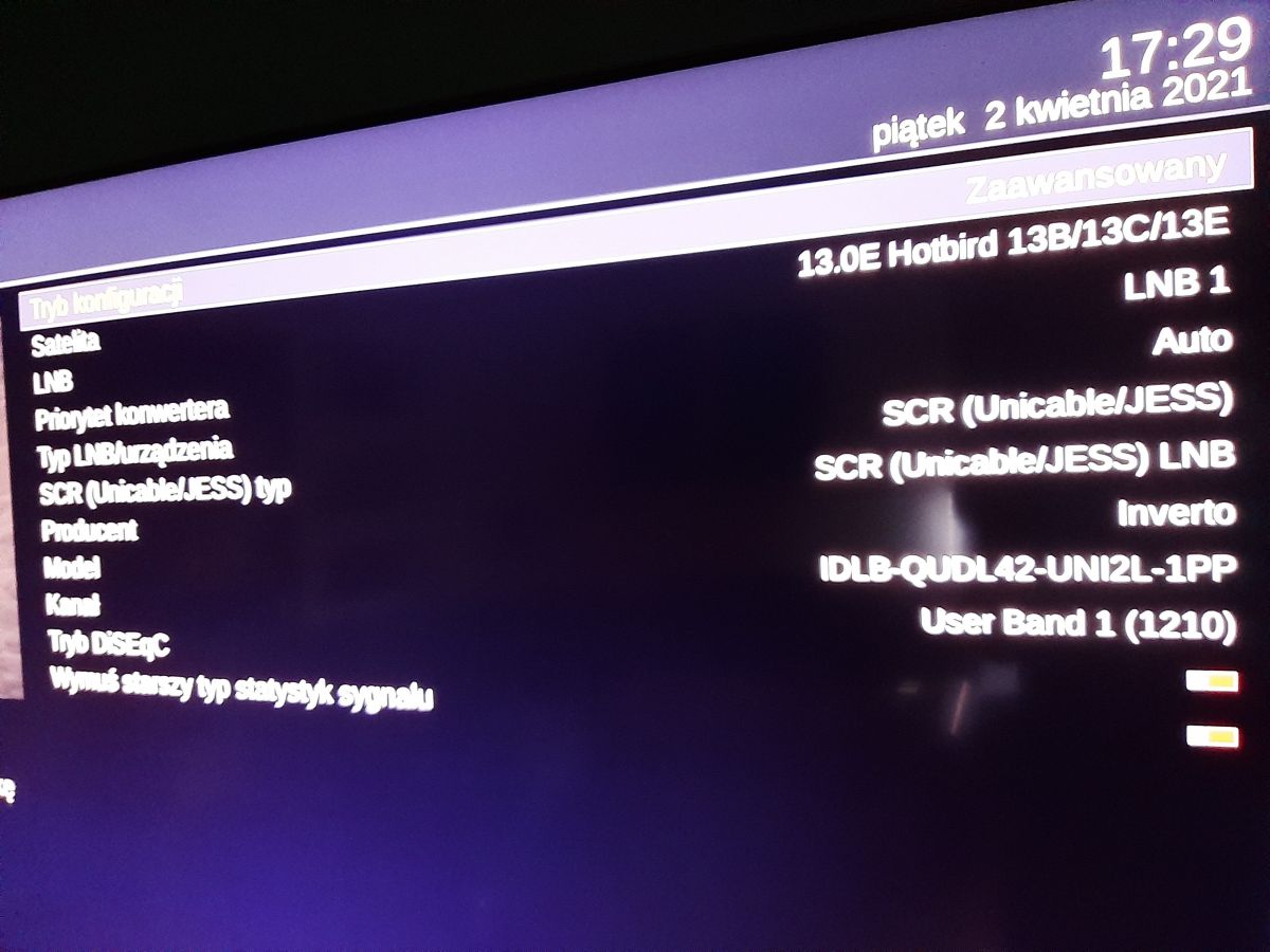

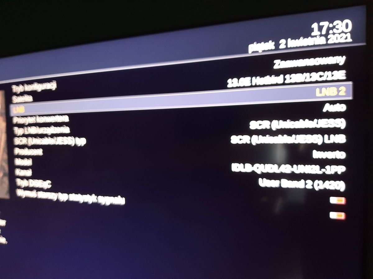

    So try in head A:
    -for LNB 1 assign Channel 1
    -for LNB 2 assign Channel 2
  • #5 18857927

    Zgemma H9 twin decoder - Watching the second channel while recording
    Yes, I have it but it still doesn't work
    On the left - head settings A, on the right - B.
    No signal from her at all, do you have any more ideas?

  • #8 18858154
    pikarel
    Posts: 5076
    Help: 410
    Rate: 1859
    mooser wrote:
    Yes, I have done it, but it still does not work
    On the left, the settings of the A head, on the right, B.
    No signal from it at all, do you have any more ideas?
    You are not like that; you showed the head A and B.
    Set ONLY in A:
    - in LNB 1 Channel 1 and in LNB2 Channel 2
    These are S2X heads (several LNBs in one head)

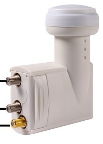

    No wonder that it does not work, you have to have every head connected, i.e. you need a splitter or connect two cables to the separating splitter.
    Buy a SAT splitter with power pass.
    I don't know why you would set 3 SCRs senselessly when you have ONLY 2 heads.
    FOR THE TEST:
    Connect the tuner A, B and turn off the tuner, you will turn it on when you connect the cable from the splitter to this head.
    You always have 1 LNB on each head.
    I hope you have definitely connected the cable to the gold plug? :)
  • #13 19356323

    Then connect A, this is the first entrance from the disk side.

    This is bullshit, the S2X is a normal head, the guy probably doesn't know what the standard is. You will never use this on a Hot Bird because there is simply no transmitting transponder on the S2X.
    There are multi-heads FBC tuners, 8 heads, but this is not Zgemma's price class.
    It will, only B set it normally because it's a normal converter.
    At least you will check and learn how to set up Unicable, it will be useful when you hook up the second tuner.
