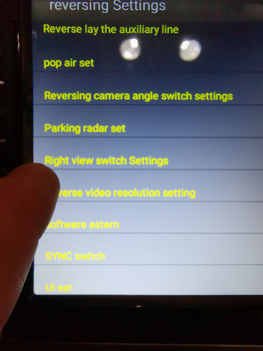

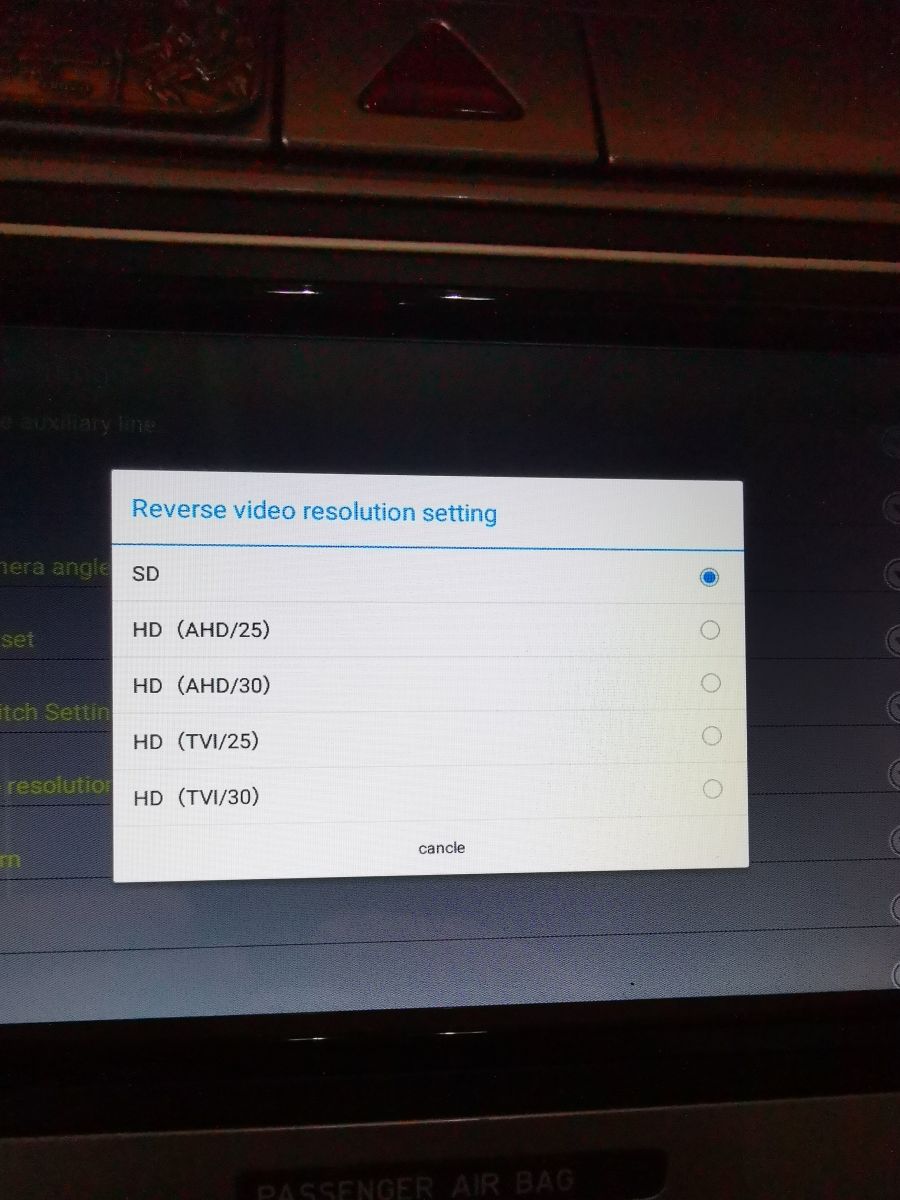

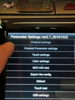

  • Factory reverse video resolution set to SD
    #37 19036963
    macioooo1
    Hello. I made it ?
    I entered the factory settings. Then "Protocol Parameter settings", then "Reverse video resoultion settings". I switched to SD and it works in my case. ?
