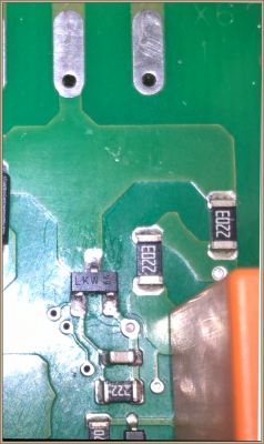

    I am asking for help in finding out what a transistor it is, because it is probably not a triac. It controls the operation of the water jacket solenoid valve (300V DC coil). It says LKW 66, and what replacement can I insert here?

    :arrow: Marking LL W = PBHV9050T
    :arrow: Marking LK W = PMBTA45

    This is what this element looks like.

    It was wrong (on the left is now on the right in the photo), but what can we do ...

    Again, I mean to check the marking on the LKW66 transistor, what is it?

    Good news, dishwasher repaired. Thanks a lot to Kraniec_Internetów . This transistor is actually PMBTA45, although I didn't get one, I put in MPSA44, not SMD, a bit more powerful and everything goes wrong. I will add, maybe it will be useful to someone, the LK symbol means NPN transistor, and LL PNP, the letter W means that it was made in China, I do not know what the numbers mean, but probably the voltage and current values. The one I am looking for, ie LKW66, is for a voltage of 500V / 150mA. I put it on 500V / 300mA.
    Besides, I would like to add that the coil of the water jacket solenoid valve is very weak. It says that it can work 5 minutes and 20 minutes should be turned off. However, this is stated on the coil and must be read with a magnifying glass. I noticed that after 2-3 minutes the coil heats up a lot and as he wrote Peter 2608 if there is a problem with water, the coil will damage and the module also flies, error E19, then E01. How could you use such a coil, wouldn't it be easier to put a normal one on 235V, but Bosch has to introduce some innovation that it bangs your feet. "What a great idea."
