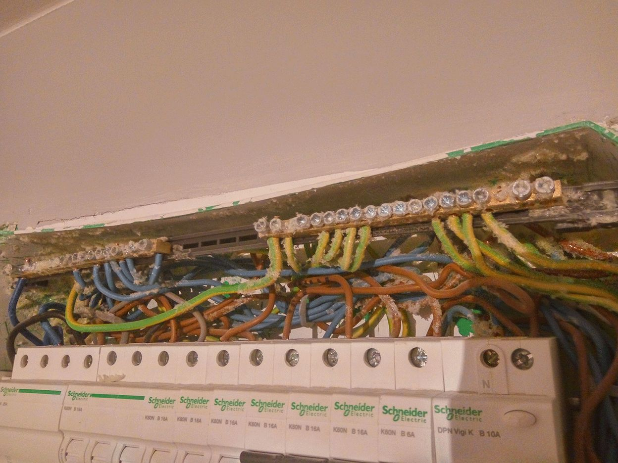

Can mounting foam on electrical switchboard cables cause voltage or load problems, and is it dangerous after sparking and a melted fuse were observed?
Mounting foam itself usually does not affect the installation because it is an insulator, and with such a small amount nothing should happen unless it damaged the wire insulation or the contacts on the N/PE bars [#18132477][#18132513] The real concern is a poor or loose connection: the sparking and melted fuse are more likely caused by a loose clamp or bad contact than by the foam alone [#18133546][#18135987] If the foam were more extensive or had damaged insulation, it could contribute to overheating, melting, sparking, and even fire, because the foam burns readily [#18132513] In the photos described, the foam on its own is not the main electrical problem, but the board still needs inspection for loose terminals and damaged insulation [#18132513][#18140938]

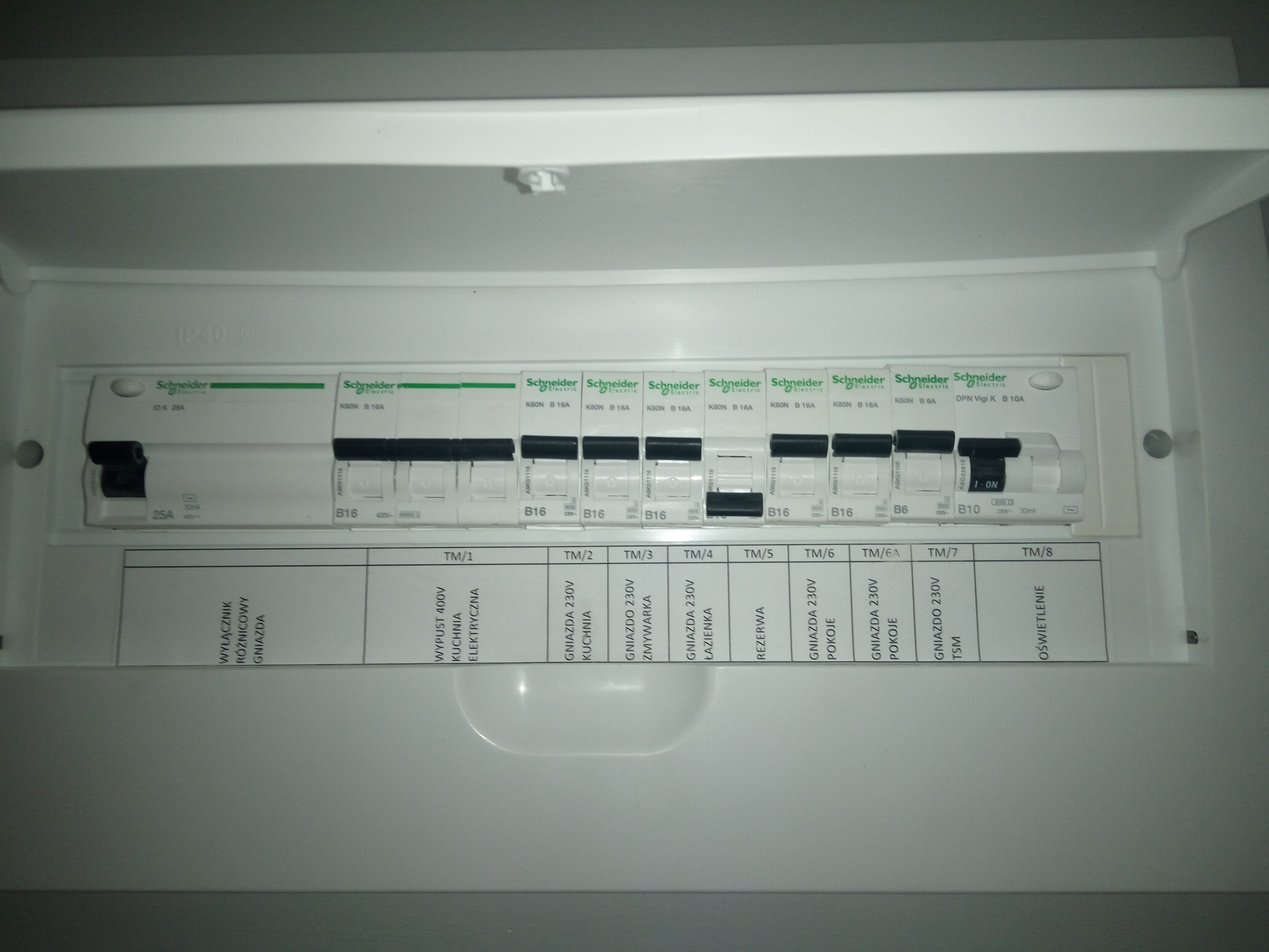

    Thank you all for your replies so far.
    I think I`ve already given a sufficient answer to my question about the safety of using foam - with such an amount and assuming that the foam itself does not insulate the joints, it does not pose a danger.
    Additionally, the topic of the switches used was discussed. 3-phase residual current devices for single-phase circuits.
    As far as I know, there are two circuits in the apartment: 3-phase (kitchen) and 1-phase - I am attaching photos of the switchgear with the housing and description.
    Is this connection correct? If not, what is correct?

    Using an RCD for lighting is a misunderstanding, and the entire lighting "hangs" on one circuit. The socket circuits in the bathroom should be protected with it.

    You have in your apartment:
    1. 1 3-phase circuit
    2. 6 single-phase circuits
    These 7 circuits have a common RCD 3f
    3. 1 circuit protected by RCD 1f with an overcurrent element (lighting). It`s strange that the lighting was implemented separately, and not the bathroom...
    Lighting in the bathroom must also be protected by an RCD.

    Yes, but you could socket and bathroom lighting on a separate RCD.
    Of course, but better:
    And basically it is, because it is protected by RCD 3f.

    By the way, if it weren`t for the stupid actions of the installer of this switchgear, there would be no issue.
    But there is always someone out there who knows better that it is possible and that there are no contraindications to mounting the backboard on foam.
    We can see the effects in the photo.

    panjann wrote:
    Please help,
    The cables in the electrical switchboard of the apartment that I received from the developer are dirty with mounting foam - I attach photos.
    Can such contamination of cables cause problems (load, voltage) and can it be dangerous?
    I learned about the condition of the interior of this switchboard only after a problem with the installation occurred - I heard sparking, there was a problem with the voltage - as a result, one fuse was melted - it needed to be replaced.
    Safety Concerns: Mounting Foam on Electrical Switchboard Cables
    Out of curiosity: do you have any measurement report of your electrical installation?
