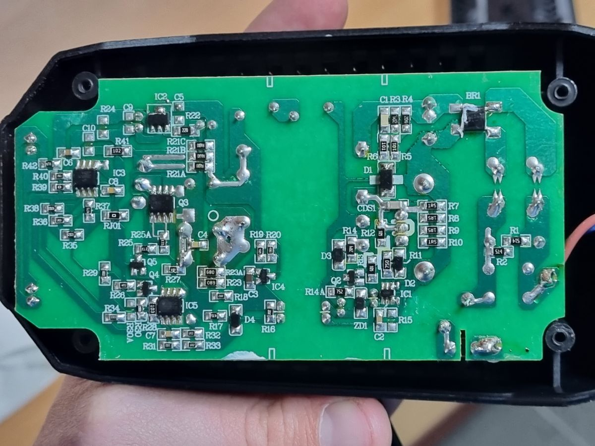

    Hi! My Parkside charger does not work anymore, the LEDs do not turn on at all and it does not charge. It would be nice if I could repair it myself. Could someone help me do this? I attach some photos with the charger. Any advice/instructions is welcome! Thanks!

    I have the same issue, but I have found part signed Q3 is blown. Does anyone know the type, please? Damaged circuit board with a burnt component labeled Q3.
    Thank you in advance.

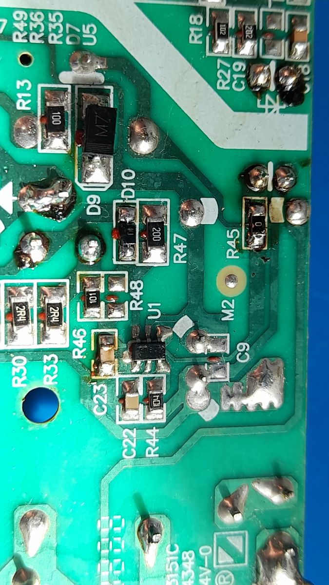

  • #8 20864165
    Matbar1132021
    Rate: 7
    NCE4953
    1XKD5
  • Short circuit remains after C23 removal

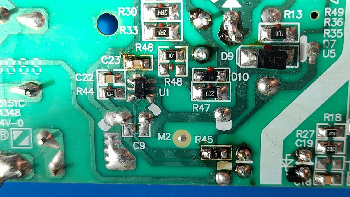

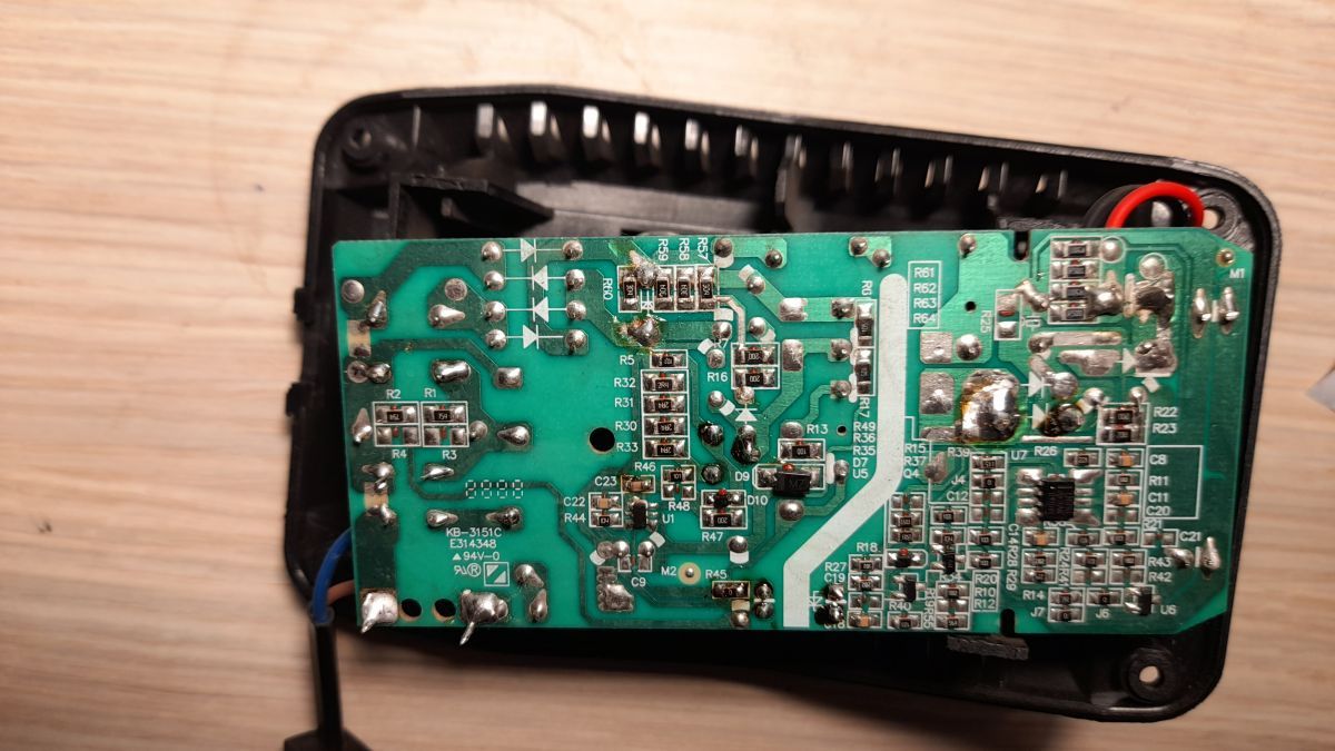

    I`ll approach you and ask for identification. Probably converters, (signed as 30642). In my case and in your case it is in a SOT23 housing with 6 legs. For me it`s signed on the laminate as U1, and for you as IC1. After desoldering the C23 capacitor on pins 1 and 4, I still have a short circuit. The SR4N60 transistor is functional, the SCHOTTKY 200V 5A SB5200 diode was replaced because it was short-circuited. The optocoupler is operational.
    Close-up of a circuit board with electronic components, including diodes, resistors, and an SOT23 six-pin integrated circuit labeled U1.

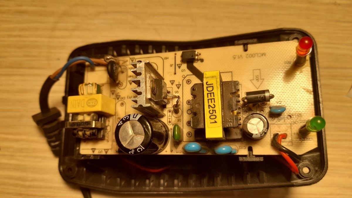

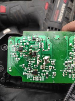

    After reading several topics on the electrode, I bought the SG6859ATZ chip from a Chinese guy, which turned out to be a replacement and the charger works. It seems that this system is a replacement for my AAJ system, my system with the number 30642 in SOT23-6 and probably many Parkside chargers. Also install SG6859ATZ :) unless you are from the Rzeszów area, I will provide you with art for free. I installed this system in the Vander VWA718 charger. - I noticed that most of these simple ones are made similarly...
    Close-up of a charger interior showing electronic components, including a JDEE2501 chip. Circuit board with electronic components of a charger. Close-up of a circuit board with various electronic components such as resistors and capacitors.

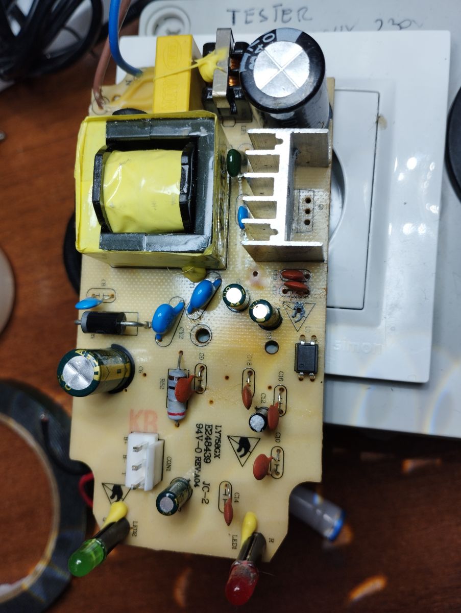

    Thank you for your reply. According to your advice, I have purchased (still with us) this circuit. But it continues to torment me and keeps me up at night. After replacing the mosfet with a replacement 2SK1117, (isolated from the heatsink), the driver also went on swap, I also replaced the standard burnt 2 ohm resistors around the mosfet. No other low values in the measurements I noticed, (I have a second charger to check), the diodes at the transformer are working, the Schottky diodes and the whole secondary side is working. I don't know where to look next, and firing this set of components even through a light bulb will happen. Maybe someone can give me a hint to at least fix for knowledge and experience 😃
    The board after soldering the burnt components.
    Circuit board with various components like capacitors, resistors, and a transformer. Green circuit board with removed components, shown up close.

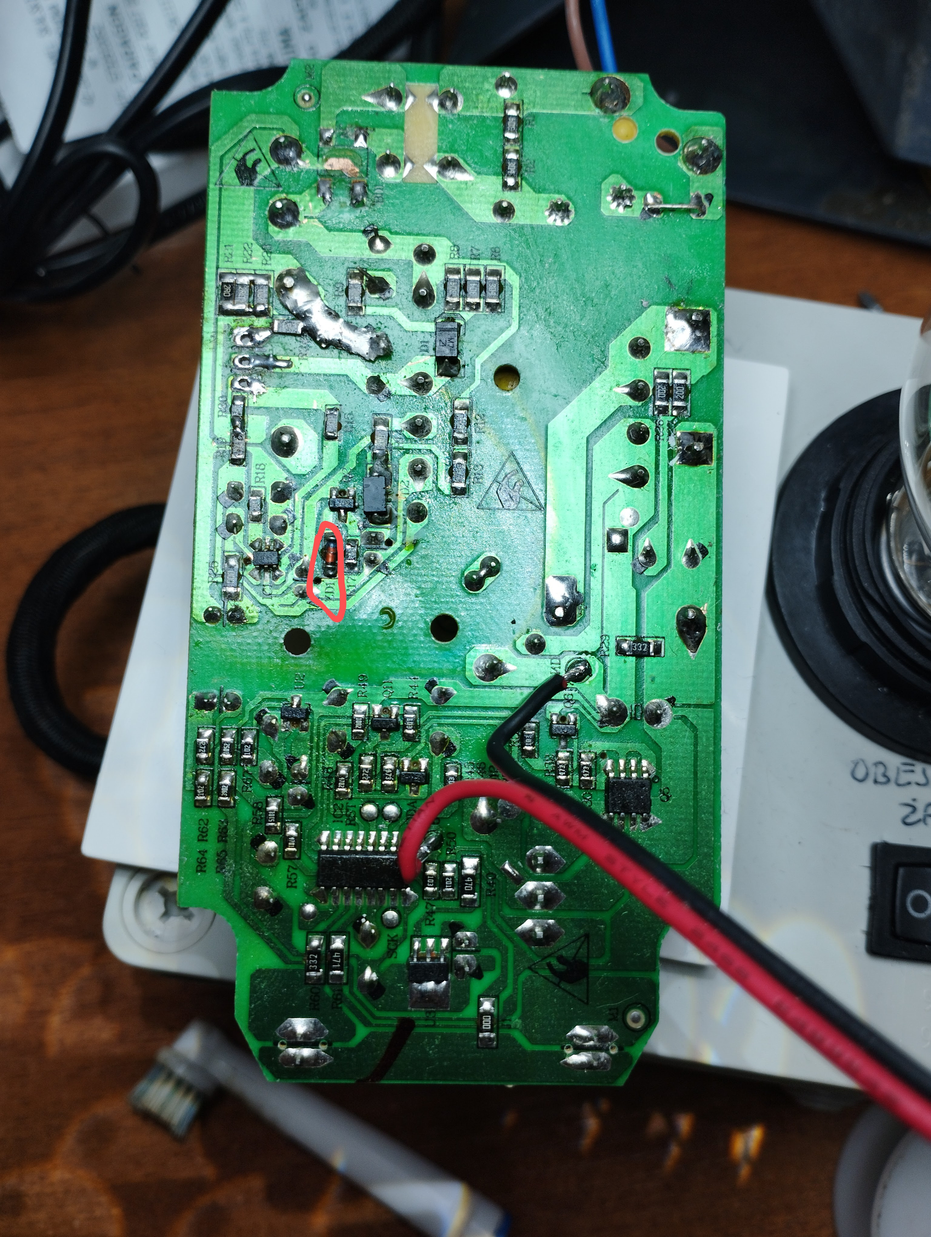

    Hello, I managed to get one working. However, I have a question for you guys on how many volts is that marked zener diode. Maybe someone could open their charger and take a look at this element😀.
    Green printed circuit board with a highlighted diode. .

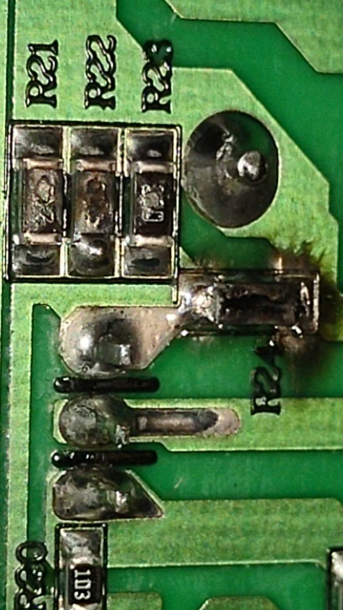

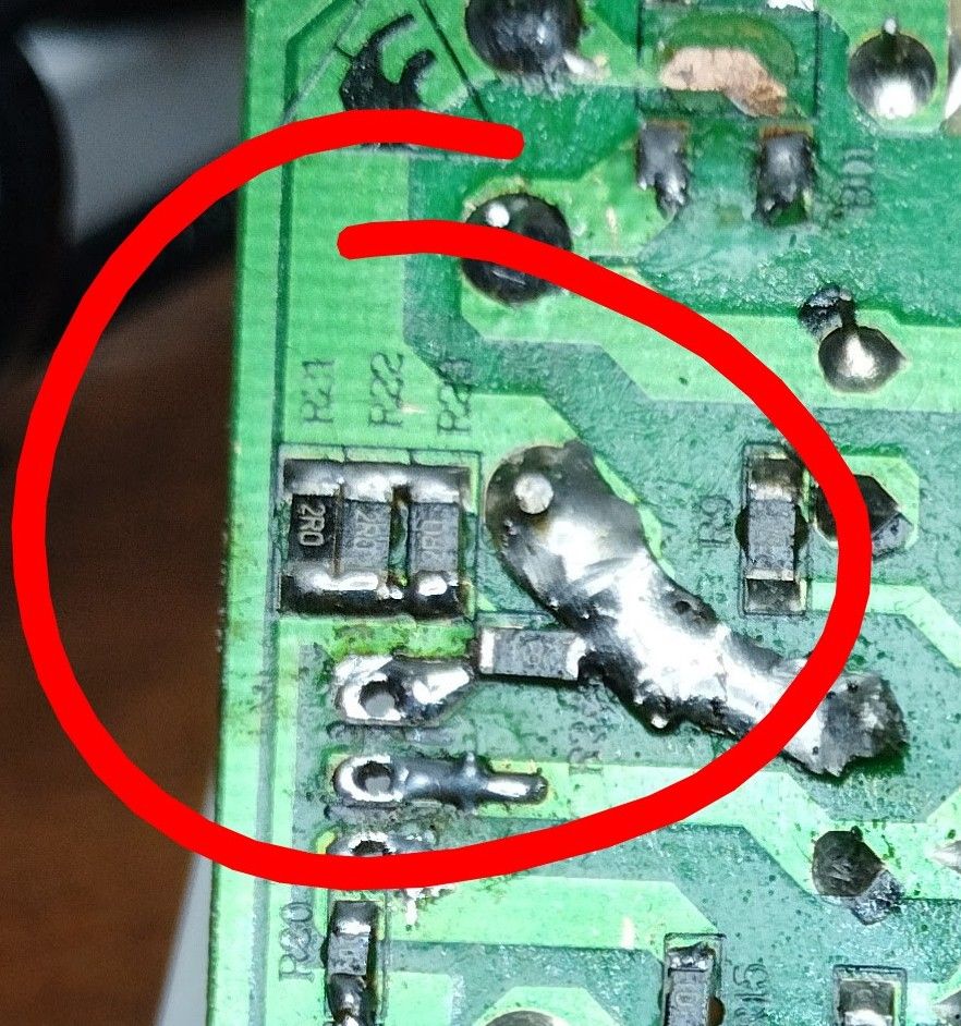

    DIY Parkside Charger Repair: Fixing PLG 20 A1 with LED Issues & Photos Included (90 chars) .
    Just now while charging the battery it banged, after taking apart burnt components as shown in the picture.Please identify.
    From what I see in earlier posts, R21,R22,R23 are each 2ohms but I don't see the value of R24.
  • #17 21703795
    banesacom
    >>21604645 From R21 to R24 number on resistor is 290. Means 29Ω. I can't even find that value so I'm in a dilemma whether to put 27 or 33 Ω
  • #18 21705766
    plichta
    Posts: 505
    Help: 23
    Rate: 68

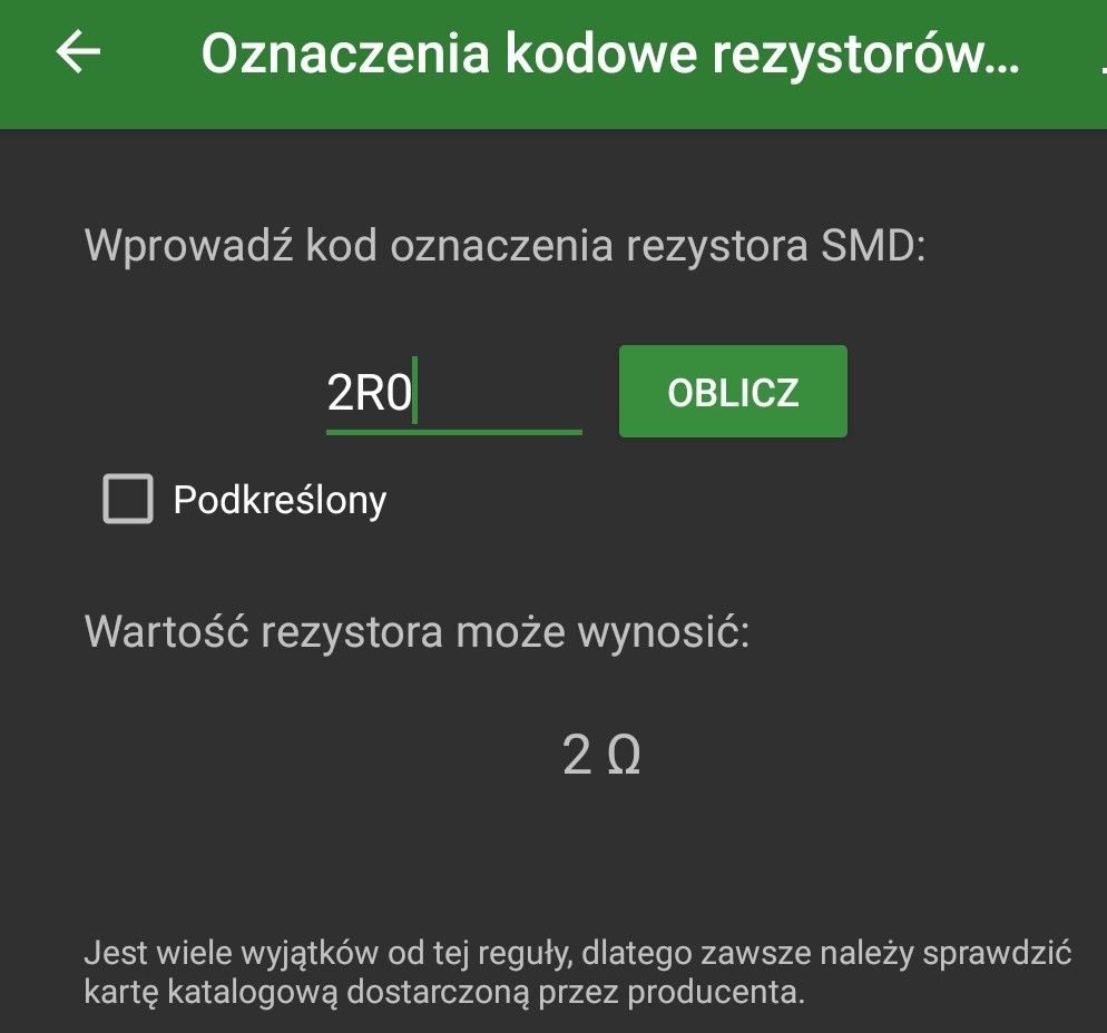

    App screen showing SMD code “2R0” and calculated resistor value of 2 Ω Close-up of damaged PCB with resistor labeled 2R0 highlighted in red circle In the photos in the posts above I can see the writing on the R21 2R0.

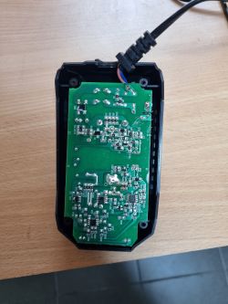

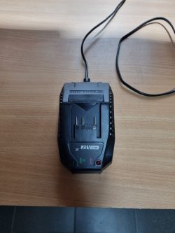

    Good morning, my PLG20c1 charger is not working.... I have opened it and I don't see the fuse. Where is it located here in the pictures?
