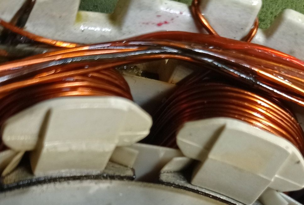

  • #33 18832842
    Mihalich
    Posts: 14
    grzelecg wrote:
    Mihalich wrote:
    Good morning, Grelec.
    I completely disassembled the compressor. I can clearly see the closure between phrases. I will rewind the stator.
    Thanks for the info. So it is confirmed that the SP-A2 oil dissolves the insulation of the wires.
    g
    Good morning.
    Yesterday I assembled the compressor - rewinding the stator gave the effect. everything worked)

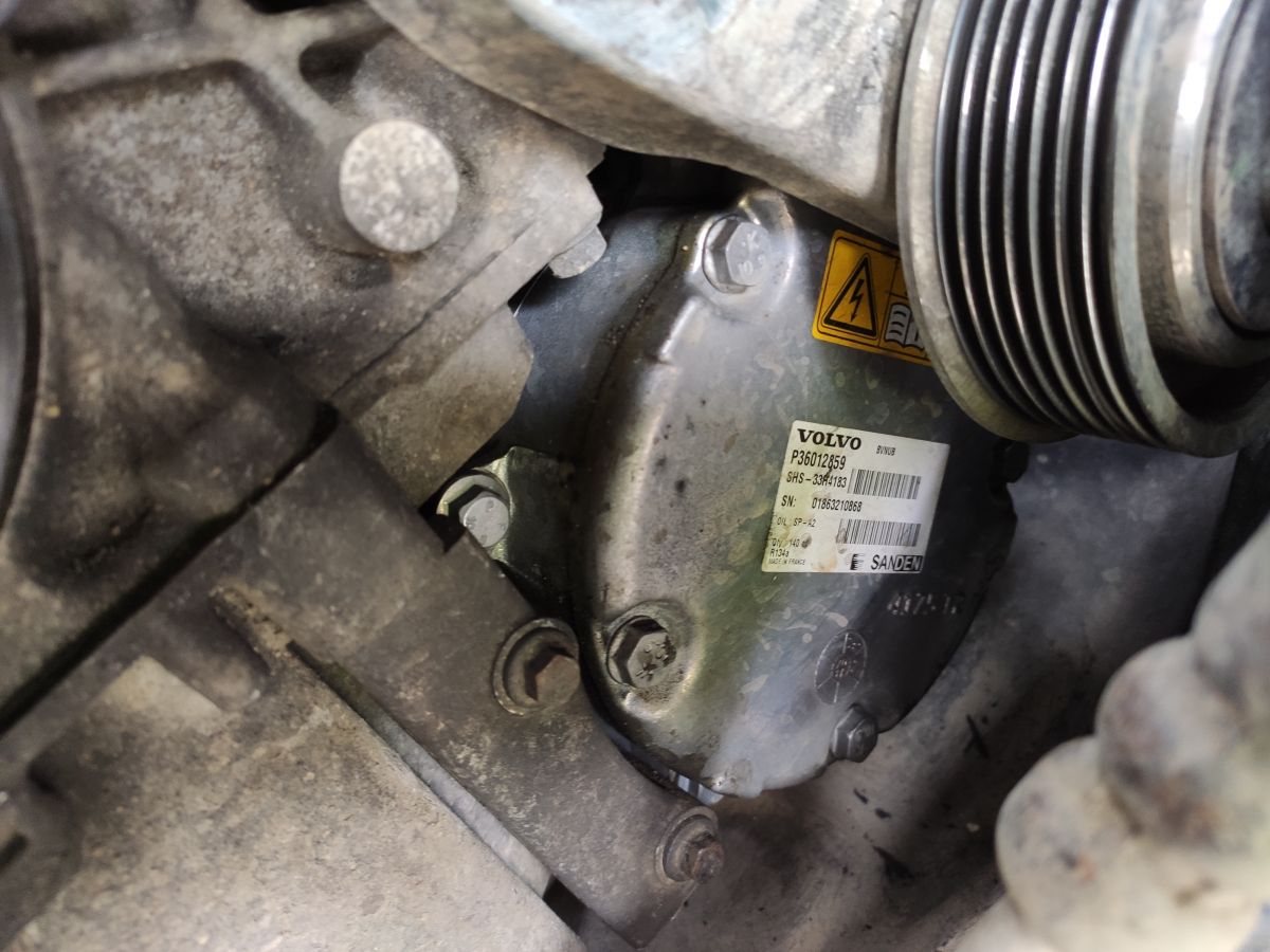

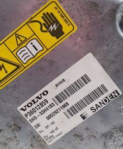

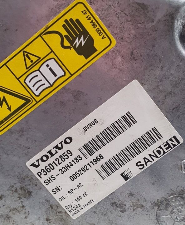

    So informative. When they repaired the compressor, they put in a newer model:
    was: SHS-33H4166
    it is: SHS-33H4183 (probably "refurbished", because the housing shows the number 4166)
    Communication with SANDEN Electric Compressors Models 33H4166 & 33L4156 for Hybrid Vehicles
    P.S. Unfortunately, I have another failure. The head of one of the screws holding the paw of the pulley that guides the alternator belt broke off and it got dirty.
    Timing shifted, probably a collision and the head to work. New bolts arrived today. I'll check how much I'm back again.

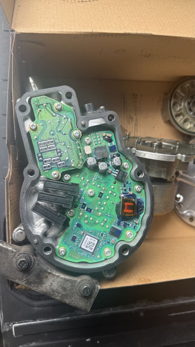

  • #39 18986456
    VladMasters
    Najpierw napisze po rosyjsku, a potem przez tłumacza po polsku.

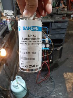

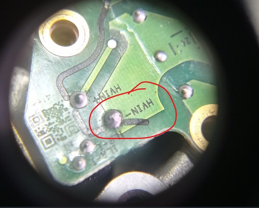

    Bought Volvo with mileage 102500km. At this point, she already had a new model of air conditioning compressor replaced at 78000 km, namely SHS-33H4183.
    In August, when the mileage was already 152,000 km, I saw an air conditioner error. When I connected VIDA, I saw an overcurrent error. The last reading was 63.75A.
    Having removed the air conditioner, I disassembled it and realized that the reading 63.75A is erroneous, since at such a current there should be traces of burning. After measuring the resistance of the windings with a highly sensitive tester and making sure that there was no short circuit to the case, I decided, on the advice of Greg, to replace the IGBT transistors (IKW75N60TA), which I had been waiting for 3 weeks. According to my own beliefs, I also replaced the PWM controllers and current resistors.
    Having assembled the compressor and filling the system with Sanden SP-A2 oil (it costs about $ 120), it is not possible to find it in the catalogs by the manufacturer's number, but you can find it by the BMW spare part article: 83222339920, as well as the refrigerant.
    Here is his photo:
    I was very upset that the compressor did not work and after 5 seconds of operation it went programmatically into a current of 63.75A.
    Turning to his friend, who specializes in automotive electrics and electronics, with the question of why this is happening. After a while, I received a reply that the compressor control board softwarehas the following algorithm:
    In the absence of a short circuit, the inverter supplies power to the motor windings.
    After 5 seconds of running the motor, the inverter stops supplying power to the motor windings.
    The compressor motor runs on an inertial coast, at this moment the control board measures the induction of the motor windings.
    If everything is in order, power is supplied again.
    If not in order - the controller falls into an error.
    Accordingly, it was clear that the matter was induction. The compressor was disassembled again. And the motor winding together with the rotor were taken to electric motor repair specialists. Having connected a device for measuring induction to the windings, it became clear that there were interturn short circuits on all three motor windings. Also, when connecting a megohmmeter, it turned out that the windings can "pierce" on the case at 1000V.
    The motor winding was rewound with wire as close as possible to the one used in the compressor.
    After that, the compressor was assembled and installed on the car, the system was filled with oil and refrigerant - the compressor started working, the current consumption was up to 4.5A.

    Люди, who helped me to reshit этот вопрос in Odessa:
    +380661486256 Disassembly of the compressor, conversion of SMD-elements ;) .
    +380969703260 Diagnostics and electric drive
    +380637562274 Dismantling and installation of the compressor, as well as filling the cooling system.

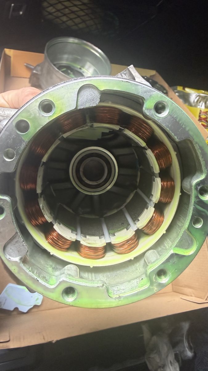

    #45 20098976
    MooseWorkshop
    @grzelecg
    I am writing with the help of a translator and I would like to apologize for that. Your Gregor and of course the work of others here on the Sanden SHS-33 (Volvo Part 36012859) is admirable.
    Thanks to your help, I was motivated to completely disassemble the compressor.
    Unfortunately I don't have support to rewind the motor? I haven't been able to find a company here in Germany yet. Now my questions
    Does anyone have a winding diagram?
    Can I use the electric motor from a Mercedes compressor? Does anyone know if there are differences in the motor winding in the SHS-33 variants?
    Thank you for your support.

    #46 20102438
    grzelecg
    Posts: 119
    Help: 6
    Rate: 99
    99% of the windings in the compressor from VOLVO and Mercedes are identical.
    3 phases connected in a star.
    I disassembled the compressor from the hybrid Mercedes W212. The differences are only in the housing and the HV power input.
    Of course, the software loaded in the electronics is not interchangeable, because the IDs of the modules in the cars are different.
    Some time ago I found out in one company if they would repair / rewind such a compressor.
    They replied that for PLN 1,500 they can easily regenerate and give a guarantee.

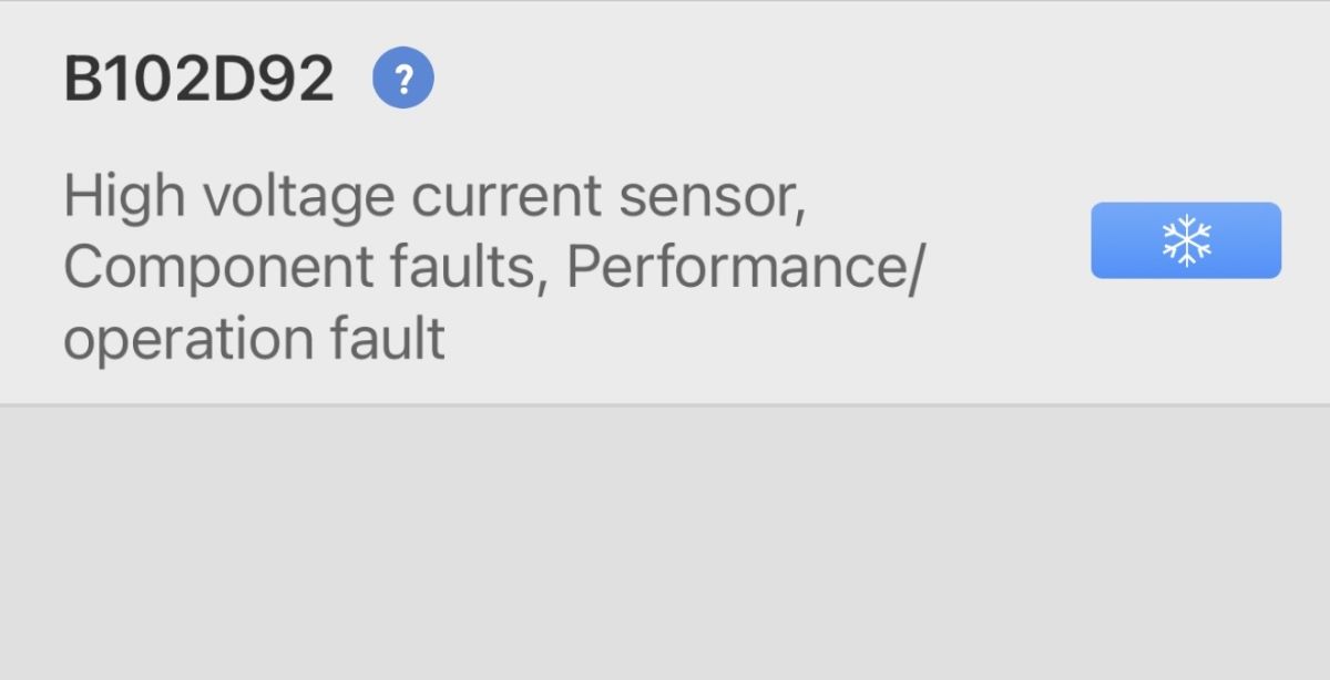

  • Can the compressor be saved by flushing and rewinding?
    #50 21693067
    arerojro
    Witam wszystkich. Przede wszystkim przepraszam za niepoprawne użycie języka; korzystam z tłumacza.
    Oto kolejny Volvo V60 PHEV z tym samym problemem ze sprężarką klimatyzacji.
    Kiedy wystąpiła awaria klimatyzacji, zostawiłem Volvo całkowicie na biegu jałowym i uruchomiłem je tylko na krótkie testy, przejeżdżając 5 kilometrów, a następnie 6 kilometrów z powodu innej usterki.
    Sprawdziłem, że wentylator włącza się podczas próby ładowania samochodu, więc zakładam, że sprężarka nadal działa, aby schłodzić akumulator.
    Czy uważacie, że w tym przypadku sprężarkę można uratować, wykonując głębokie płukanie azotem i odkurzanie oraz czyszcząc sprężarkę po jej rozmontowaniu?
    Czy ktoś próbował izolować uzwojenia izolacją elektryczną w sprayu?
    Czy wiecie, czy można wymienić same uzwojenia, aby poprawić rezultaty, jeśli elektronika nie jest uszkodzona?
    Dzięki wszystkim.

  • Bad HVIN- solder joint still leaves B102D92 error

    It is not necessary to use Sanden SP-A2 oil.
    There are analogues.
    SANDEN SP-A2 - analog: PAG 46YF - Compatible with refrigerant: HFO1234YF
    SANDEN PAG 46 - Compatible with refrigerant: HFC134A --- It costs less.
    Volvo B60 systems use refrigerant: HFC134a. Therefore, any PAG 46 standard lubricant is suitable.

    >>21693067 Flushing the system will not help. The problem, as users write here, is not mechanical!!! There should be no shavings in the system - nothing to flush.
    The problem is with the motor winding being punctured - flushing will not affect it at all.
    Added after 13 [minutes]:
    I am currently repairing the air conditioner on a Volvo V60 PHEV. I have already drained the system once, removed the compressor and disassembled it - I saw that the high voltage input (marked on the board as HVIN-) has a bad solder. I soldered it and thought that the problem with the B102D92 error was solved. But no! The air conditioner blew cold for about 2 minutes and then warm again. And i saw error B102D92 again.

    Rate: 6430
    Cold solder it is, but on the plus side

    >>21696337
    From what I understand after searching for a lot of information about this problem with the Volvo V60 PHEV compressor, PAG 46 oil and yellow UV leak detection dyes are somewhat electrically conductive, and the appropriate oil for electric compressors would be POE 46 oil. What do you think about this?
    I've also read that when the insulation loss isn't severe yet, the windings aren't perforated, and it helps to do a thorough cleaning, removing the PAG 46 oil and UV dye, and replacing it with undyed POE 46 oil and R134A refrigerant gas without dyes or additives.

    >>21699866 .....and R134A refrigerant gas without dyes or additives.
    They are pouring R134A on the assembly line!!!! What are you going to change there?
    Added after 7 [minutes]:
    I bought myself this oil:

  • PAG oil destroys compressor wiring in 2–3 years
    #55 21711436
    YuriSha
    Hybrid battery and hybrid drivetrain is cooled by the A/C compressor, so it is absolutely necessary for normal operation of the V60 D6. Bad A/C compressor will cause overheating and failure of several very expensive high-voltage hybrid system components (many require liquid cooling) and eventually strand the car - after a while the car cannot be started at all. Unfortunately, many owners have to replace the aircon compressor every 2-3 years, due to bad design of the entire A/C air conditioning system in V60 D6 PHEV. To fix it, PAG oil in A/C system needs to be replaced with POE oil dedicated for hybrid cars, while entire A/C system must be very thoroughly cleaned and several A/C components need to be replaced. It is a costly procedure, but still cheaper than new D6 A/C compressor every 2 years.
    Reason for failure: the PAG oil in A/C system - filled in factory - will slowly but unavoidably destroy the wiring on A/C compressor within 2-3 years. Volvo should have used POE oil, dedicated for hybrid cars.

    YuriSha
    Burnt copper windings inside an electric motor
    I got to the winding. I see that it is burnt.
  • #57 21933272
    GreedyArray
    Communication with SANDEN Electric Compressors Models 33H4166 & 33L4156 for Hybrid Vehicles Communication with SANDEN Electric Compressors Models 33H4166 & 33L4156 for Hybrid Vehicles PCB in a housing with SMD parts marked “223” and a coil at the lower right
    Hello, could the problem be with the 223 coded SMD components on the small circuit board, or could the issue be with the coil?
  • #58 21933425
    Strumien swiadomosci swia
    Posts: 27581
    Help: 1405
    Rate: 6430
    That’s right.

    GreedyArray
    Screenshot showing code B102D92 and a fault description for a high-voltage current sensor
    I'm getting this error.
