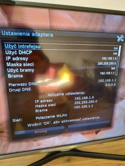

    Hello, I have zgemma h9s with enigma 2
    The problem is with the internet, disconnects, IP unconfirmed, black image. It is so that it works normally, disappears for several seconds and works again every now and then, or there is a complete lack of access to the content for a long time, when it restarts sometimes it works, and sometimes it doesn't help. There are days that everything works without any cutting. The same phenomenon is both when connected via wi-fi and
    LAN cable What's more, this is the second decoder (previously nBox black from E2) where this problem occurs. Same with DHCP on and off. Can anyone help? Router tplink. No other device has this problem

    Enter the permanent address and dnsy (dnsy 1.1.1.1 and 1.0.0.1) use a different cable and something about wifi and tell about the router

    When entering DNS, after confirming and restarting, it returns to the photo. I replaced the cable, then the Wi-Fi adapter and finally the nbox on zgemma, the same problem on each. Wifi with Orange 10mb, 1.5 meters from the TP LINK TD-W8950N router,

    If it comes back, it doesn't save it, so you're doing something wrong

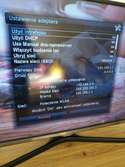

    Adapter settings - use manual DNS I select yes, enter the above, confirm ok, confirm when exiting, the message "network configuration"
    Is there another way?

    And what version of the enigma can the one you have is not a halo
  • #7 18256284
    kamiloxx1
    E2 open ATV 6.2 (in my opinion much better than the previous one I had.)

    start with the update the latest openatv is version 6.3 and then set everything up again
