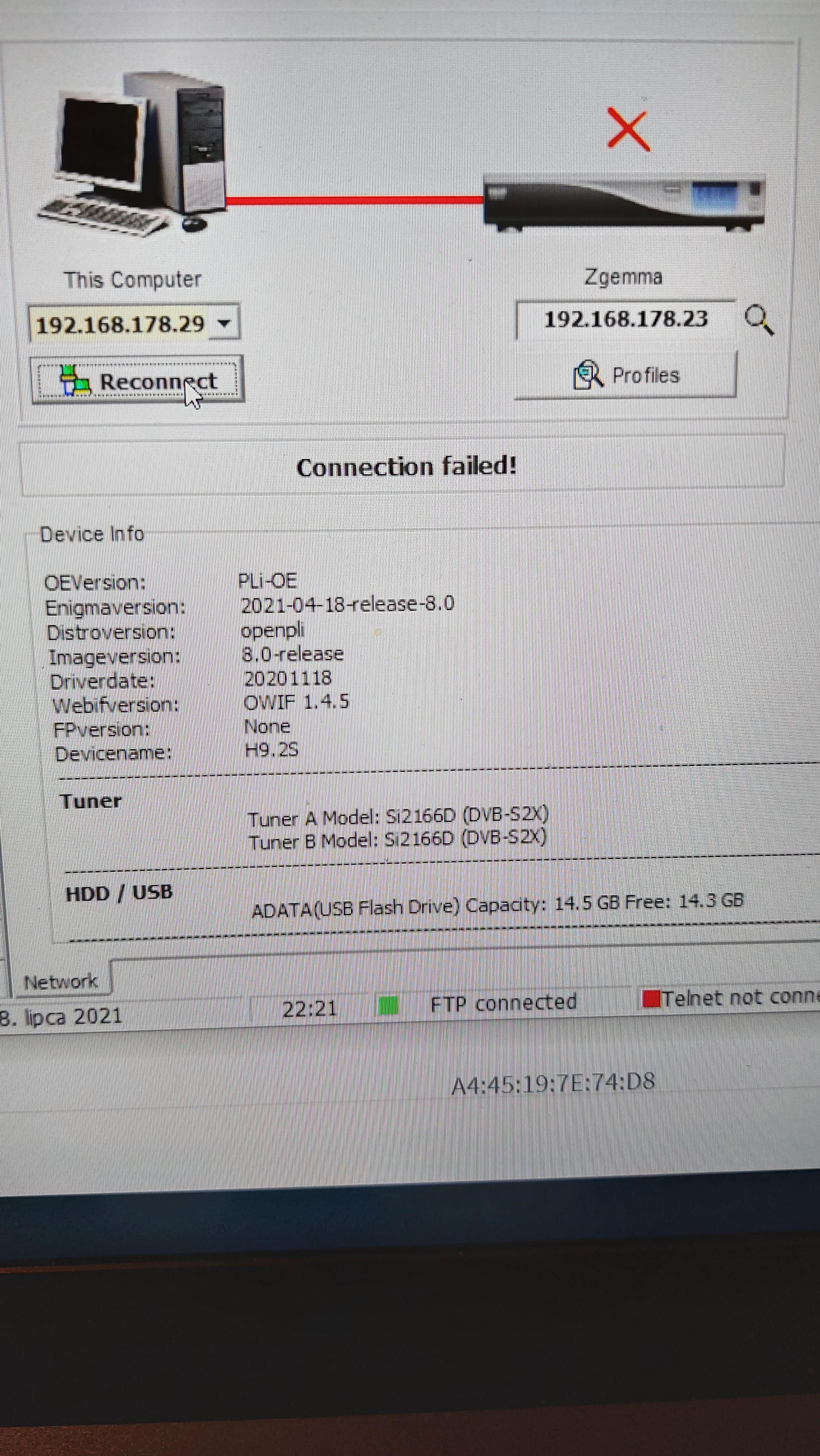

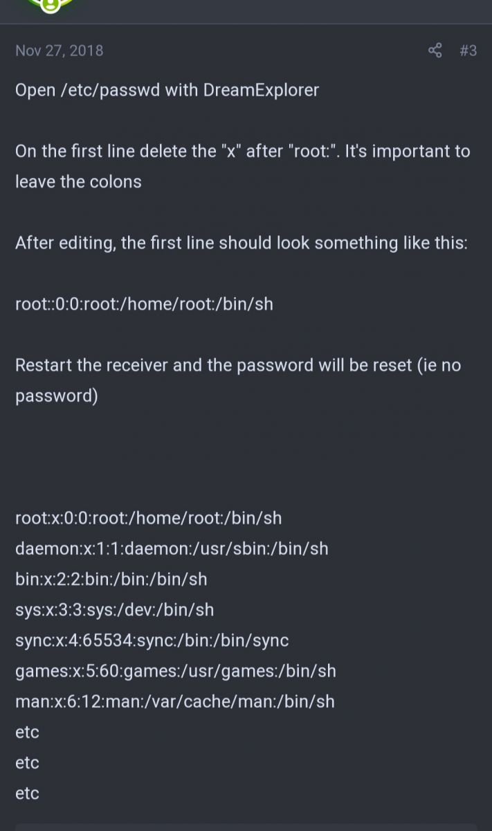

    Hello, I have a problem, I wanted to reset the password in Zgemma h92s because I did not know the password and found an advice as in the added photo, I did, i.e. I deleted the x in the link after restarting the tuner, I can no longer connect to DCC, PuTTy or openwebif, i.e. I go from the tuner's IP to openwebif but telnet or FTP no longer connects. All lines in / etc / passwd have disappeared. Now I can not connect to the tuner in any way to add new picons, for example. And it was supposed to help keep only root without a password. I also noticed that since then, after rebooting, it takes the tuner 5 mins to surprise with the channels, which always took a minute. Any suggestions?
    Zgemma H9.2S Connection Issue: Can't Access DCC, PuTTY & OpenWebif after Password Reset Attempt

    Unfortunately, it did not help, besides entering openwebif via IP, I can not connect via DCC, etc. login field pops up. I have openatv 6.4 Will uploading a new image help? Well, probably only that remains :(

    Basically then you have to follow the new system. Or, if you thought, restore the one from a backup. Then you have it easier.

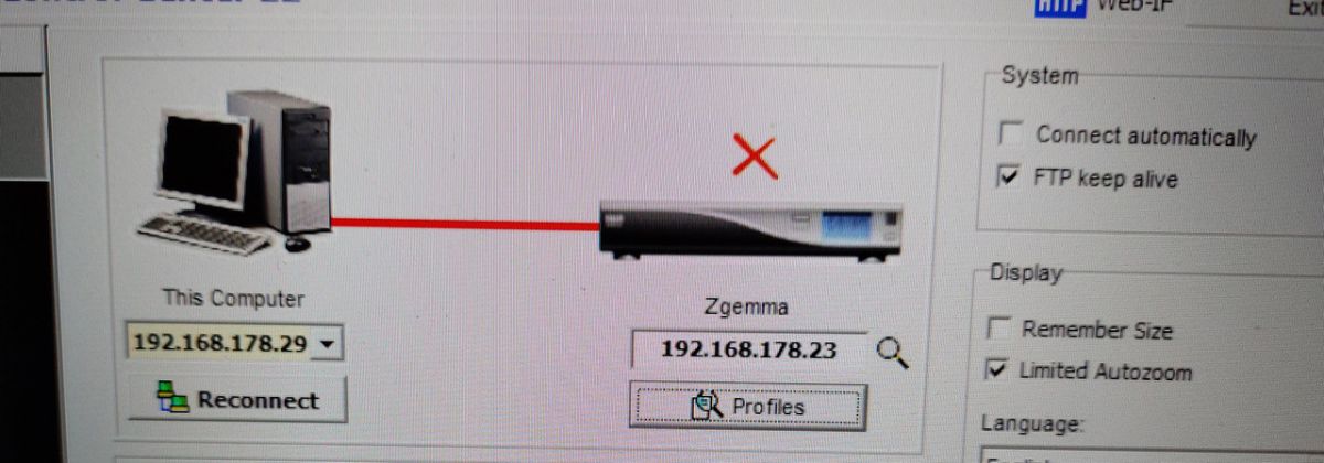

    I will join the topic as long as I can.
    I have the same Zgemma, I put OpenPli 8.0 on a fresh system from the developer's side.
    I set up wifi, the network test is ok, everything is green. And that's so much good because I can't connect in DCC or Total Comander for nothing.
    I set up a Zgemma profile with a password in DCC, although I did not do it for Vu and it connects in a flash.
    DCC search IP option does not even find Zgemma's IP.

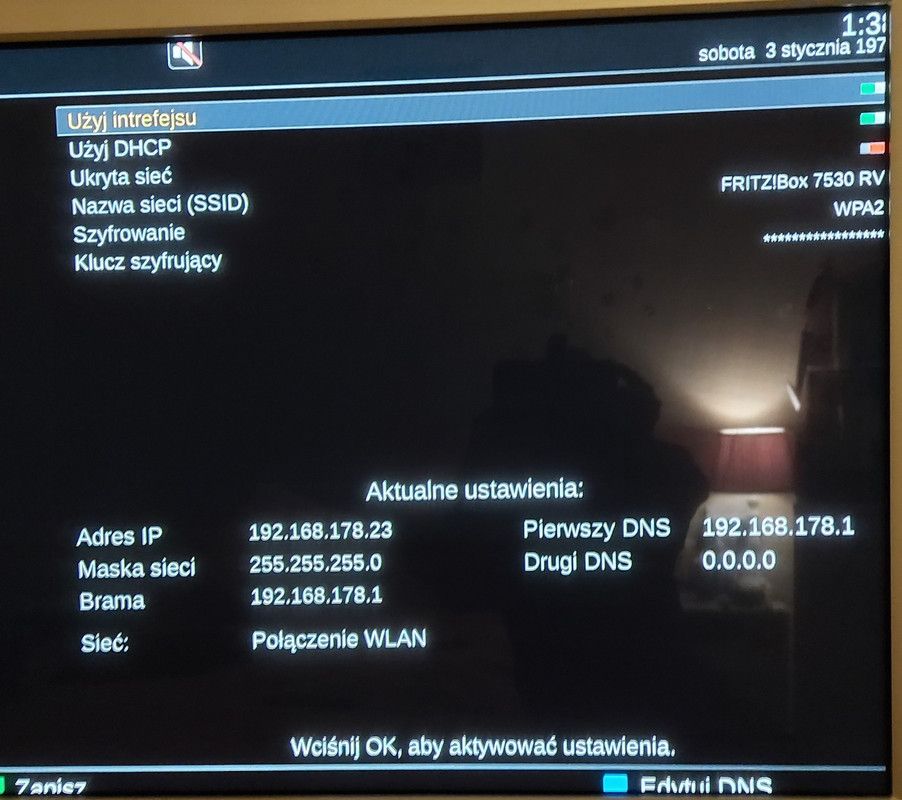

    Zgemma has the same IP as in the picture.
    This is Zgemma's configuration

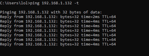

    Type in cmd then ping 192.168.178.23
    there should be something like this:
    Reply from 192.168.178.23: bytes = 32 time = 2ms TTL = 64
    If it is like above, you are connected with Zgemma.
    A password must be set in open PLI
    menu> setup> system> expert settings> network> password> setup your own password here for ftp & ssh> reboot.

    You are not connected to the net in a bad way
    this is how it should look correct (of course my tuner ip is different)
