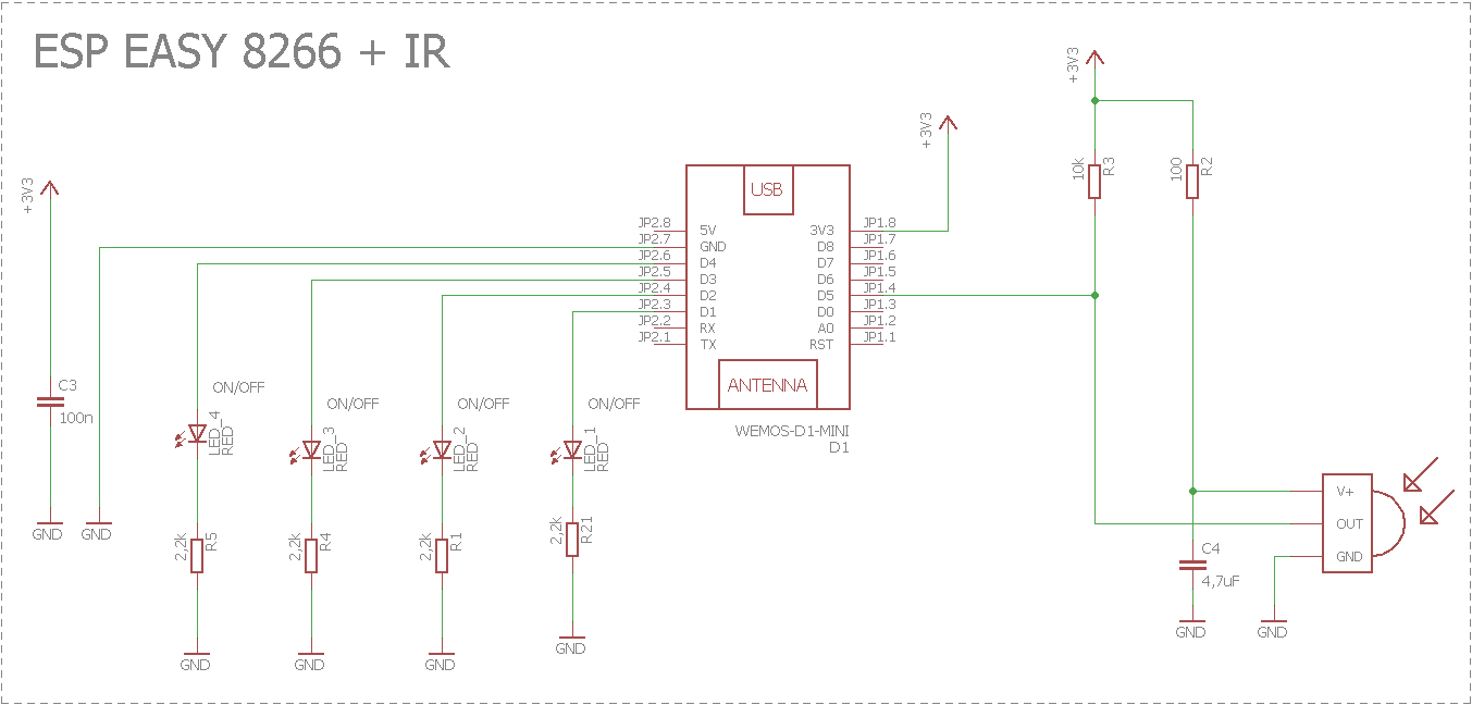

    I need help with a project. I have googled myself a Web Server. I have extended it with two additional channels of type: ON/OFF.
    Additionally, I connected an IR receiver to the circuit in order to be able to control the same ON/OFF channels with an IR remote control.
    For example: if I have the remote control handy at the moment, I press button "1" and switch the first channel on or off. And if necessary, using a smartphone or a computer via a browser, I do the same analogously.
    Circuit diagram:
    How do I integrate WebServer with Remote Control IR for ON/OFF channel control? .
    Porgram code:
    Code: C / C++
    I don't know how to make use of the two IF conditions.
    I would like the ON/OFF status to refresh automatically on the web page if I use the RC remote instead of the browser.

    Thanks for the reply, but I must have messed something up....
    So, has IR remote I press a button -> remote sends a command->receiver receives a signal->this in turn goes to ESP.
    Here I have the functions:
    Code: C / C++
    and wants to combine this:
    Code: C / C++
    it does not work for me :(

    I deleted that post because I didn't notice that output5State has some default value though. So my previous comment was pointless.
    I would start by giving Serial.println(results.value) for testing; then Serial.println(output5State) some more;
    I would start by giving Serial.println(results.value) for testing; then still Serial.println(output5State);
    Dear colleague - I don't quite understand what you mean....
    Code: C / C++
    I did this thing and there are no results on the RS port monitor:
    I am very much asking for help to complete the idea.

    I don't know exactly if this is what my colleague meant....
    Code: C / C++
    This is the kind of thing I've painted.
    I checked it, it doesn't work.
    The port monitor outputs something like this:
    Code: C / C++
    I hope I have stated my purpose correctly.
    I mean to write the function somehow like this
    Code: C / C++
    so that the state of GPIO 5 can be changed via the browser and in parallel with the RC remote control.
    E.g. through the browser I change the state of GPIO 5 from "0" to "1" and with the RC remote control I change the state of GPIO 5 from "1" to "0".

    khoam wrote:
    maystero wrote:
    E.g. via the browser I changed the state of GPIO 5 from "0" to "1" and with the RC remote control I change the state of GPIO 5 from "1" to "0".
    The state of the pins defined as OUTPUT and controlled by digitalWrite(), can also read with the digitalRead() function.
    Hint: digitalWrite(pin, !digitalRead(pin))
    I'm sorry, but I don't understand.
    Can you give me a clear example?
