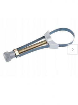

    Hello, I am trying to change the oil in my VW Bora 1.9 TDI. Unfortunately I do not have a wrench to unscrew the oil filter.
    Choosing the Right Wrench for VW Bora 1.9 TDI Oil Filter Change
    Will I unscrew this oil filter with such a clamp ?
    Maybe buy some other wrench?
    Thanks in advance for all the answers :) .

    I have one, used several times successfully. Check if your filter sticks out enough to put it on.

    Maybe better, but such a band wrench is universal and with it I will unscrew all kinds of filters....
    Filter in my car I wanted to unscrew by hand, but it was impossible, I think with this band wrench can do :)

    I've gone through all sorts of universal filter wrenches, and none compare to a self-made one made from a thick conveyor belt.
    You know what, in the workshop I have two cases of dedicated and several different universal. Clamp, chain stiletto, pliers and strap. And still more than once you have to combine. For one car, it is better to buy a dedicated wrench and already.
    Or once in a while pay those five grand for an oil change and get rid of the problem of a wrench, dirty hands and the hassle of oil disposal.

    @eurotips , you can see that you have no experience in this. If the can filter is tightened firmly in the dry, such a chain wrench will bend it, tear it to pieces and not unscrew it.

    Dedicated cap for this filter costs 20 zloty, what to lament here?

    Make yourself from an old belt, you will take care of the environment and stay for beer. :D

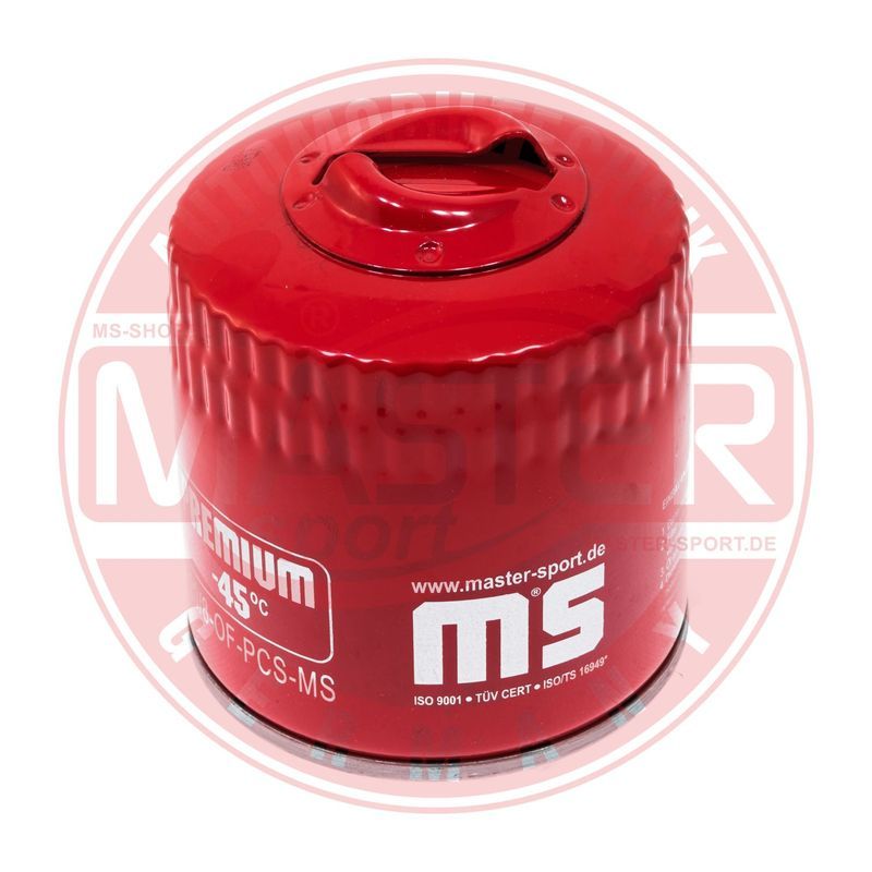

    Red oil filter by MS with a raised handle on top.
    At this point, maybe I'll ask here.
    How to deal with such a filter? The welded overlay can have the form of a hexagon - then you know, the key. But what, what key - when does it look like in the photo? Filtron makes similar overlays. They are made because the filter can only be accessed from the bottom, under the car, and next to it there is no room for a key, e.g. a chain, and it is difficult to reach it even with your hands (you can feel and turn it slightly, but not so much force).
    Is there any key to this?
