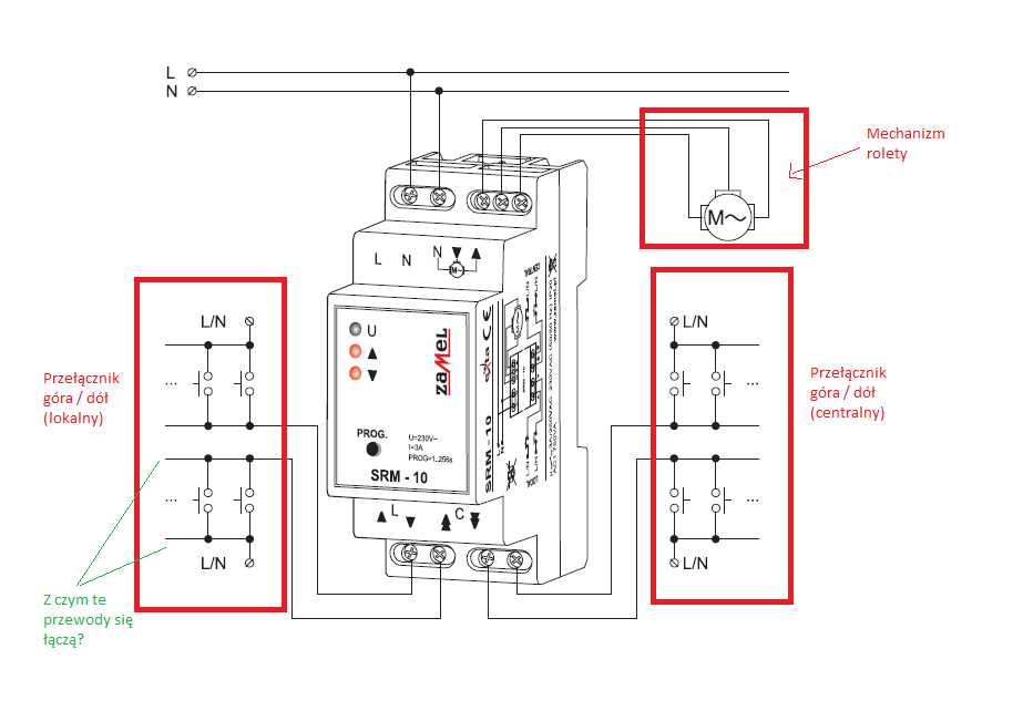

    What is the wiring diagram for one roller shutter using the SRM-10, as I can't understand it?
  • #3 18276505
    pimis
    Posts: 23
    Rate: 13
    www wrote:
    I've seen it, but I don't understand it:
    Wiring diagram for one roller shutter using SRM-10 - how to do it?
  • #4 18276524
    www
    Posts: 219
    Help: 7
    Rate: 13
    There, you can connect several control buttons in parallel if required.

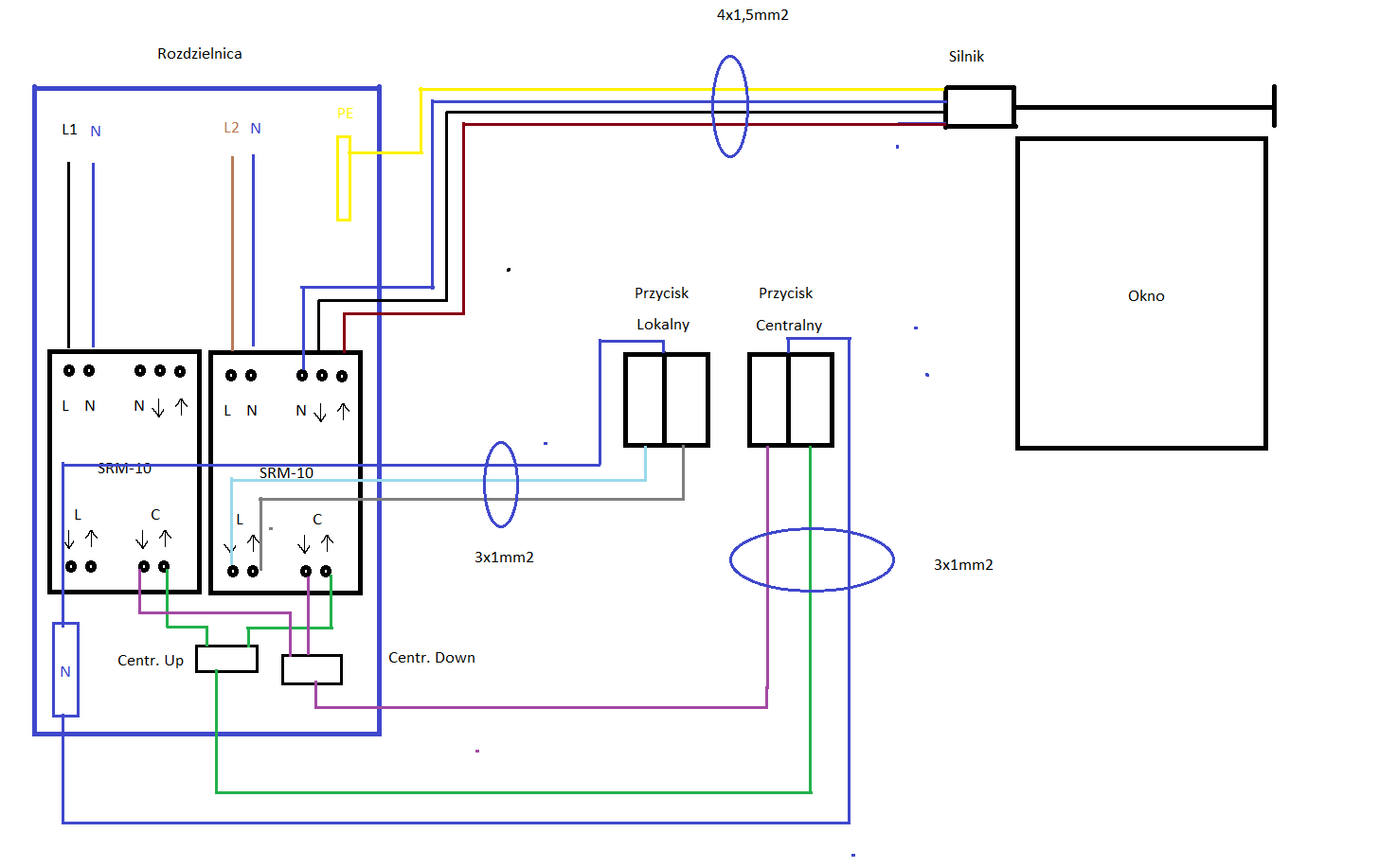

  • #5 18278205
    pimis
    Posts: 23
    Rate: 13
    Is such a scheme under the SRM-10 correct?
