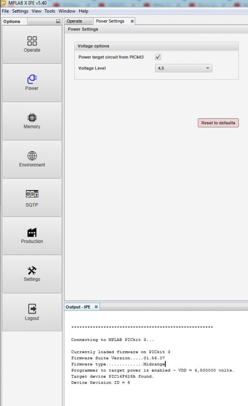

    Here I would like to point out that PICKIT3 it really supports a lot of layouts. Even AVR y:
    Tutorial PIC18F2550 + SDCC - Part 1 - Setting up the working environment
    (The screenshot above is from MPLAB IPE, myself personally programming Atmeg with help PICKIT3 I haven't tested yet).

    Just Pickit 3 can easily power the programmed circuit.
    You enter the advanced options and in the power tab you can select it.
    For me, when choosing 5V, he had problems, probably too low voltage from USB.
    So I gave 4.5V and there is no problem, programming works.
    The programmer itself has a VDD pin especially for this purpose.
