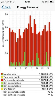

    Heating with electricity, electrode boiler 15 kW galan & # 8211; opinion and
    For me, your electricity consumption in January at 552kWh is not realistic.
    In January, my entire house used only 1500kWh from the 1500kWh network and I have an ordinary 6kW Kospel electric stove and everything on electricity. And you used up 1/3 of that with a stove twice as big? It's probably your house is 45m2, I will agree.
