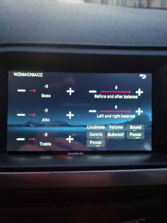

    Gentlemen, and I have this problem: I cannot set on the amplifier to play all the speakers. My left side is playing, and I can't set the right side. I have these settings:
    Audio amplifier screen with bass, alto, treble, and balance settings. .
  • #36 21398207
    damiancz
    Moderator of Car Radios
    Posts: 5006
    Help: 475
    Rate: 1409
    Archived topic - discussion has not taken place for over 3 years. Only add a reply if you have advice to add.
