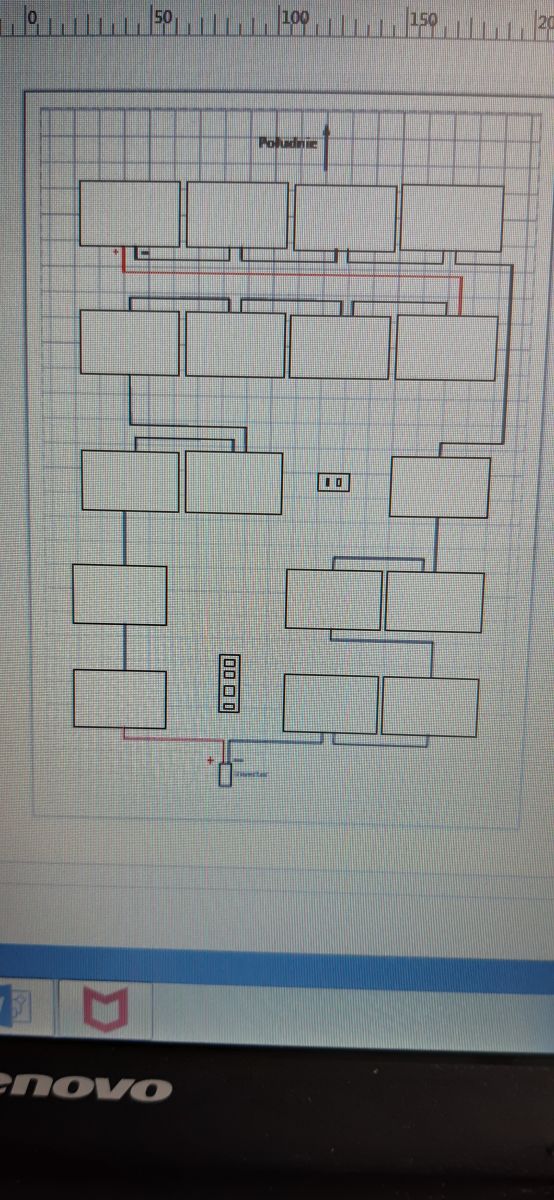

    Recently, when looking for answers about induction loops, I came across the following article:
    Real and significant mistakes made when making photovoltaic installations Link
    which raised a few more questions for me, but in order:
    1. Induction loop. Does it really matter and shouldn't be. My doubts were caused by this entry Link in which Longi Solar recommends connecting modules in a way that creates an induction loop. Unfortunately, in my case, the induction loops have also been created and I am thinking of submitting a complaint to the installation contractor
    2. Point 3 of the article: "Failure to make protective equipotential bonding" - do you have such connections made (unfortunately I do not have it, the structure is grounded, but not individual panels as in the article)
    3. Not installing an additional surge arrester when the distance between the panels and the inverter exceeds 10m. If the distance from the PV generator to the inverter exceeds 10m, an additional surge arrester should be installed at the panels. The limiter at the inverter remains unchanged - the distance for me is about 12-15 meters (to the first panel to the inverter - plus about 15 meters in the string) or should I have additional protection?
    4. Are the AC / DC protections correct? Induction loop, AC, DC protection and other questions related to PV installation

    This pic is illegible, but I don't see overvoltage protection on the DC side here

    I put in a clearer picture Induction loop, AC, DC protection and other questions related to PV installation
    (I see, it came out not entirely clear either, I'll try to insert better tomorrow)

    read it on the right with red overprint, probably disconnectors

    Mersen CUS101HEL 1000VDC 32A 10x38

    These are disconnectors, it comes out that there are three strings, what inverter? could DC overvoltage protectors be built in because there is no such board in this table.
    After AC, the type 1 and 2 arrester is OK. C20A protection, but why C and why four-pole and this off. differential-current 100mA what it would serve and DC / AC circuits should be separated by some marked partition

    3 strings, Fronius Symo 12.5 inverter

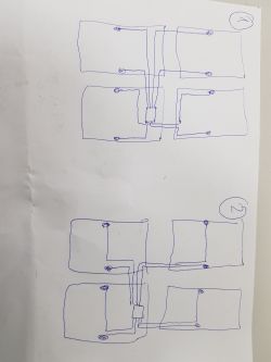

  • #25 19325550
    kddktech
    Gentlemen, what about induction look like with microinverters? Are both ways good or is case 1 creating a loop with each panel? Induction loop, AC, DC protection and other questions related to PV installation
  • #26 19325800
    3301
    Posts: 2100
    Help: 224
    Rate: 868
    I choose No. 2

    Well, only in the case of No. 2 you have to extend one wire on each panel and then there are more MC4 connections. I don't know what's better?

    If you have to add MC4 connectors, solution no. 1 will be better. These loops are relatively small and there are several loops of them instead of one big one. And in most cases, PV fires are caused by faulty connections of connectors or their poor quality.

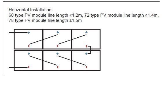

    Hello, I am setting up 9.9 kWp PV installations. 22 Longi 450W modules. 1 table 4 rows horizontally. There will be 6 modules in two rows, and two more rows of 5 modules. These are large panels as the dimension is 2094x1038 and they have 1.4m long wires.
    My question is how best to connect in order not to avoid induction loop?
    In the assembly manual, the manufacturer presents the connection diagram as shown in the picture.
    Will it be the correct connection ??
