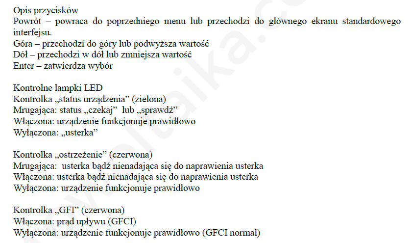

    I have had a PV installation based on the Sofar Solar 5.5 KTL-X inverter for some time. Today I noticed that the display blinks with three LEDs, periodically every 20 seconds. No production, panels covered with snow, temperature below zero. Is this normal behavior of the inverter or should I be afraid of a possible fault?

    jerry1960 wrote:
    What is written about this error in the DTR of the device. Here is the user manual, read https://ozetechnologia.pl/art/files/23
    Solar solar inverter all three LEDs blinking - cause for concern?1221.PNG (69.14 kB)You must be logged in to download this attachment.
    There is nothing in the manual about the possibility of three LEDs being lit or blinking at the same time, only single errors.

    Everything is OK.
    There is not enough light, the panels charge the capacitors in the inverter, then the device tries to start, but the energy is so low that it immediately discharges the capacitors and the device "dies" over and over again, until the insolation of the panels reaches such a moment that it is able to start.. .

    Leon444 wrote:
    Everything is OK.
    Leon444, it seems that it should indeed be. Now the inverter is inactive, i.e. it behaves as always after dark. It's just that I haven't observed such behavior with blinking LEDs before. Thanks everyone and best regards.
