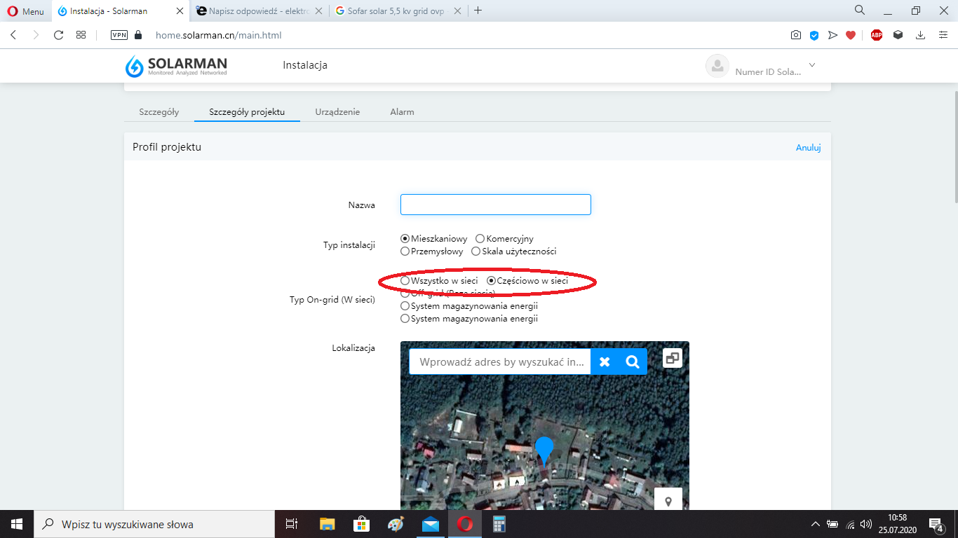

    Please give me a hint about this. I have had a wonderful micro-installation for 3 days. 5.5kw sofar inverter. What settings should be on the solarman website? Everything on the web? Is it partially online?

    • SOFAR 5.5K inverter, GRID OVP alarm Bez tytułu.png (304.79 KB) You must be logged in to download this attachment.

    It doesn't matter, I used to record it once and so and so, I didn't notice the difference
    I had a peek, on two I have everything and on one partially
