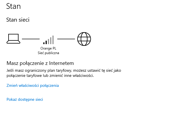

    Good morning
    The case is as follows, Laptop with built-in LTE modem (Lenovo X1 Carbon 2ndGen) when I connect to the Internet via Wi-Fi network, everything works without any problems, whenever I try to connect via LTE, the problem pops up as below. Such a message applies to every browser and every address, and the SIM card from every operator. After switching to Wi-Fi, the problem does not exist. When I use this card in an external modem, also no problem. The problem only affects the built-in modem. When connected to the built-in modem, the ping goes as needed to resolve the DNS name.
    A secure connection could not be established
    An error occurred while connecting to the server "www.orange.pl" PR_CONNECT_RESET_ERROR
    The page being opened cannot be displayed because the authenticity of the received data could not be verified.
    Please inform the site owners about this issue.
    More information...
    Has anyone had anyway?

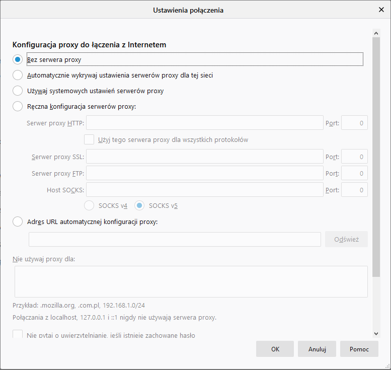

    You don't use any proxy servers?

    I don't use a proxy

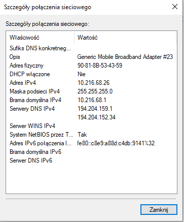

    Issue: PR_CONNECT_RESET_ERROR with Built-in LTE Modem on Lenovo X1 Carbon 2nd Gen Laptop
    The FTP connection also cannot be completed.
    I do not know if this is always the case, but the card normally receives an IP address, gateway and DNS from the operator
    but if I go into connection properties it looks like this.
    Changing to automatic does not give anything, after changing it looks for the settings and after turning the card off and on, the settings return to the ones on ss
  • #9 18383753
    czuker
    Level 25  
    Posts: 1017
    Help: 80
    Rate: 68
    The network settings look correct.
    This looks like a problem with TCP since ping works and websites or FTP don't.
    If this only occurs with a GSM modem, and the cable is fine, I would be aiming for the modem and its drivers.
    Have you tried updating them?

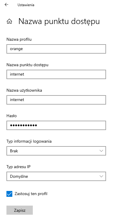

    matek451 wrote:
    And what's your APN set on this LTE modems for Orange?
    The APN seems correct
    Windows says the connection is OK

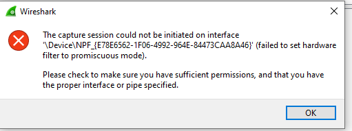

    From what DNS writes, i.e. UDP works, ping i.e. ICMP works. The problem is with TCP.
