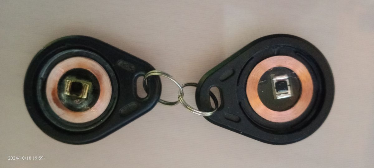

    Serwis_LX wrote:
    This works in that there is a coil of copper in the tag and a chip with a 'unique' number e.g. F6-55BE467F7E4-C3. Bringing it close to the antenna induces a small current and activates the chip
    Just to illustrate what is inside:
    Two key fobs placed close together, showing passive electronics inside. .

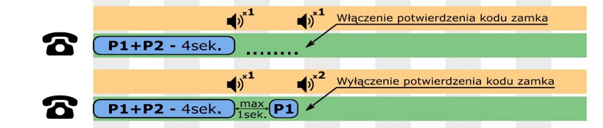

  • #44 21268721
    CYRUS2
    Posts: 18029
    Help: 1241
    Rate: 3530
    Pioter.K wrote:
    Thank you for the valuable information. I have already purchased this copier. I will still buy the programmable key fob and then it will be possible to restore the blissful silence when opening the door at 4am.
    In the PC-512 this can be switched off in the camera itself. This will also be disabled for the entry code.
    Diagram of turning on and off lock code confirmation on an intercom. .

    I have 4 key fobs. Two of them are assigned to the flat i.e. effect like opening with code. The other two do not generate such an effect from the very beginning. I have all the lozenges officially from the installer/cooperative.
    Added after 7 [minutes]: .
    CYRUS2 wrote:
    On the PC-512, this can be turned off in the camera itself. This will also be disabled for the input code.
    Well unfortunately this is not the uniphone used. Mine only has one button and nothing else.
