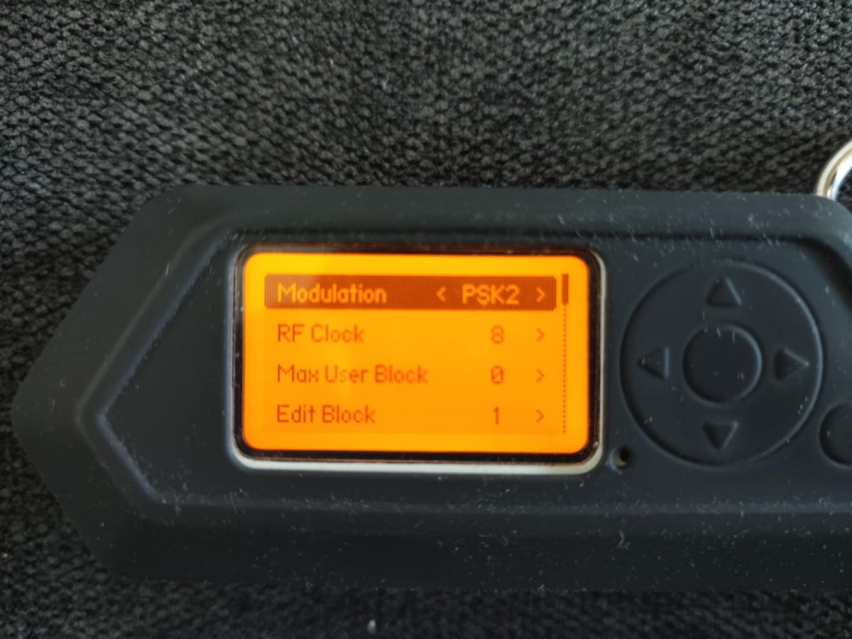

    Display of an electronic device showing modulation selection set to PSK2, with options for RF Clock, Max User Block, and Edit Block. >>21531414 .
    there is an option to prepare the chip for a specific modulation and number of blocks, it looks like the picture, In modulation there are choices:
    -direct
    -PSK1
    -PSK2
    -PSK3
    -FSK1
    -FSK2
    -FSK1a
    -FSK2a
    -ASK/MC
    -Biphase
    -Diphase
  • #66 21532021
    Interesant
    Posts: 2176
    Help: 204
    Rate: 249
    You have everything in the manual from Flipper and on youtube + datasheet of EM4100, EM4302 and T5577 chips
  • #67 21532310
    sociak55
    Posts: 60
    Rate: 15
    >>21532021 .
    If it was that simple I wouldn't be looking for help, I've tested many combinations and unfortunately none worked so I've asked for help here on the forum in the hope that someone has already dealt with a similar case and is able to give more suggestions.
