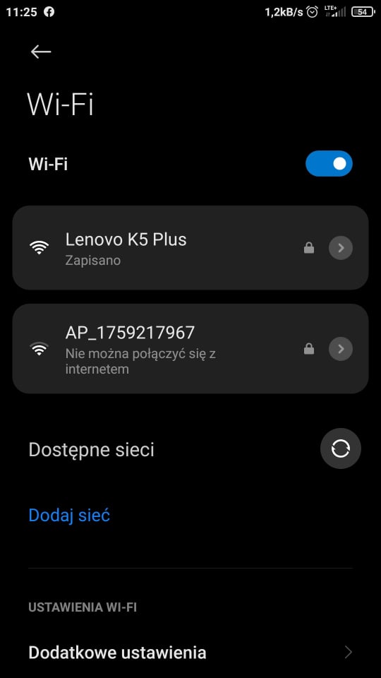

  • Need to manually connect the inverter WiFi network

    Can anyone help? I want to connect to the Solarman Smart App. I don't have a permanent connection at home.
    DeyeSun inverter
    I have 2 internet phones. One is in the house all the time, the marobic behind the wifi router. On the phone that I am using on the current basis, I installed the application and came to the device configuration point ... go to the WLAN network settings and manually connect the network (inverter). I click connect ..... a list of available WIFI networks opens ... and I don't know what to do next.
    Can anyone help?
    Will there be any of this?

  • Set inverter address to 01 for WiFi communication
    #44 19823852
    dominikobarski
    Level 4  
    Posts: 6
    bodek256 wrote:
    Except that the logger did not see the inverter, the problem was solved. I had to change the inverter code to 01 in the set address settings and then the communication between the inverter and the wifi module started.
    Now I have another connection problem. After logging in to the application, everything is fine, but after approx. connection crashes. I will try to set a static address and DNS to google in the repeater.
    Thank you for your commitment and help.
    Hi, I did it. I do this to you so that the connection does not fail. I also have a problem like ok and after some time the application does not connect to the inverter
