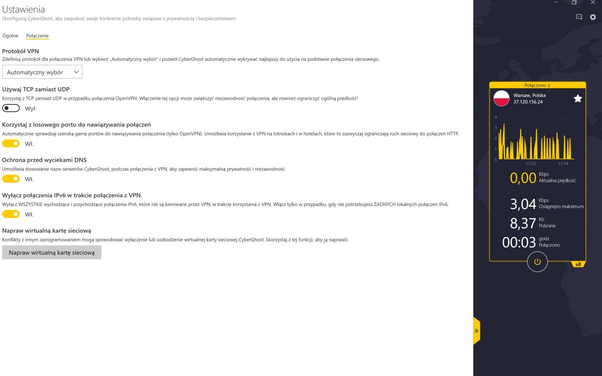

    Hello, I bought a Cyberghost subscription some time ago. I select the server in the program to connect and it connects without a problem, but immediately after connecting to the server, the internet does not work. What could be the reason? It used to work fine for me before and now it doesn't :( I have two computers and both are not working when connected to the server. Computers connected by LAN cable. Windows 10
    Help :(

    I don't understand the question, I always fired this program, it connected to the server I selected in the program and from then on, whether in the browser or in the communicator, I had internet. I'm translating this into peasant reason because I don't know. I am sending a screen with ip config and program settings, maybe something is wrong there: / \ [/url] Internet Connectivity Issues After Cyberghost VPN Connection on Windows 10 Internet Connectivity Issues After Cyberghost VPN Connection on Windows 10

    The VPN connection is missing from the default gateway configuration. It's likely that the VPN connection modifies the routing table and tells it to push all traffic through the VPN interface. But the VPN interface doesn't have a default gateway defined, so it doesn't know where to send it. The default gateway should be with DHCP. Check in the interface configuration if it is enabled that all data should come from DHCP.

    Problem solved :) in the properties of the physical network card, I unchecked the IPv6 protocol and somehow it magically started working
