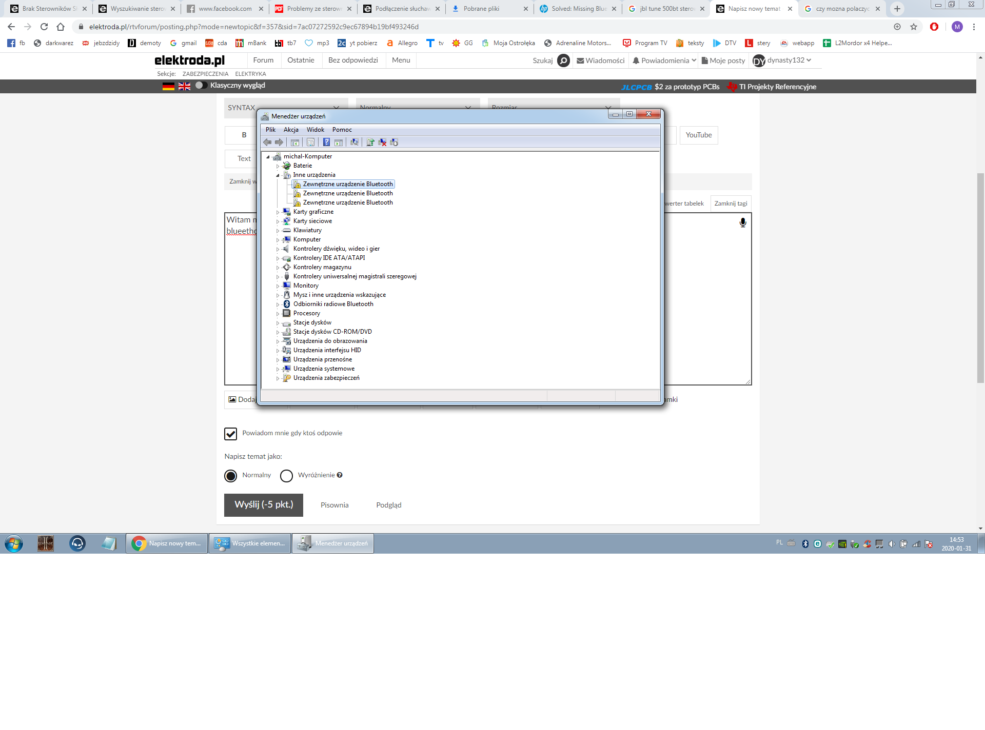

    Hello, I have a problem with connecting the headphones to a laptop, bluetooth can see them but cannot install drivers for them, I also did not find them on the official jbl website. Please help. In the attachment there is a photo from the device manager
    • JBL TUNE 500BT Headphones - Unable to Connect, Drivers Missing on Laptop & Official Website bb.png (175.72 KB) You must be logged in to download this attachment.

    I tried to use it, but it is not up-to-date, namely you cannot download these drivers for free, or I do not search for them because windows 7 is no longer supported. Is there anyone here who has already connected these headphones to his laptop?

    What is this laptop?
    Yep, they are BT 4.1
    I think I have BT 4.0 in my laptop
    https://www.elektroda.pl/rtvforum/topic3609060.html
    Added after 15 [minutes]:
    dynasty132 wrote:
    I tried to use it, but it is not up to date, it is impossible to download these drivers for free,
    Maybe.
    Ever participated in some discussion about drivers for BT 4.?
    https://www.elektroda.pl/rtvforum/topic3532323.html#17649799

    I don't know how, but by some miracle I got to the point that I connected the headphones and I can record the sound and play back, but it is a tragic robot connected with playing the guitar, if you know what I mean. there is evidently a rudder still missing. someone something ?
    I will only add that when I pair with the phone, the sound is perfect

    Here's how I solved the problem with connecting the JBL Tune 510BT headphones to a laptop bluetooth for Windows 7.
    The headphones could be seen through the laptop but played no sound.
    Steps in points (BT = Bluetooth):
    - turning on the BT module in the laptop
    - removal of existing BT devices stored in Windows
    - uninstalling existing BT drivers
    - restarting Windows,
    - downloading ORIGINAL BT drivers for our laptop specifically from the manufacturer's website,
    - driver installation
    - restarting Windows again
    According to the video below (https://www.youtube.com/watch?v=RrD3rVDsX2I)
    - Start -> enter services.msc in the search (enter all) and run
    - find entries that begin with the word Bluetooth
    - in each of them enter Properties, set it as AUTOMATIC, Apply, Stop-to stop, Start-to start, OK, after closing the window, right-click on the modified service and give Restart,
    - restart Windows,
    - reset the headphones by pressing the and - buttons simultaneously on for about 5 seconds, they will emit a sound,
    - enter the Bluetooth settings, search for the device, click its icon and Windows should automatically switch the sound to the headphones and after turning them off, the sound automatically returns to the loudspeaker.
    That's how it worked for me and it still works :)
