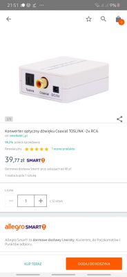

    You have an optical output in the console, so a Toslink (optical) -RCA converter, an optical cable and an RCA to ... adapter (write about speakers).
    Then, in the console, change the audio output to optical.

    Which input should the optical cable connect to? Xbox One S: Connecting External Speakers to Console with HDMI Monitor - Tips & Guide
    #4 18458482
    sosarek
    Posts: 83875
    Help: 9320
    Rate: 15532
    Both in the console and in the converter it will fit only one type of socket (SPDIF in the console, Toslink in the converter).
    Additionally, you need an RCA-mini jack cable, such as https://allegro.pl/oferta/kabel-mini-jack-3-5mm-2-rca-cinch-aux-audio-wtyk-7259265959

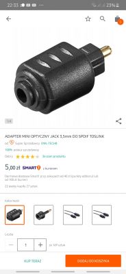

    And can there be such a thing? Xbox One S: Connecting External Speakers to Console with HDMI Monitor - Tips & Guide
    #6 18458576
    sosarek
    Posts: 83875
    Help: 9320
    Rate: 15532
    No, the usual optical cable, converter and adapter I mentioned.

    Okay, why can't this adapter be?
  • #8 18458588
    sosarek
    Posts: 83875
    Help: 9320
    Rate: 15532
    Because it's an ordinary Toslin to optical jack adapter - you had what you need written, so I don't know why you can't understand it.
