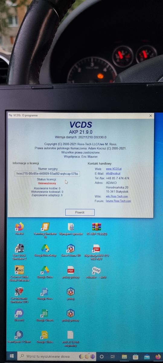

    I bought VCDS from Aliexpress version 22.3 EN APK. Maybe someone would be so kind and help me install it.

    You install the program without a cable connected and do what the Chinese wrote in the manual, without running the program after installation. Then go to the car with the computer and cable. There, after connecting the computer set, cable, diagnostic socket and turning the ignition to ignition, the program should be run for the first time. In the program, select the USB connection type, press TEST and save the setting. After that it will be roughly usable. And the Chinese certainly mentioned in the instructions and probably on the stickers not to have the Internet turned on. Because the software of the system in the cable may crash.

    The installation itself is very simple - just read the instructions included with the program,
    Speaking of this topic, after installing the AKP 21.03 version, it does not recognize the car - and it is an Audi Q5 2019 - maybe someone knows whether it depends on the software version or the cable itself?
    Will using a newer version than the dedicated one (i.e. AKP22.03) actually damage the cable?
    It`s probably the cable`s fault, check it on the car below, say 2017. If it functions normally, the Q5 will require a version of the so-called cable. Real Hex V2.
    Offline installation should not "seize" the cable, while online updating will "put it out of use" 100%.

    I connected it to an Audi q5 from 2010 and it works, and from 2019 it connects to the modules but shows the information: "Vehicle unsupported. Consider replacing the interface."
    What I noticed is that when running vcds, a window with the message "Loader failed 2" appears, but the vcds window starts normally and tests the connection OK.

    This would be true, because the Chinese use a different type of "Loader" for the Real Hex V2 cables.
