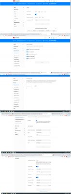

    Hello, for 2 years I have been using a Huawei mobile router with a battery for a sim card, connected to the TV via USB non-stop. I have a stove, monitoring, WIFI alarm. I heard that the HUAWEI4GROUTER 3PRIME Router is a very good device and at least 4 times more expensive than my mobile, well-functioning predecessor. I bought it, in a single-family house, the range is full, I will leave the house, losing the network. The cameras cannot be configured because I do not have coverage. My question is whether for the connectors on the 3prime MAIN DIV router for antennas, if I buy an antenna, it will improve the quality significantly? or just send back and buy something else. The router for PLN 200 is better than the flagship for PLN 800? Is it worth buying an antenna or choosing something else?

    Hello, for 2 years, this monitoring worked for me on the old mobile router. Only after replacing the router do I have problems. So I don't think my solution is wrong.

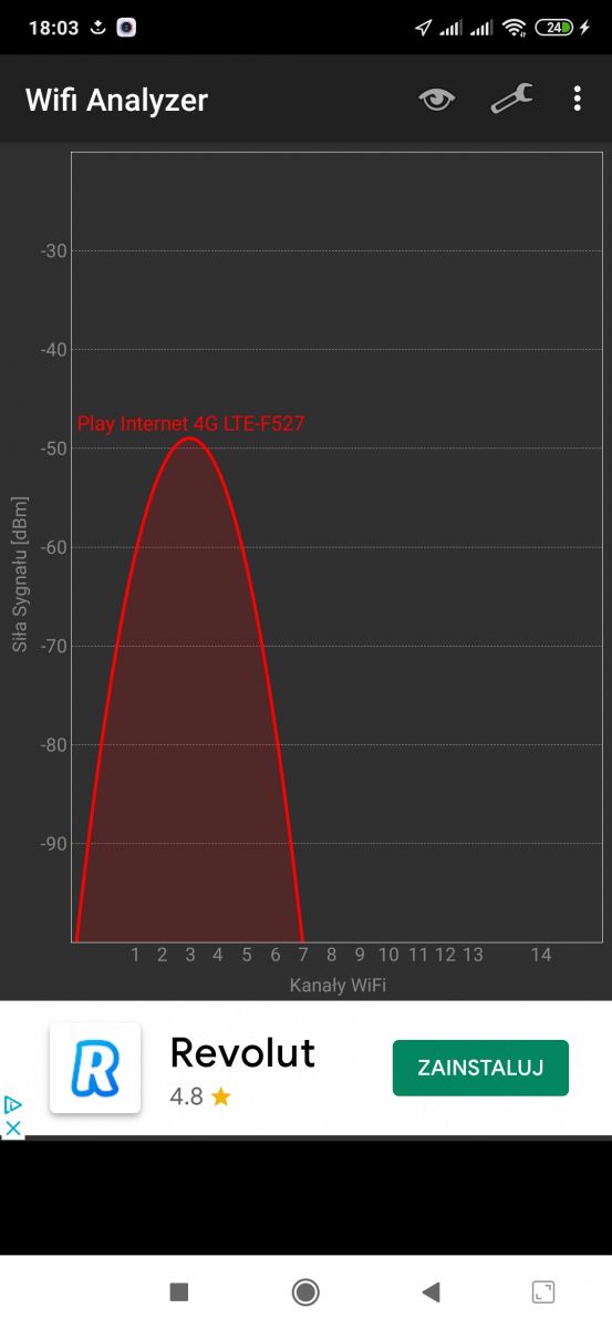

    molskyka
    Posts: 20
    Improving Huawei 4G 3 Prime Router's Coverage with Antennas: Is it Worth the Investment?
    I have no idea about these address pools. I am interested in wifi coverage which is weak outside the home unlike Alcatel

    Do not make a joke, what you showed are the WiFi signal parameters on the phone from this Alcatel in a place where you have a camera connected to Alcatel outside via WiFI? And how does PLAY internet work on this ALCATEL, speedtest show.

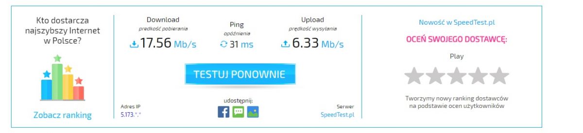

    molskyka
    Posts: 20
    This is the test result.

    As for PLAY, not much, and now the same, but on B818 and a screen with information about the device after logging in to 192.168.8.1 in the case of B818, you use Hmanager or LTEinspecteur to manage LTE bands and signal diagnostics on them, it is a primer for each user HUAWEI HiLink. Low UL is also indirect evidence of poor signal parameters inside the house. In the aggregation of 4 CC CA in PLAY, you can get high speeds after ensuring the correct signal on 1800-2600MHz, even now when people are sitting non-stop on the Internet https://www.speedtest.pl/wynik/236407328

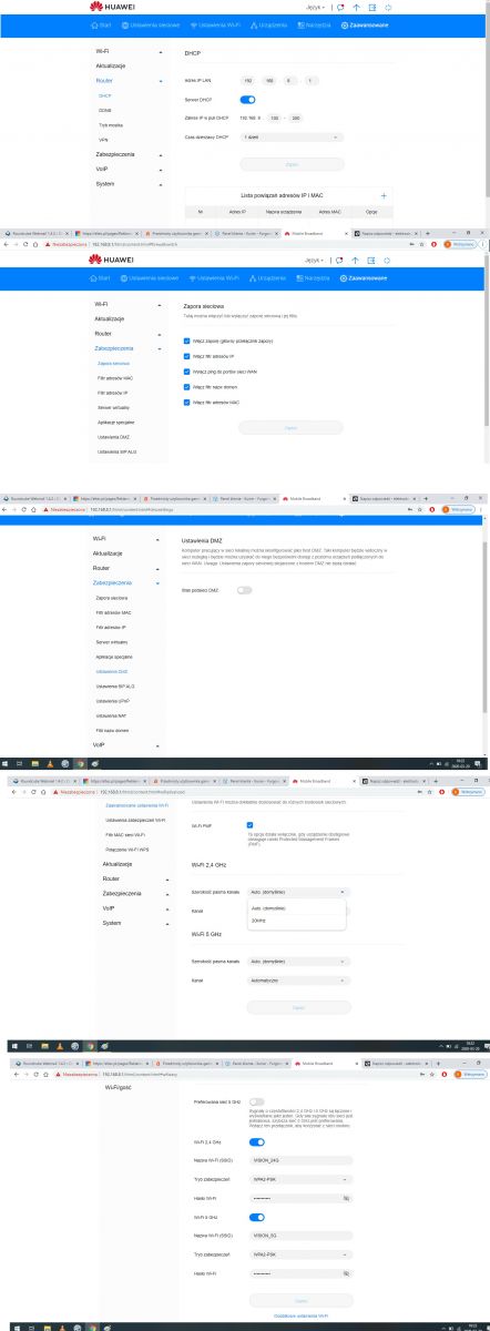

    molskyka
    Posts: 20
    After logging into the router, I have the following options.
    I generally leave the house and the phone is not catching my WIFI
