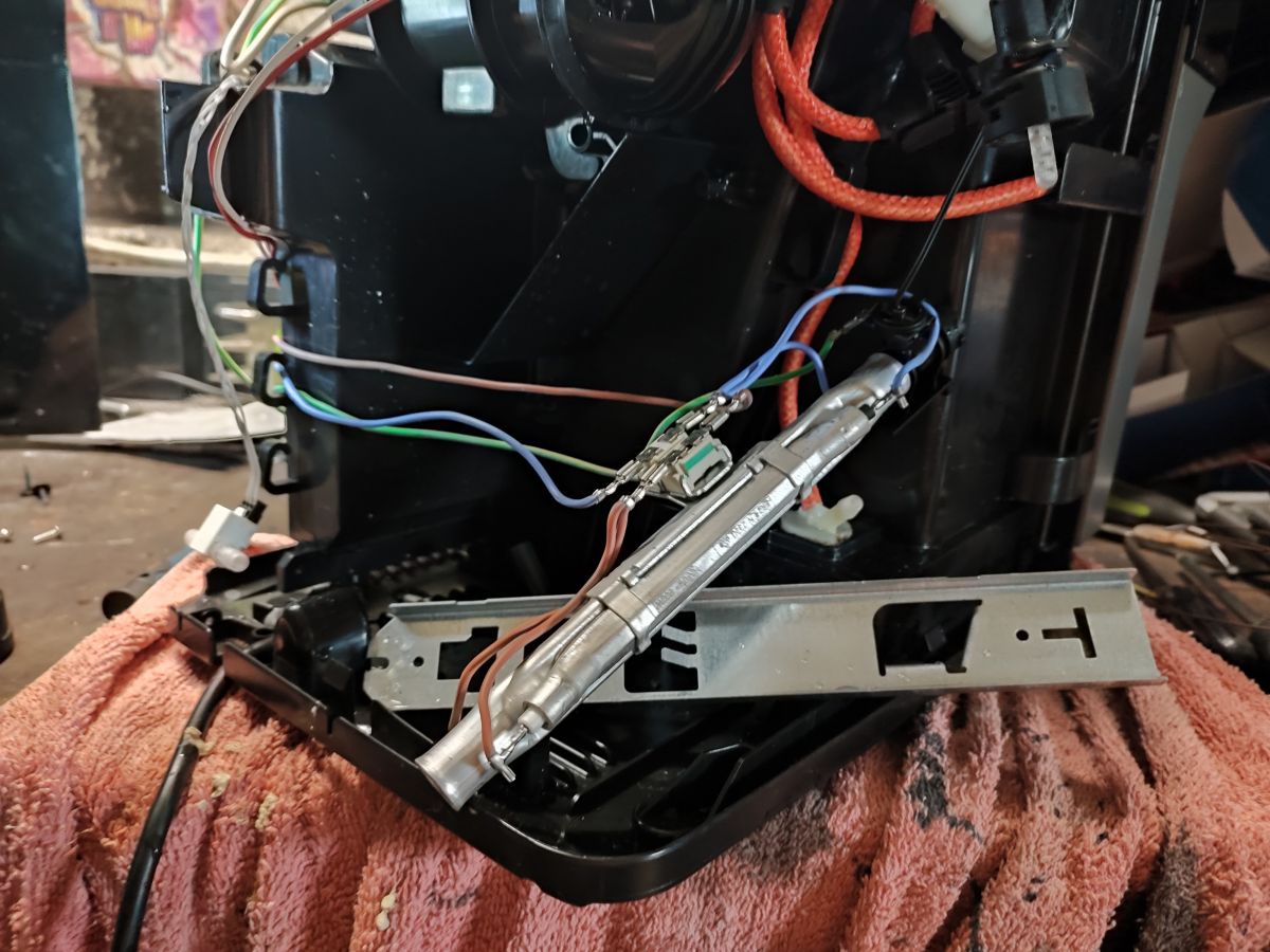

  • #20 20714299
    thomas__1
    Posts: 646
    Help: 50
    Rate: 145
    In my case, the heating element was completely clogged with limescale. Fortunately, it can be taken apart. I managed to remove half a teaspoon of limescale from it. There’s also a connector with a silicone filter at the outlet of the heating element. That was clogged too.
    Photo of a disassembled device with a visible heating element and wires. It rests on a pink towel.

    radeks1968
    Posts: 735
    Rate: 420
    With these heaters, it’s only this filter that’s a bit of a rarity, though you never know what might turn up.
