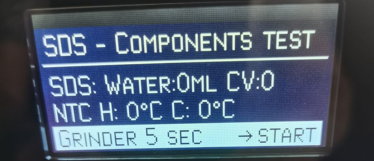

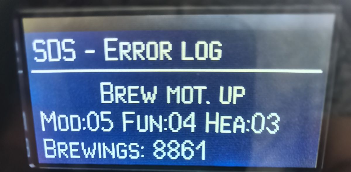

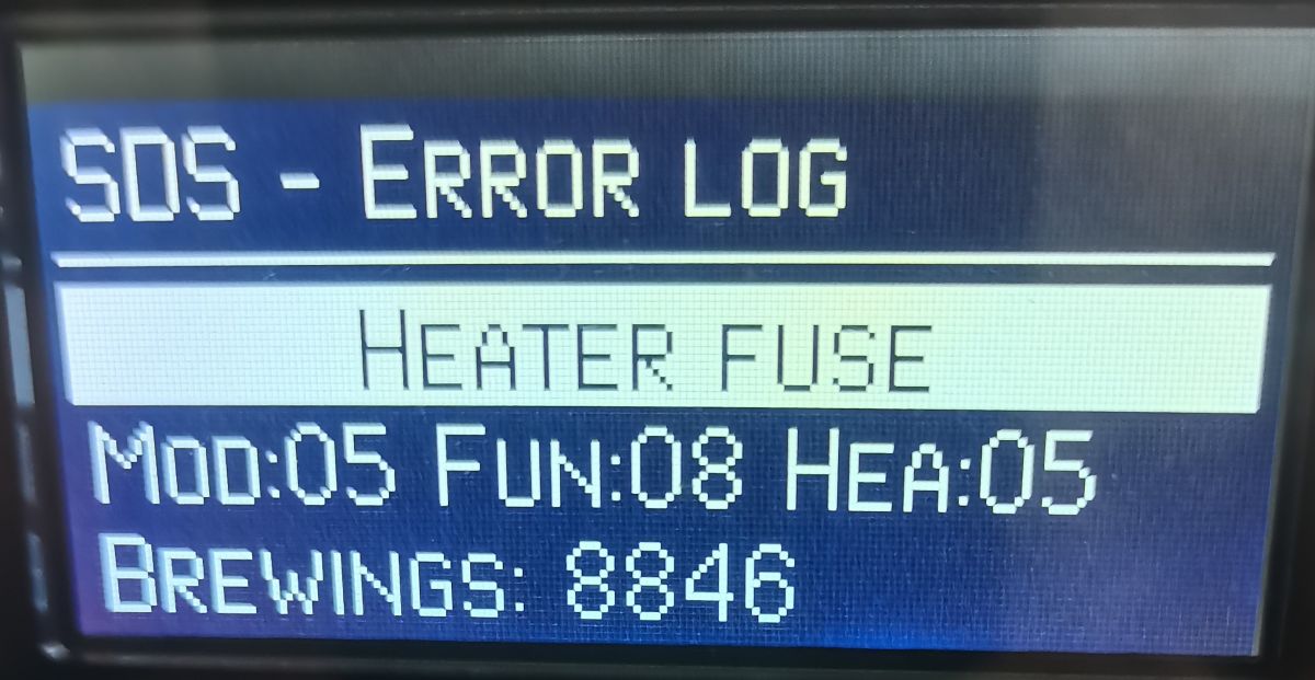

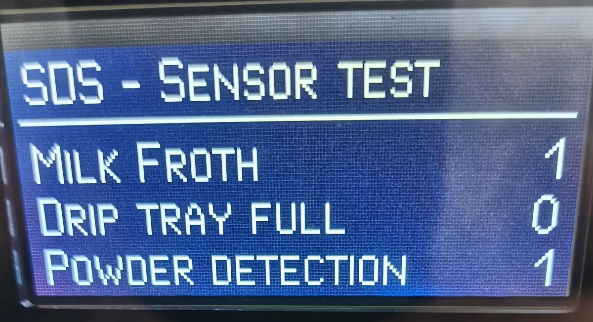

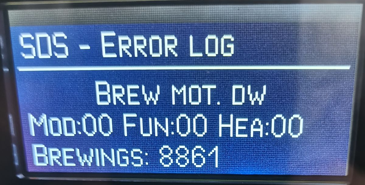

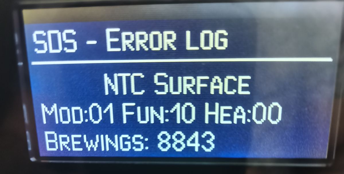

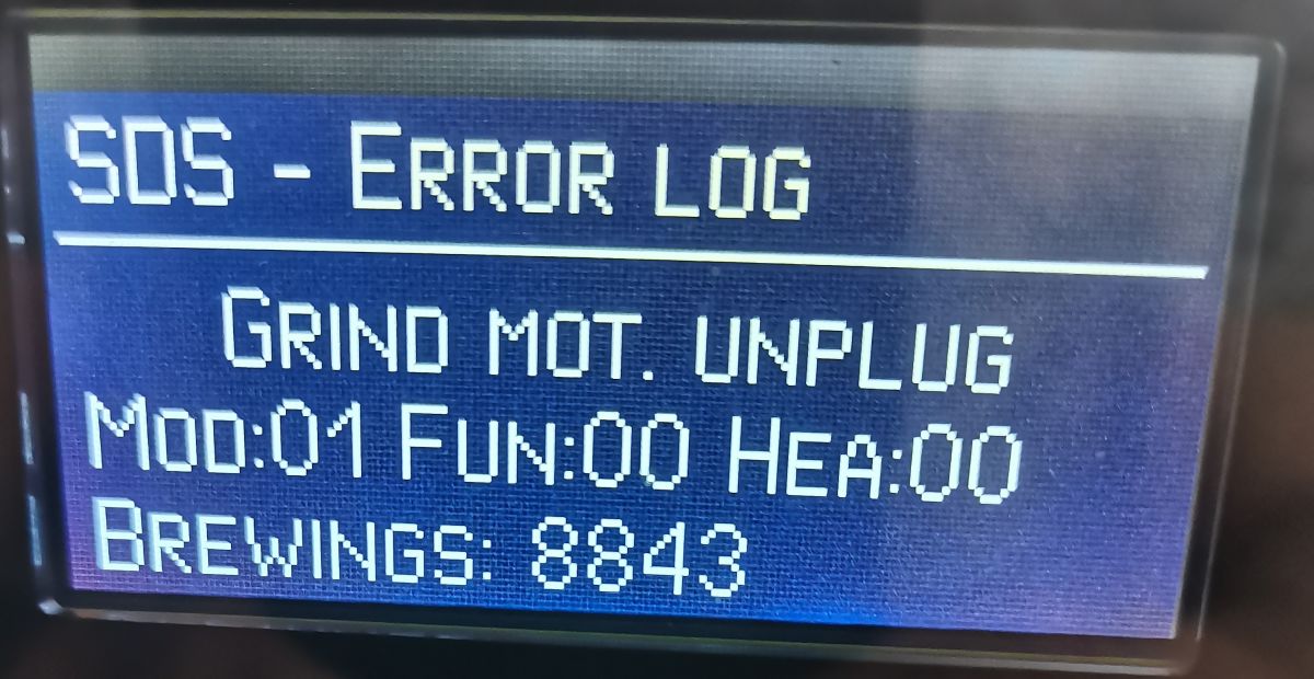

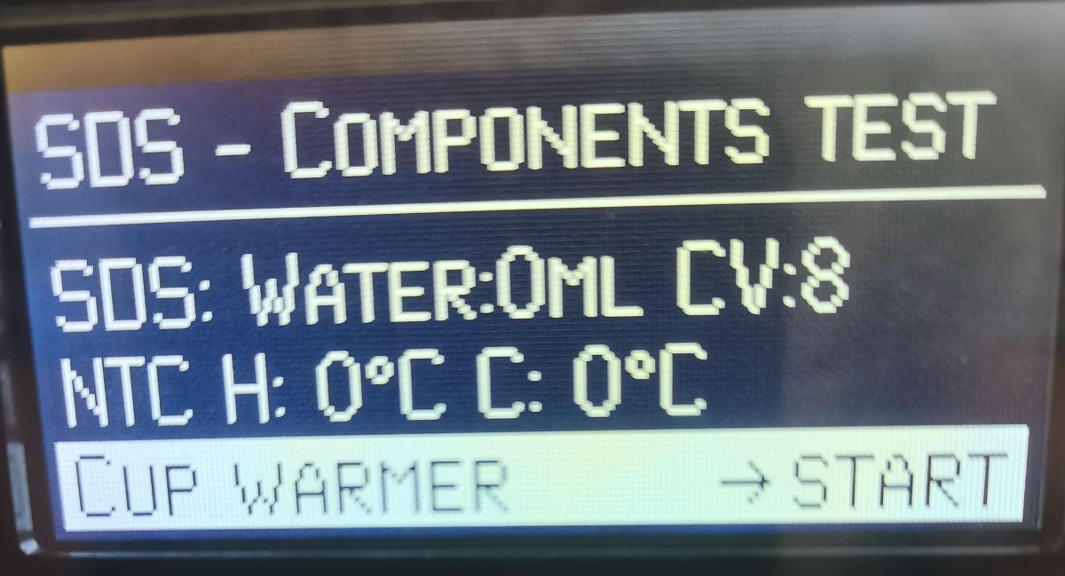

    I am the owner of the Siemens EQ.8 (model TE803509DE/05). The coffee machine worked very well after that I got intermittent messages (restart the machine) and now as soon as I turn it on I get the message restart the device
    Do you have any idea of the problem?

  • Suspected ceramic valve fault; test with 12 V and DMM

    After searching the internet, I would guess that it is most likely the ceramic valve. You will need a 12-volt power supply and a DMM with conductivity test to check it outside the circuit (motor, micro switches). Would you try reading a German forum using google translate or deepl.com? (Maybe a "hit" or at least "near hit"?)

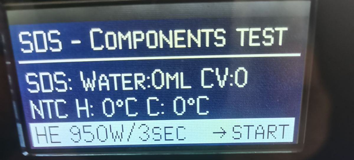

    Please check the heater, i.e. NTC on the heater and temperature limiters.

  • Suggest running component test and checking heater/NTC

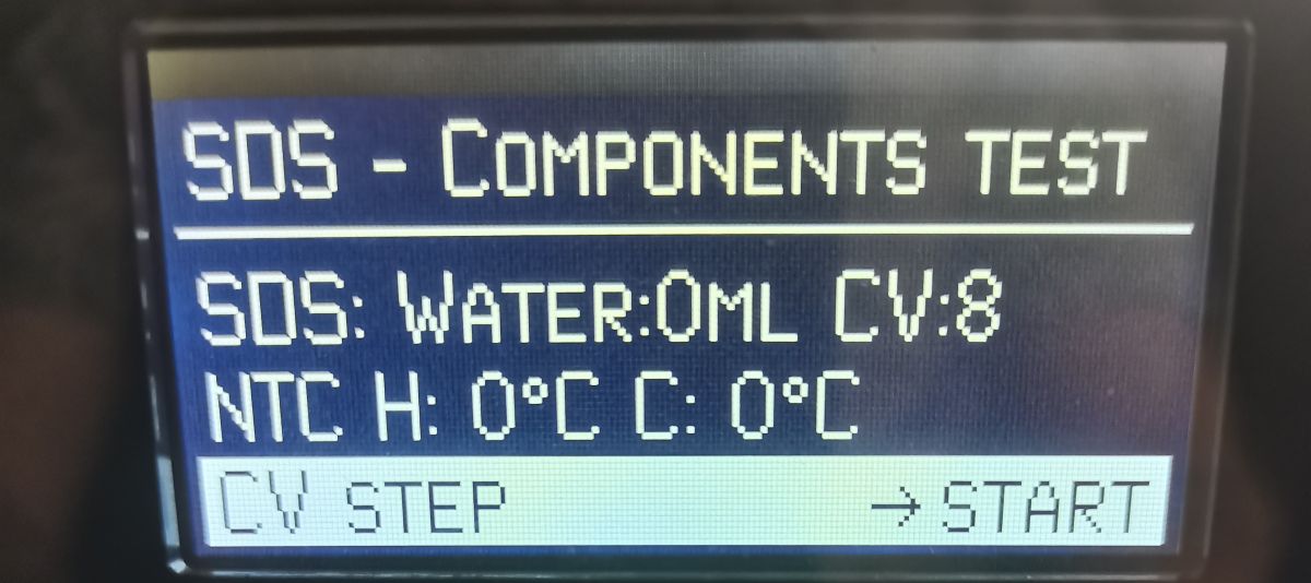

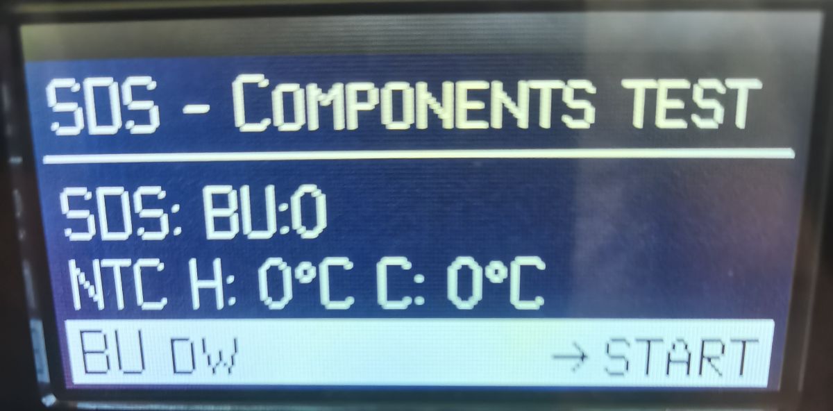

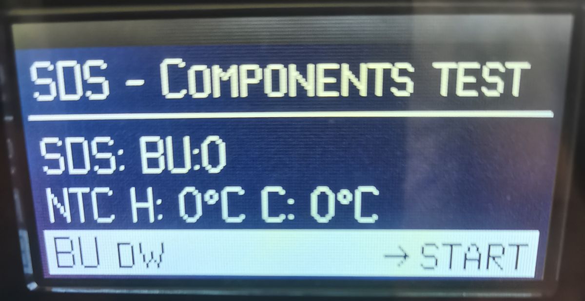

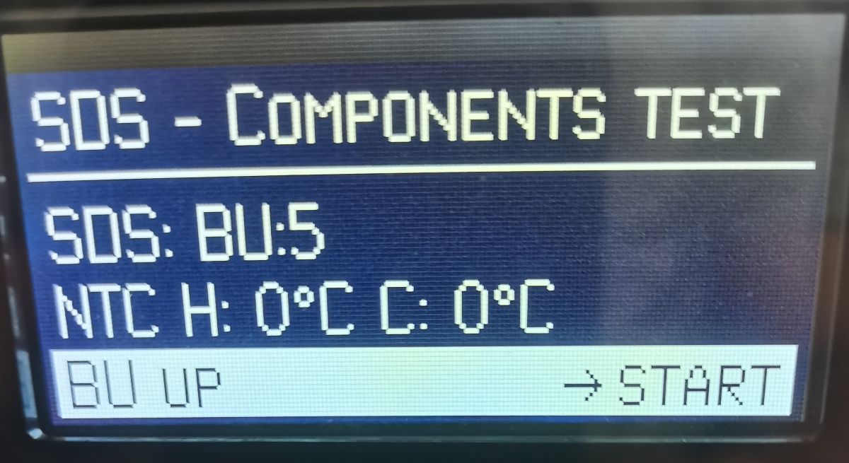

    Before opening the device, you might also run the CV through each step in the component test, as seen in your picture

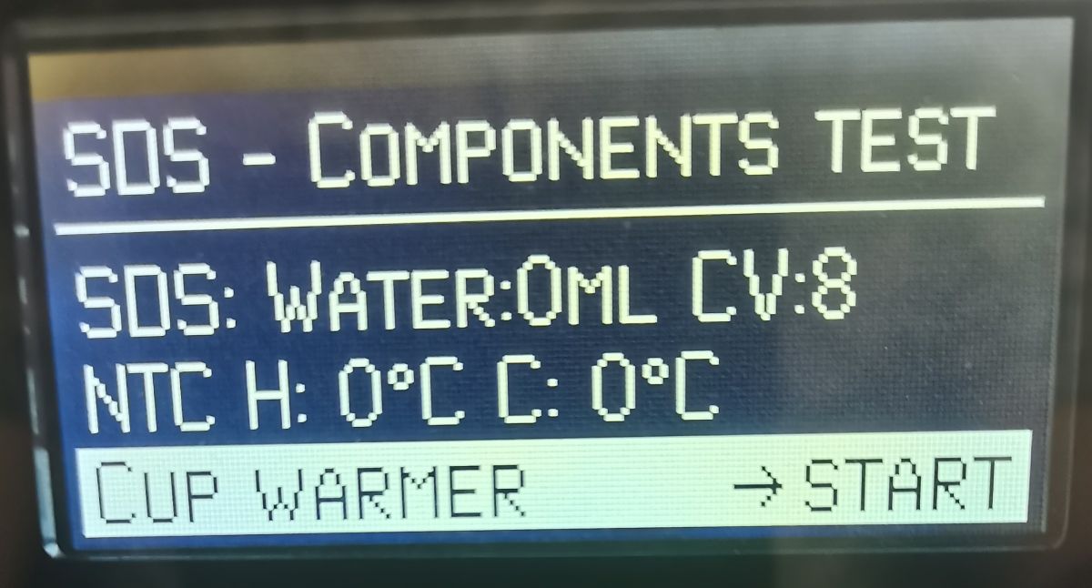

    Display showing SDS component test including heater and NTC temperature information.
    Testing the heater is a good idea, too. Seems user ssss has experience in this.
    Close-up of a device screen displaying a components test.
    I don't know whether the NTC-data is correct and should change during the test. 3 sec isn't much... (Make sure that the boiler is filled.)

    After all, it says there is no NTC temperature of 0 degrees.

    Okay, that's a plausible explanation. I have to admit that I didn't realize this at first and that I was fixated on the error message. I didn't realize that the NTC also reports near room temperature. I could just see that in the service menu on an EQ.9...
