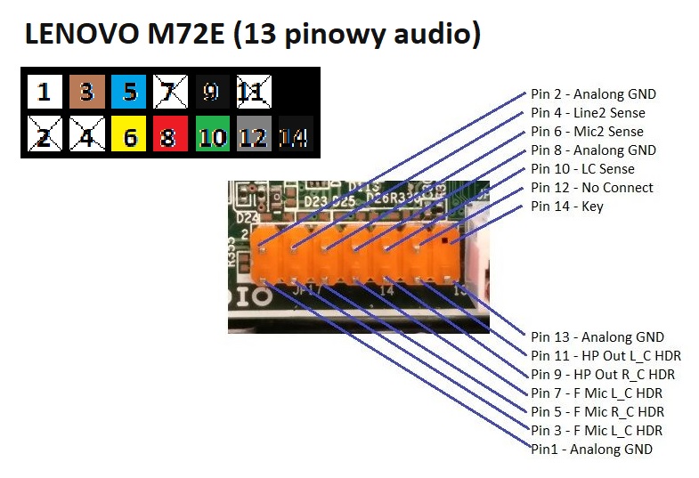

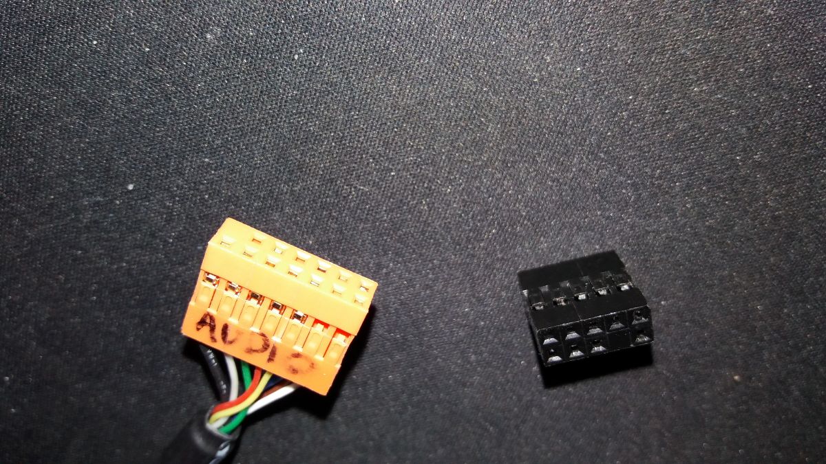

    Hello, how to properly connect the 13-pin orange Audio plug from LENOVO M72E to the standard 9-pin HD Audio (black) so that it correctly detects devices in the headphone and microphone jack. The 13-pin orange plug has 9 wires, it should fit the standard 9-pin HD Audio, but the connection descriptions differ. I would like to ask for clarification of all knowledge on this subject. Best wishes.

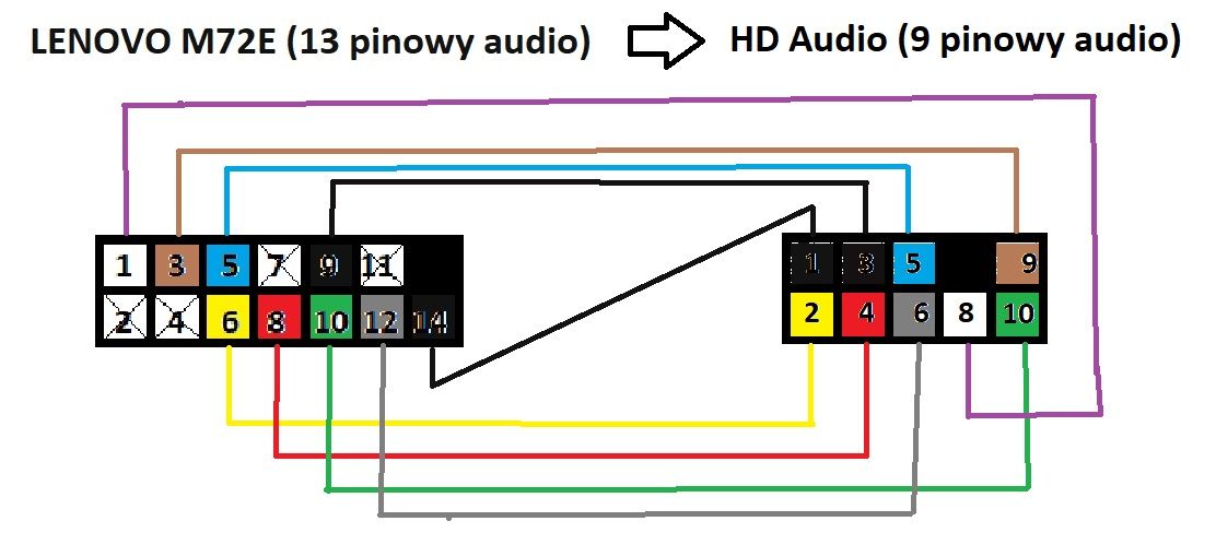

  • #3 18551521
    luk144pl
    dzarok wrote:
    Can you check if I`m doing it right?
    1 to 8 - Jack presence signal send
    3 to 9 - Line out jack presence return
    5 to 5 - Mic in jack presence return
    6 to 2 - Mic in bias / left
    8 to 4 - Mic in signal / right
    9 to 3 - Front panel presence return
    10 to 10 - Line out left
    12 to 6 - Line out right
    14 to 1 - Ground

  • #5 18551944
    luk144pl
    Thank you darok for your help. Topic to be closed.
