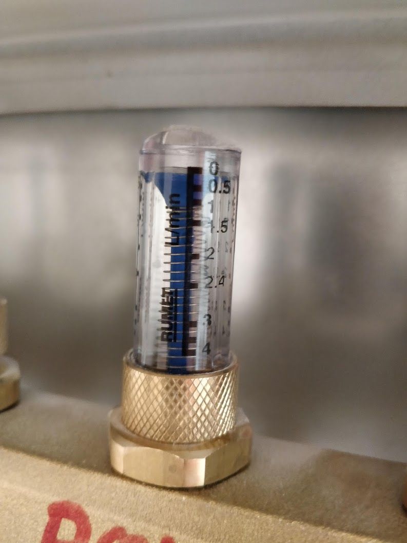

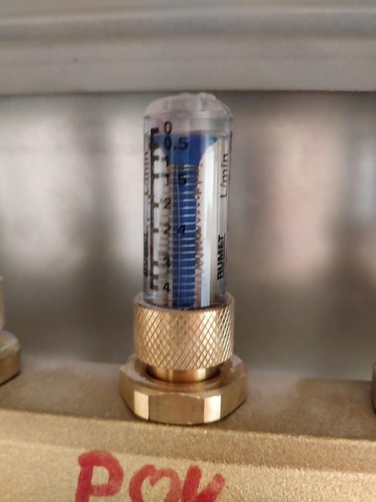

  • #12 18592310
    kulfi82
    Posts: 175
    Help: 9
    Rate: 58
    Board Language: polish
    Colleagues, this is how the distribution looks like. Zero reaction to any movement. Zero reaction to turning the boiler off and on.
    Rotameters Not Responding: Underfloor Heating System (Vaillant EcoTEC Boiler) Flow Regulation Issue Rotameters Not Responding: Underfloor Heating System (Vaillant EcoTEC Boiler) Flow Regulation Issue Rotameters Not Responding: Underfloor Heating System (Vaillant EcoTEC Boiler) Flow Regulation Issue Rotameters Not Responding: Underfloor Heating System (Vaillant EcoTEC Boiler) Flow Regulation Issue
  • #13 18592358
    zales.vip
    Posts: 1179
    Help: 191
    Rate: 585
    So they show no flow. Since they do not react to the pump operation, they are either completely air-tight - or the filter on the CO return is clogged. Have you checked this filter?

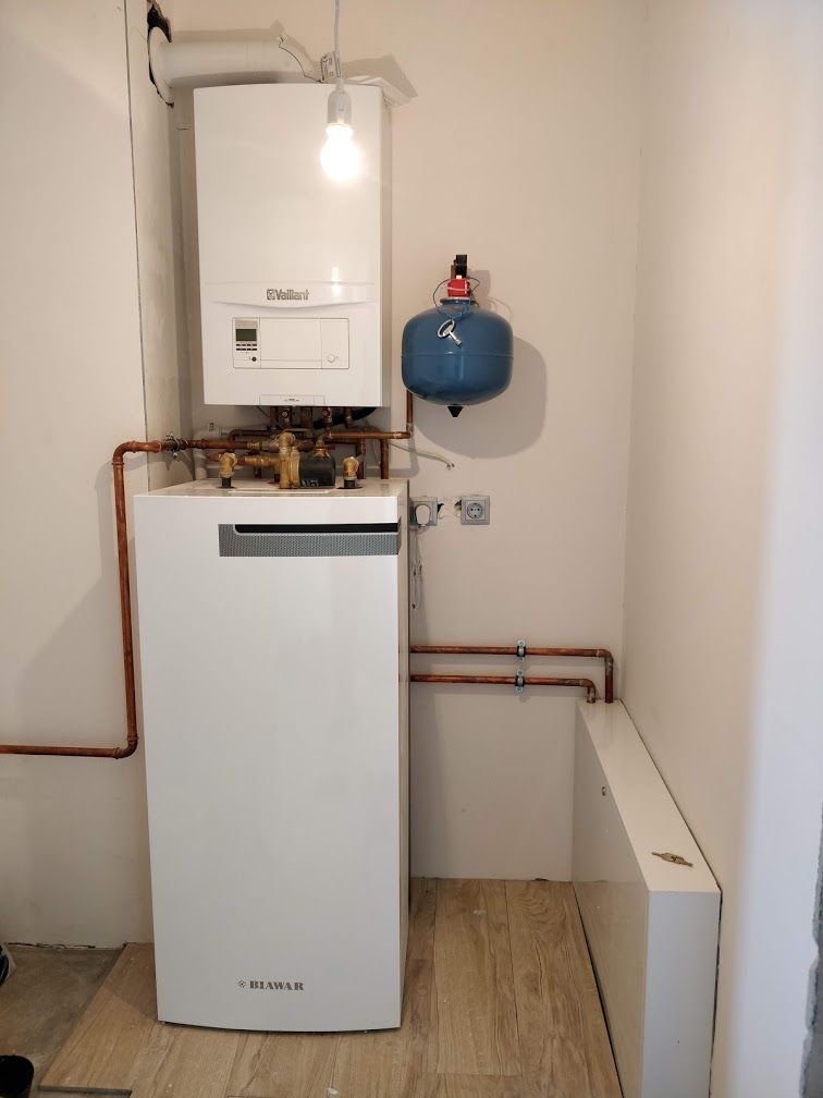

  • #16 18592824
    zales.vip
    Posts: 1179
    Help: 191
    Rate: 585
    So a filter for what you probably do not have. ie inside the boiler there is. But rather, the service technician should "fumble" with him.
  • #17 18593188
    kulfi82
    Posts: 175
    Help: 9
    Rate: 58
    It seems to me that the CO filter is on the left, unfortunately it is not visible in the photo. Today I will take more detailed photos of the entire room and all devices.
    Is there any way to check if the pump is working as it should? It seems to me that this may be a good lead because, for example, in the 28-square-meter living room, when I checked the heating of the floor, it was half-heated, but the further away from the boiler room, the cooler it was.

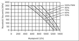

    @ kulfi82
    No mixer is needed for the VC 146 with 100% floor heating.
    It has 12 heating circuits. Assuming a flow of 1.5 l / min it comes out 12x1.5 = 18 l / min x 60min = 1080 l / h
    Assuming a flow of 2.0 l / min it comes out 12x1.5 = 24 l / min x 60min = 1440 l / h
    Therefore, it is to provide what values it has in the codes that I gave earlier. Perhaps you just need to change a few values and there will be a flow.
    The CU22mm pipe is too small at dt7'C, personally, I would give at least 28mm max 35mm and a magnetic filter on the return from the installation is obligatory.

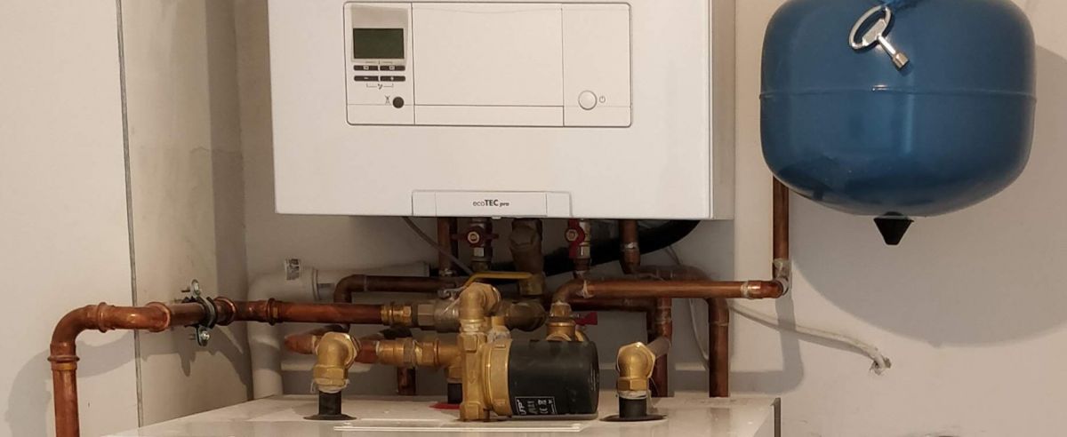

  • #27 18594727
    kulfi82
    Posts: 175
    Help: 9
    Rate: 58
    Ok, I'm after the pictures and I can show you something more. A lot of them came out, so I put them in google photos.
    https://photos.app.goo.gl/m1GyQLDMxs8QgDcL8
    I also left the two shortest loops, the rest twisted. No reaction.
  • #28 18594816
    Wojtermet25
    Level 30  
    Posts: 1061
    Help: 155
    Rate: 228
    Thanks. Colleagues asked for the diameter of the pipes for the manifold.
    The filter I see is in the cabinet, turn off the valves and check if it is clean (of course, turn off the boiler first).
    The bowel is total, as even for two loops it cannot cope.
    We will still wait for the interpretation of the settings, because I do not know this boiler.
    Added after 1 [hours] 33 [minutes]:
    I looked at the manual
    D14 is the pump speed you have on the car, for the test I would give it 5 max
    D18 pump operation mode (this intrigues me the most) you have 3 Eco (5 min every 25 min) it should probably be 1 Comfort (continuous operation)
    D71 too much for a floorstand, 45-50 *
  • #29 18595343
    zales.vip
    Posts: 1179
    Help: 191
    Rate: 585
    I also have this question: was it ever good? Have flows ever been higher?
  • #30 18595432
    kulfi82
    Posts: 175
    Help: 9
    Rate: 58
    Gentlemen, shame and disgrace. I apologize in advance for wasted time. It turned out ... that there were no flows because the boiler was not working or it was working minimally. At home, I am set to 19 degrees and in recent days in Szczecin the temperatures have fluctuated around 20-21. So the weather station was shutting down the boiler and it either did nothing or turned on for a minute two to cut it or something. Since this is the first time I have come into contact with a gas boiler, I did not know exactly how they work. I got a headache that the negative pressure that controls these mushrooms is in them all the time, regardless of whether the boiler is working or not.
    Reflecting on this installation, the light bulb came on and I set the set temperature to 24 degrees. Only then did the boiler start from the hoof and heat up the entire system and the rotameters began to react properly.
    Sorry and thanks for all the advice and commitment.
