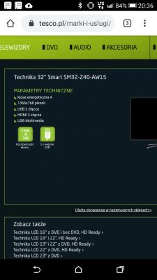

    How many HDMI ports do you have in Technika? What model is it?
  • #6 18623267
    Przemo1983rmi
    Posts: 335
    Rate: 43
    I have 2 HDMI ports in it, the model is: Chromecast 1 Device Not Displaying Image on Technika TV After Switch from Panasonic TV
