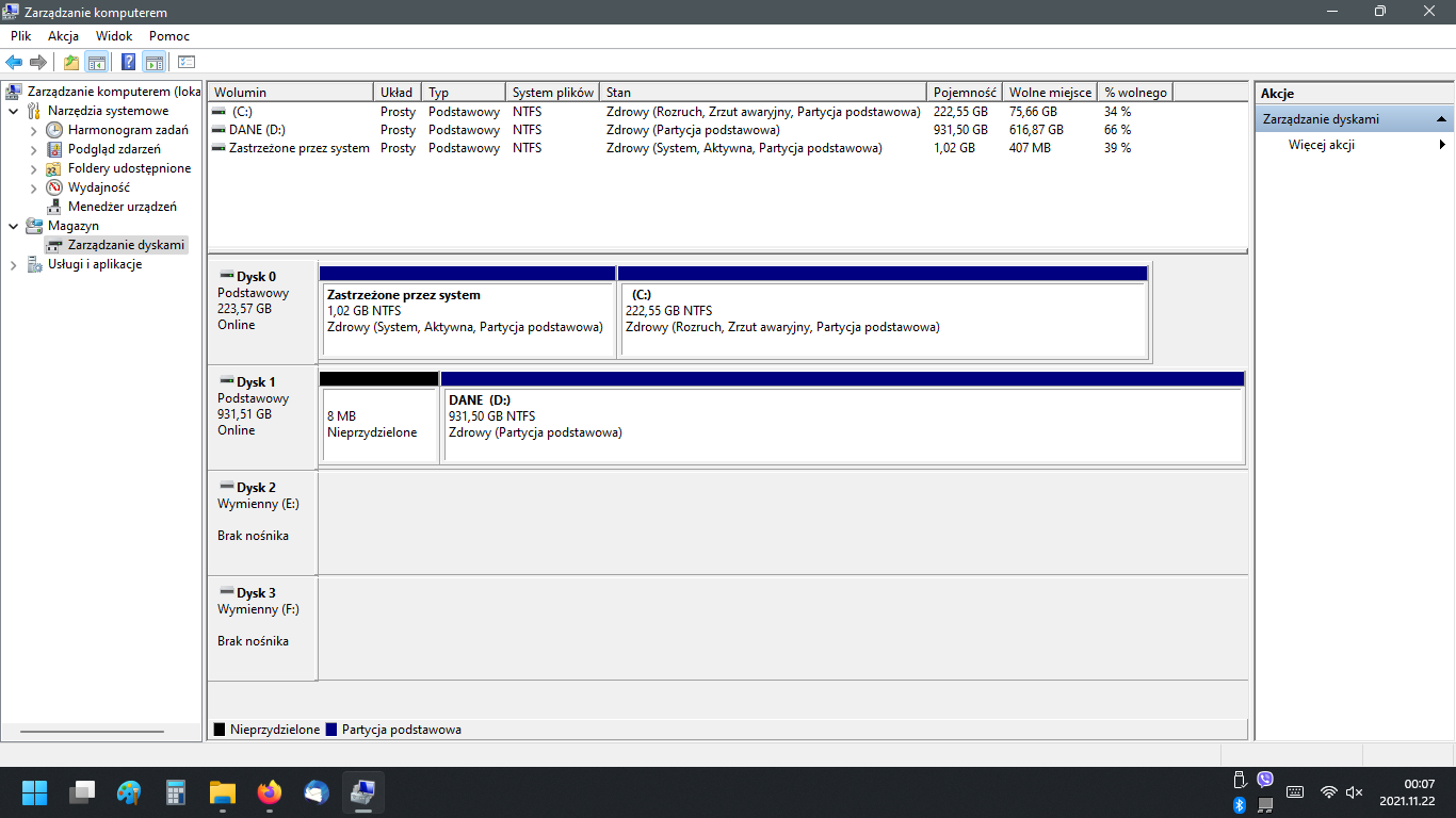

    It's like it would crash during the update anyway, if you are in disk management, select the DATA partition (D :) and see if a red X appears in the top menu, like so, then remove this partition, disconnect the reader and press reset or turn off by holding the POWER button for a long time. Alternatively, unsolder the PLUS wire from the battery (red) so that you know for sure that the reader has turned off. And then connect the cable and run it and check if it did something or the same thing again. The reset button should work if it does not work, it is possible that the software has crashed.

    The D drive as you suggested is my second data drive in my laptop :-)

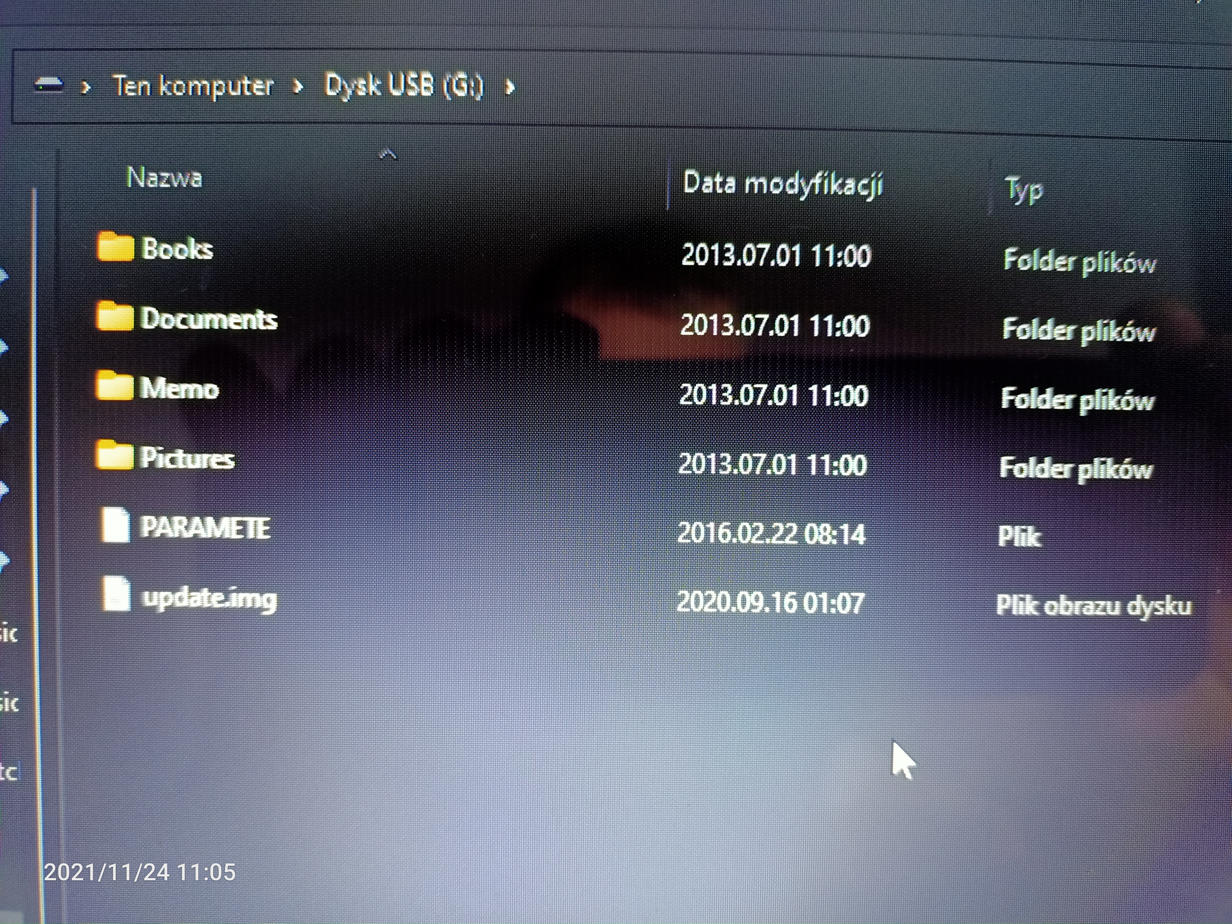

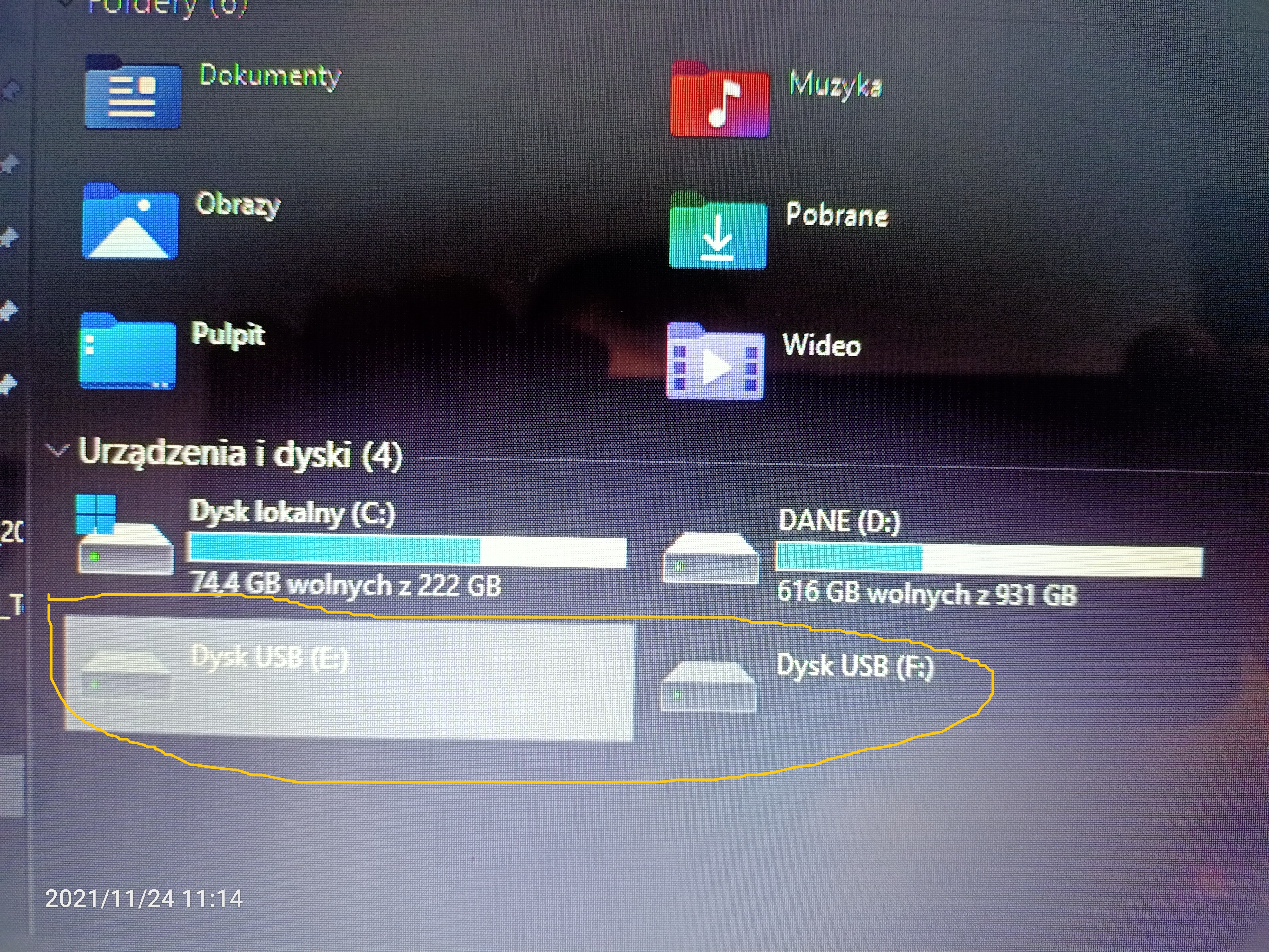

    InkBook Classic Reader Won't Turn On: No Response to Reset, Green LED On - Need AdviceIMG2021112...111425.jpg (5.78 MB)You must be logged in to download this attachment.
    Disks E and F are those from the reader and, as you can see, they cannot be opened.
    But when I took the SD card out of the reader and put it in the computer reader, it turned out that inkBOOK created its own directory structure.
    InkBook Classic Reader Won't Turn On: No Response to Reset, Green LED On - Need AdviceIMG2021112...110548.jpg (6.05 MB)You must be logged in to download this attachment.

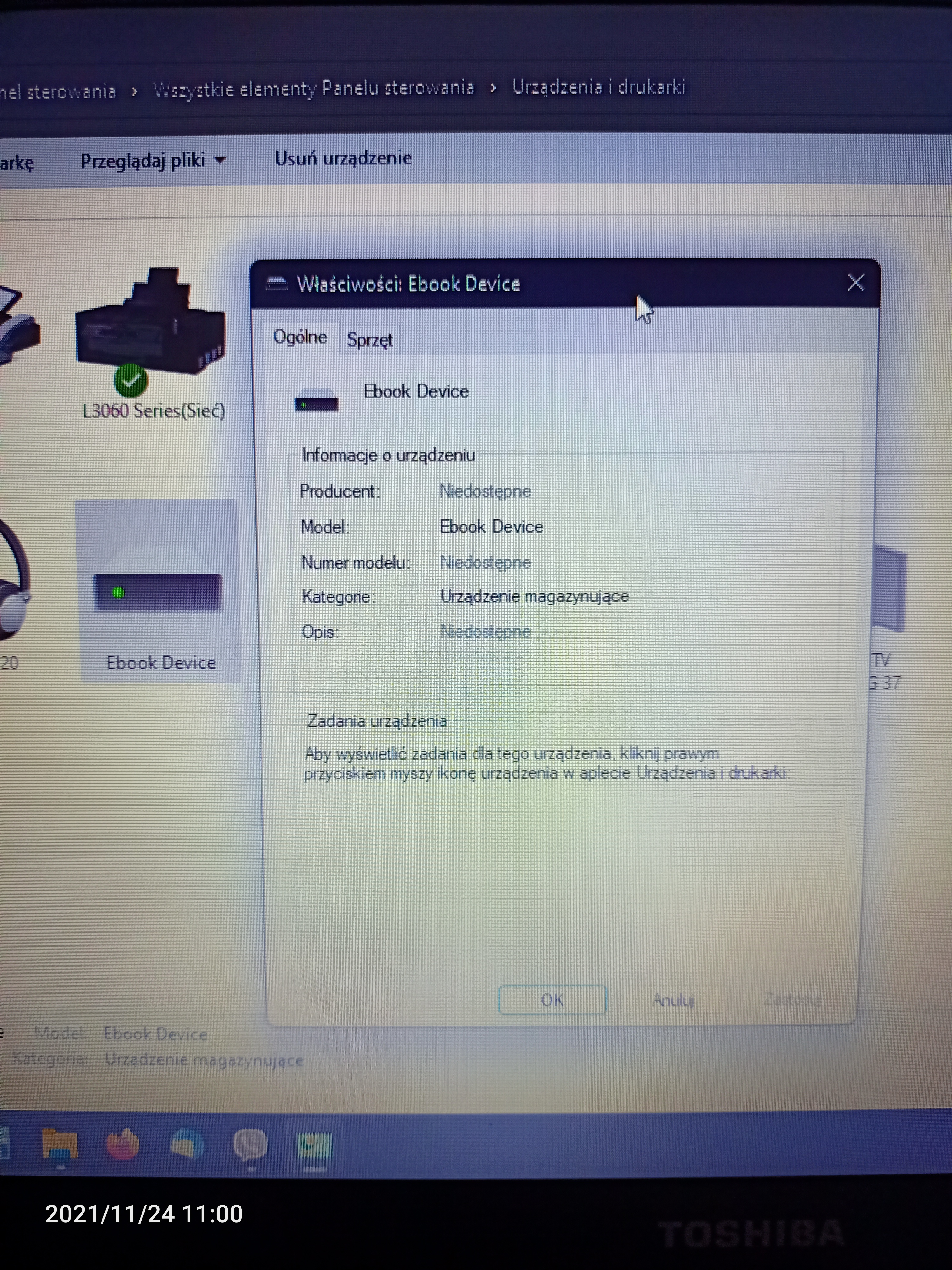

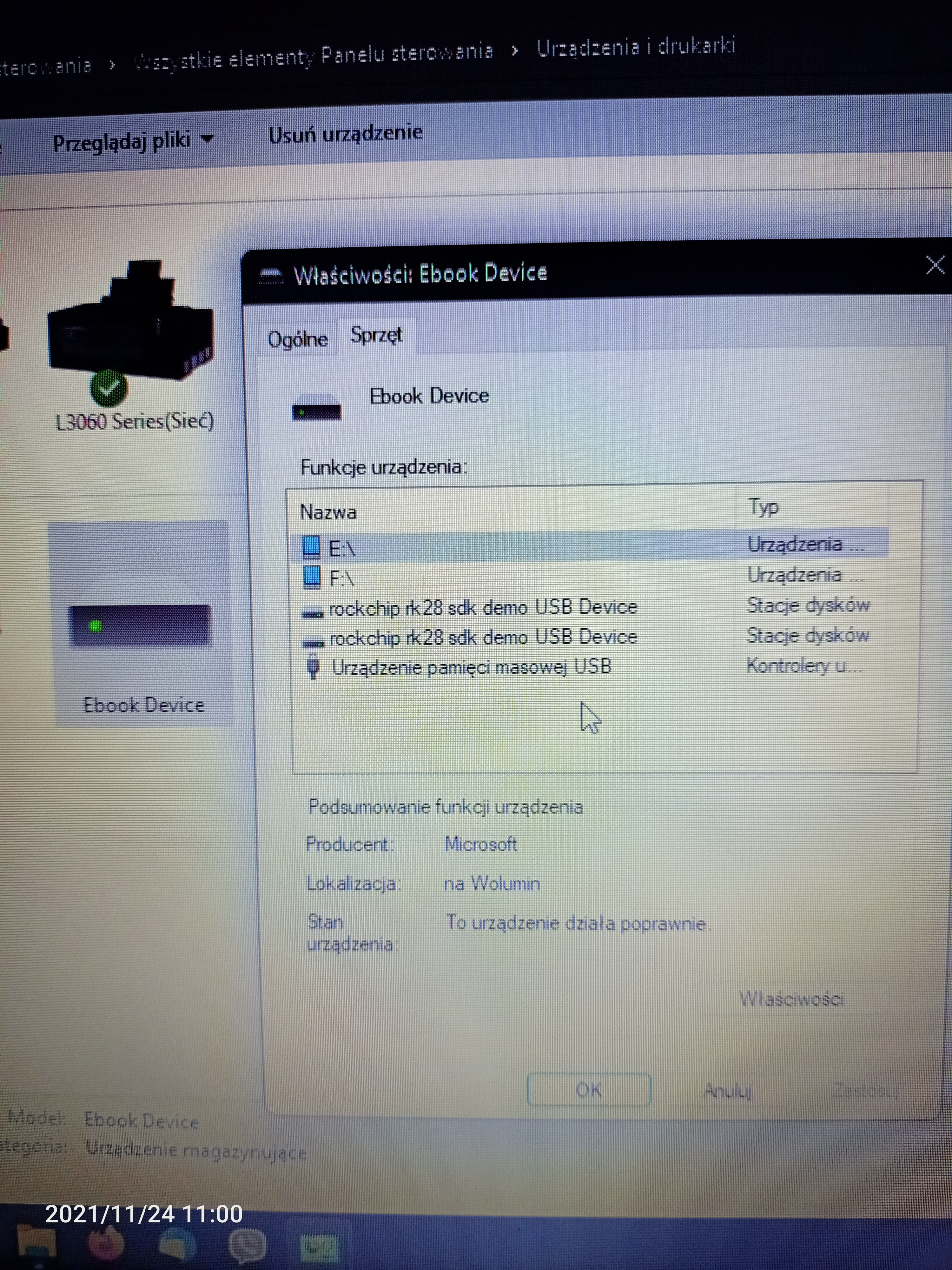

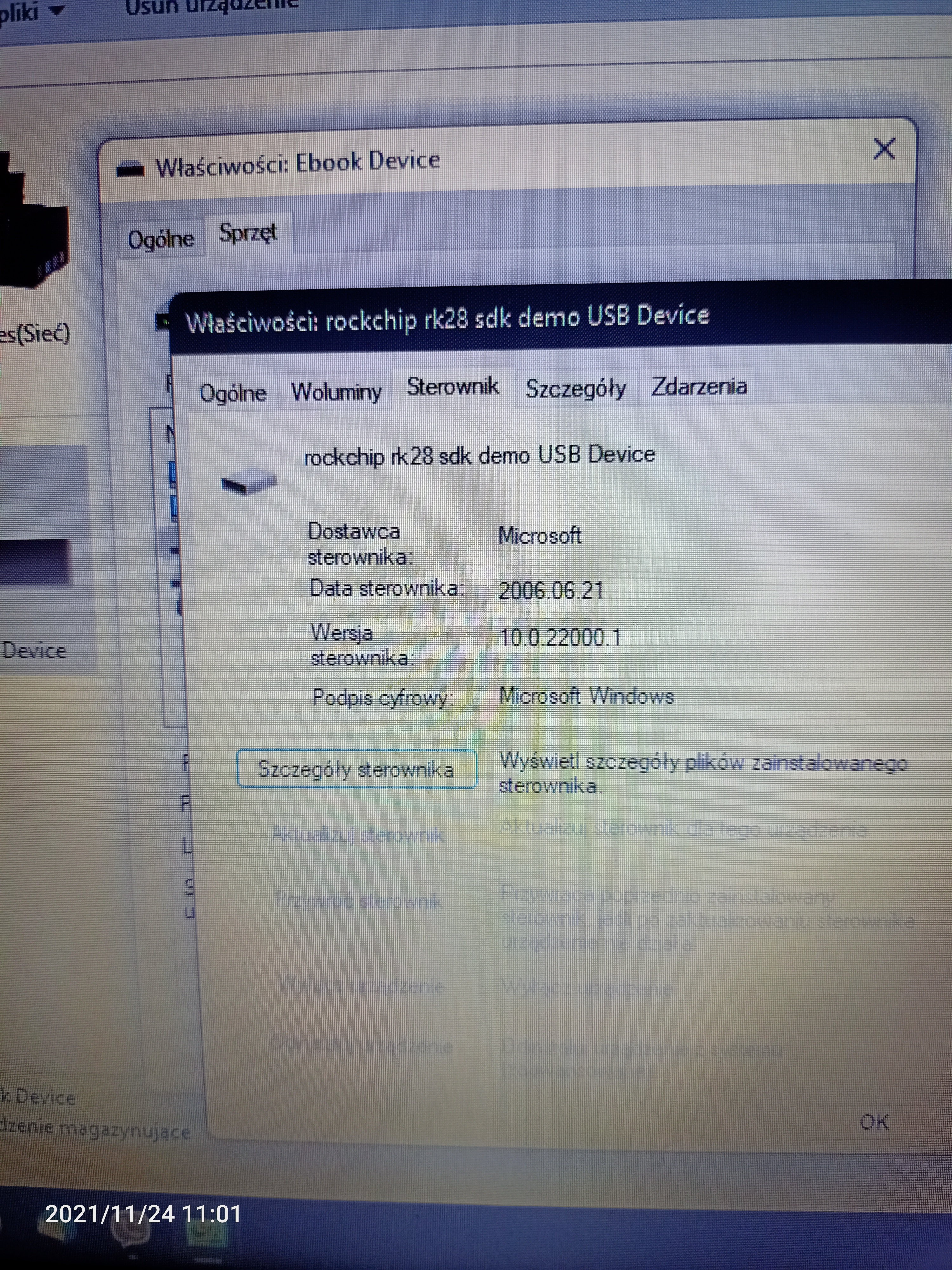

    It looks like the display has gone down.
    And the computer was not properly detecting the USB device.
    InkBook Classic Reader Won't Turn On: No Response to Reset, Green LED On - Need AdviceIMG2021112...110048.jpg (5.06 MB)You must be logged in to download this attachment.
    InkBook Classic Reader Won't Turn On: No Response to Reset, Green LED On - Need AdviceIMG2021112...110058.jpg (5.41 MB)You must be logged in to download this attachment.
    InkBook Classic Reader Won't Turn On: No Response to Reset, Green LED On - Need AdviceIMG2021112...110119.jpg (5.75 MB)You must be logged in to download this attachment.
